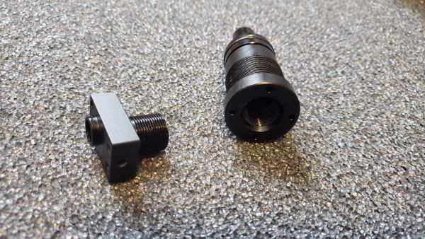

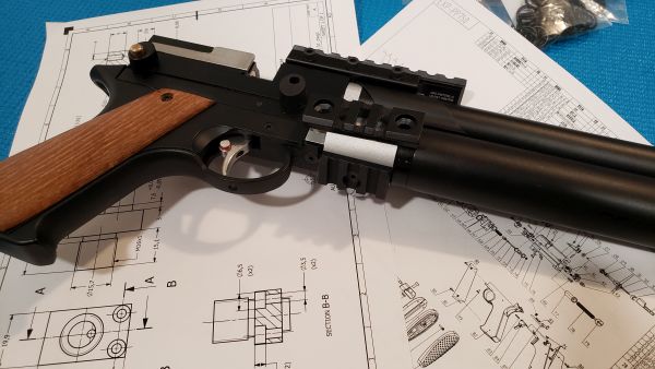

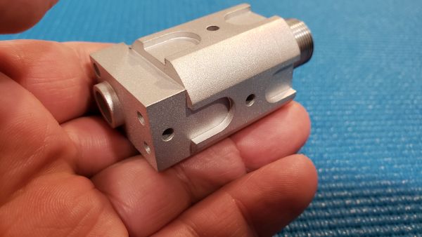

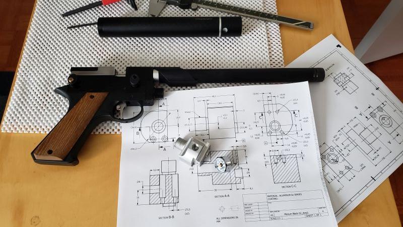

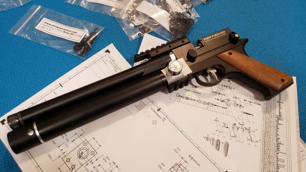

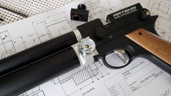

The pistol is in parts now (deburring, polishing internals) and I am designing a new plenum block, not a simple machining it will be a two side operation so need to make a jig as well.
My best guess to
- extend the block from 10 mm to 25 mm thickness (so the plenum would be 15mm longer) and,
- incorporate a reg gauge as well, also,

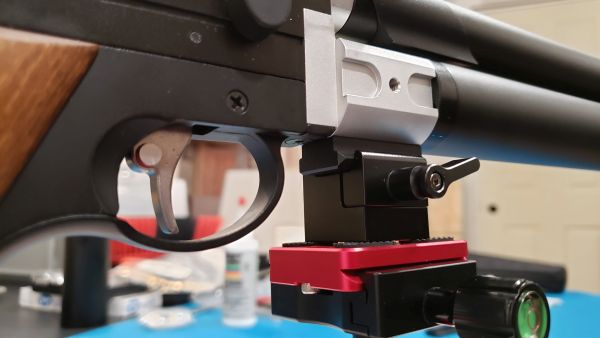

- it would be nice to have a picatinny or arca mounting hole from underneath as well, I still need to research for a shortest possible rail.
I have no machines (lathe or mill) I will ask my old friend for a favour.
Anybody made something similar and want to share the costs I am interested to get a larger plenum anyhow.

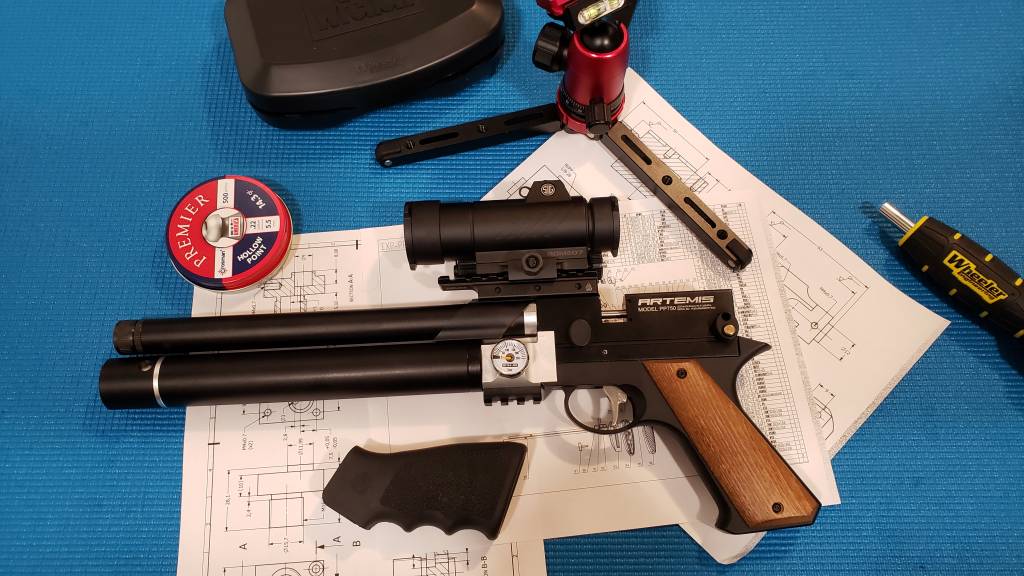

No testing further until I finish all the modifications/debugging I had in my mind. I can say only I need to change the barrel to a longer one.
I polished the original regulator bevel washers no need to spend extra bucks for Huma, also minimized the friction between all moving parts, for now looks promising.
Waiting for my orders, need more .22 pellets and orings from oringsandmore (in the mail) and then I shall experiment with the hammer weight, right now it is way to heavy and makes a sound like "bumphf" instead of "thing", probably bouncing/rattling on a replaced weaker spring, maybe that will stop ones I pressurize the chamber.
