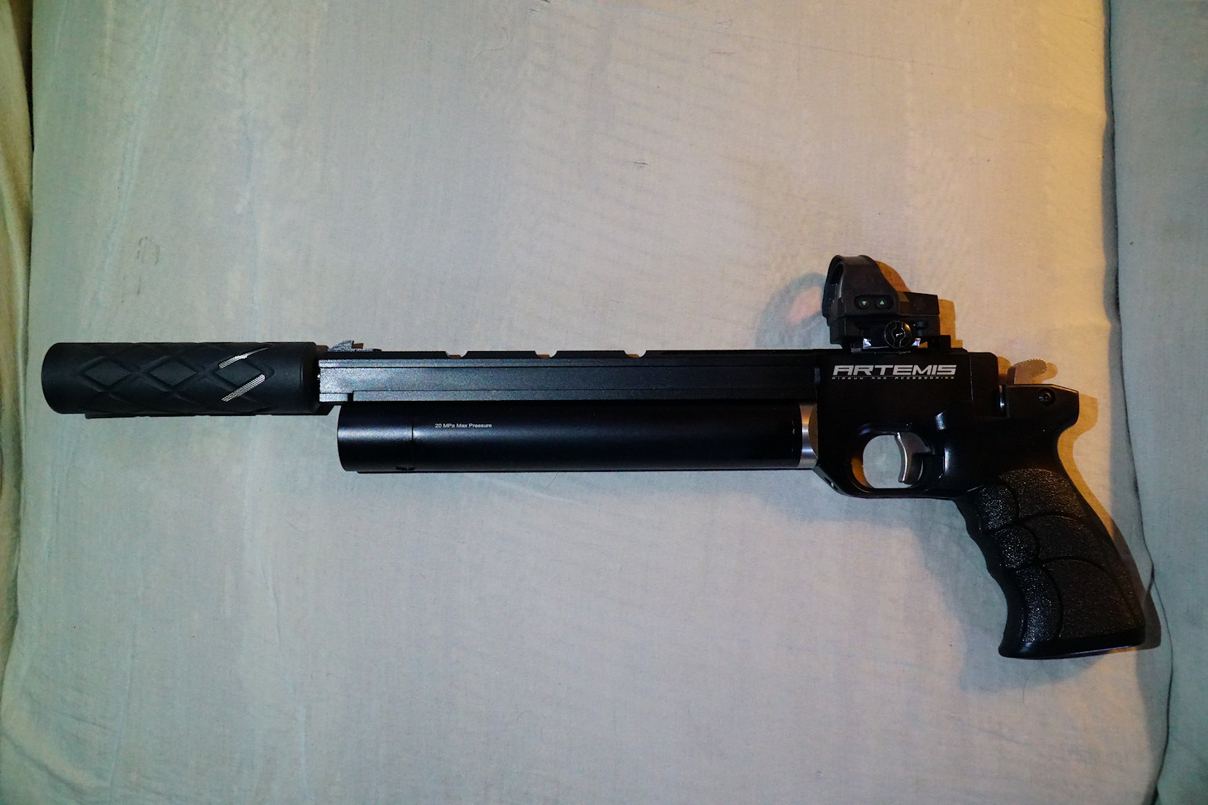

I have it in 22 cal. my moderator is a Huggett-BELITA 25 cal. I also had Wes send me the stock baffles from Cal. for around $16. I did a test with them, loud and point of impact was way off and would not group at 32 yds. So I took them out and stuck with the Belita 25 cal. My gun averages in the middle 700's here's what it looks like. Forgot to add that I have the gauge block added so I needed to add a 3/16 thick nylon washer behind the moderator so it would fit.
Nice looking pistol Mike. At this rate you all are going to shame me into putting pretty grips or something on mine to doll it up. I mean I have to do something with the money I saved on my $20 moderator, right?

That's the factory grip.
I did put a couple of pieces of grip tape (black) on the right side and back though. One, because the grip is hard plastic, and any hint of any sort of sweat, (100°+ summers) makes the grip a little slippery. And two, even though the tape is only about .04" or .05" thick, it helps fill out the width of the grip a little.
Mike

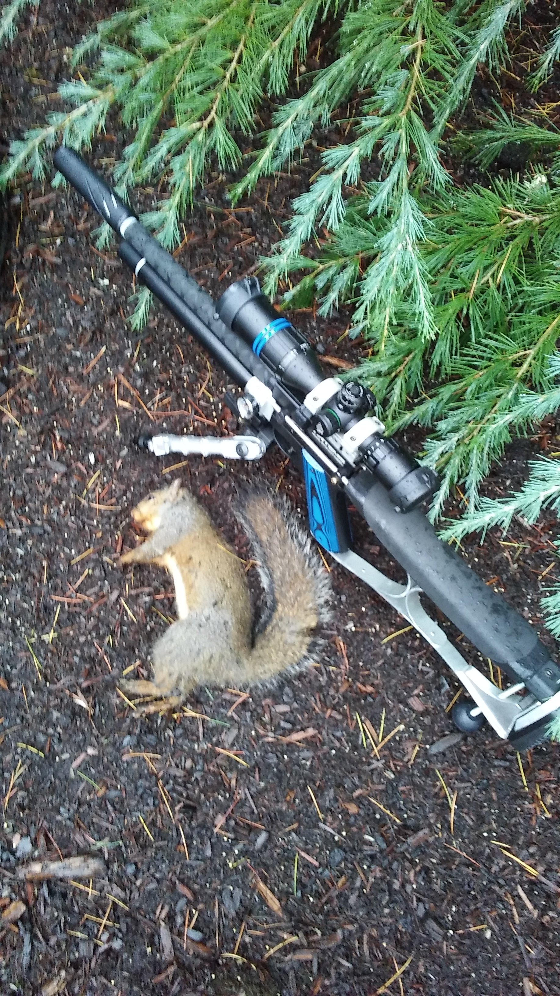

I bought my 750 from wes with an adapter. I tried the baffles with poor results so I have a printed mod from a guy that doesnt make them anymore. I think a guy named froggy still sells nice inexpensive mods. I also have used a dfl sumo because that's what I had. Worked and looked good. The plenum/gauge block is worthwhile if you can get one.
