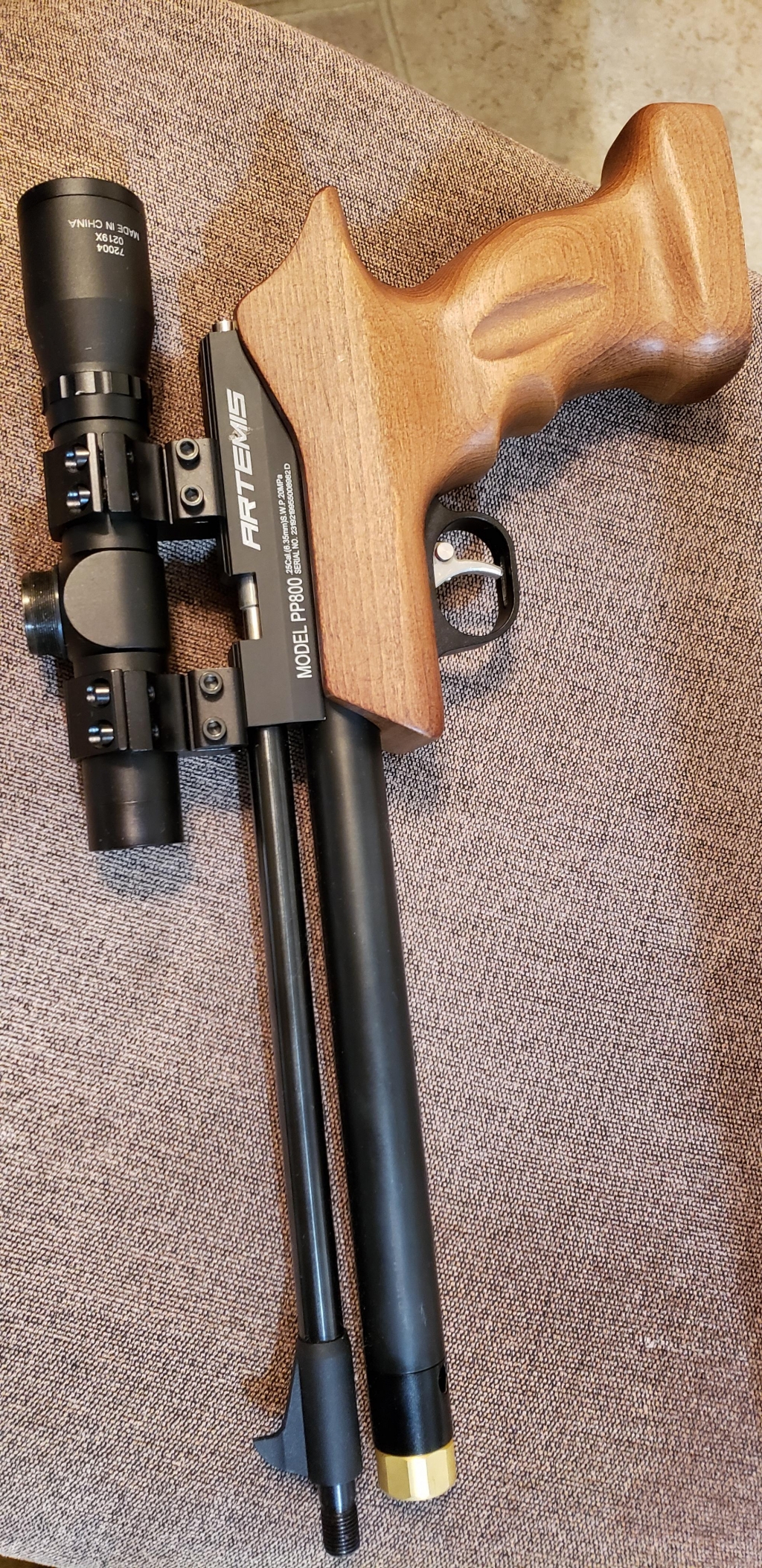

Artemis/SPA PP800 in .25
A few weeks ago I ordered from Wes at airgunarcheryfun.ca this pistol. It is tuned for Canada, so I will see what can be done eventually, after I finally finish my wife's crosman.😉
I like how it looks.
Easy to pump by hand.
Definitely louder than the amped 2240.
Grip is for large hands.
The bolt is smooth and trigger feels fine. But don't forget I am new, only a few triggers in my time.
Loading jsb exact king heavy diabolo ii in 33g, the bolt is not happy. Have to force it closed. Benjamin's are fine. So some porting is a must for heavier pellets.
Have not cleaned the barrel or oiled or polished yet, just played. With red Dot, at 20 ft (my inside living/dining range) I think it does pretty good.
My cheap paintball Chrono does show a wide range tho.

I have no idea how accurate the box is. The fps is the only number to count on. The Jules is based on drop down selection weight. Not the weight of the Benjamin's.
Even tho Wes had mentioned this gun on the forum, not sure if he made clear how rare it is.
The .177 and .22 are magazines and are every where including Diana. The .25 is not Diana, is single shot and not easily found on Google.
Hope this has been interesting enough. Thanks.
I have one as well I ordered from him. Only ever heard of one other person owning one.
Mine has 5.1mm ports throughout. I think I maybe should have gone a bit smaller. Added 2.5mm valve stroke. (valve body appeared to be longer, effectively limiting hammers ability to open the valve) gun was definitely detuned for Canada. Can get 8 shots in the same hole @ 30 yards. The gun prefers jsb 25gr by a large margin. 22-26fpe

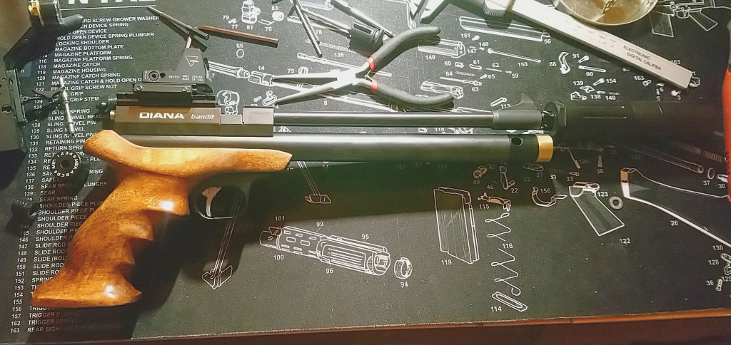

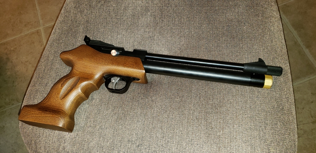

I actually chucked the valve stem with the seal on it, spun and cut the seal back a little, so it would seat deeper. Creating a hair more valve stem protrusion. I also reduced the length of the valve body on the hammer side. Have to be careful because this end sits in a notch under pressure. Mess thing up there, and the body won't seat in the tube in alignment with the transfer port. I have a bandit I've tuned, but have not really modified. Both in pieces, side by side, the severely limited valve travel on the pp800 was very apparent.
Hatsan seems to have their ports on point. I have a sortie in 22 caliber, and the consistency across a 100bar pressure drop is shocking. I have no idea what port size they use on their 25 caliber pistols, however, but I would use the same size if I knew. Of course vlave and hammer tuning affect consistency as well. So, even with the "right" port size, there are other factors.
I had wondered if the bandit valve body would be a better choice. It seems the alignment would be the same. But I can't confirm 100%. I am 95% certain it would work. FYI the 25 and my .177 bandit have the same size ports. 3.5mm IIRC
The valve is the original. But the valve seal has been cut back. And the back side of the valve body where the hammer hits is shorter now, so the valve stem is exposed a bit more. If you take the valve apart, you might see what I mean. the hammer hits the stem to crack the valve. The seal is on the other end of the stem. If the seal is cut back, it changes, the point on the stem at which the valve seats. So, that would extend the amount of valve stem poking out of the back of the valve body (where the hammer strikes) Increasing valve travel when hit by the hammer.
As for the valve seal, I just put it in a drill (you aren't supposed to do this, haha, but if it works.....) Used a file and finished it off with a few different sand papers, then polishing compound. Gota be careful, though. If you use a drill chuck, you can get some pretty bad runout very easily. I just eyeballed it, and measured/rotated it in the chuck periodically. That was to move the seating point of the seal further back on the valve stem.
The only real differences in the guns is the hammer spring, I think. Though it may share the .22 one. I do know it's not the same as my .177.
As for the grip, patience, and a paddle wheel will make short work of the initial rough griding. Just have to be sure not to over-do it. The rest I did with stone and sanding dremel bits/hand sanding as well.
My bandit had a newer style grip. But was seemingly equally as bad as far as dimensions go. The angle towards the air tube is the opposite of yours.
I ordered the pp800 with they synthetic detachable stock.
1577147633_12531628835e015cf1105879.20948801_71592770_1707717596024895_4798677336738234368_n.jpg
1577147777_16061709575e015d8127eaa3.80578327_74477098_10157548392984034_1319409439320571904_n.jpg
