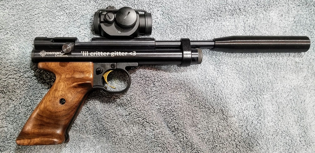

The pistol below is wearing Vernon Austin ambidextrous grips. I have a similar pair on my 1701P. The furniture on the carbine in the background came from a German maker on eBay. The forearm isn’t bad but the grips aren’t all that great so I’m not recommending them.

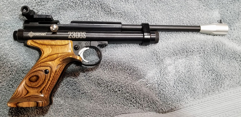

Link below has my two 2300 in Corcoran grips. Same frame as 2240. Love them. Haven’t tried Austin grips yet but supposed to be excellent. If you can shoot a notch rear site I’d go with the Williams if you can find it. Notice on my 2300S I’m using a peep. Old eyes won’t handle a rear notch.
Beautiful work @cjtamu !
Love the 'lil critter gitter <3
Guns and photos by @cjtamu
Reactions: rcarlisle
Thank you. The lil critter gitter is a Crosman Custom Shop gun. Hopefully they open it up again someday. Best thing you can do to a 2240 is work over the trigger. Even with adjustable trigger the sear still needs some deburring and polishing. The stock trigger can be made very serviceable. There’s a thread on here from nervoustrig, I’ll look for it. The stock Crosman barrels are very good. You could look for a Lothar Walther barrel but most of us will never notice the difference. Longer barrel will give you a little more power but may get fewer shots depending on where you set the hammer spring. That’s the other thing with a 2240, it’s a gas hog. My power adjuster is 7 turns out and still getting same FPS as before, but more shots per cartridge. Barrel length depends on how you’re going to configure. I like the stock length for a pistol.
