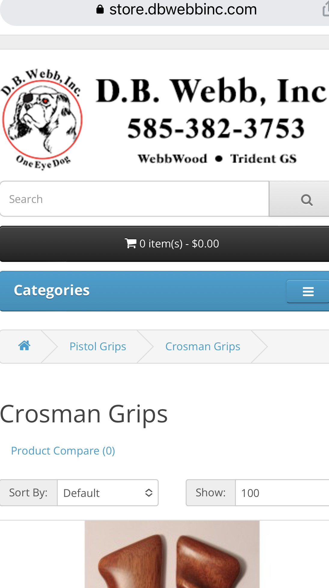

I have a pair of D.B. Webb grips. There’s nothing wrong with their grips.
