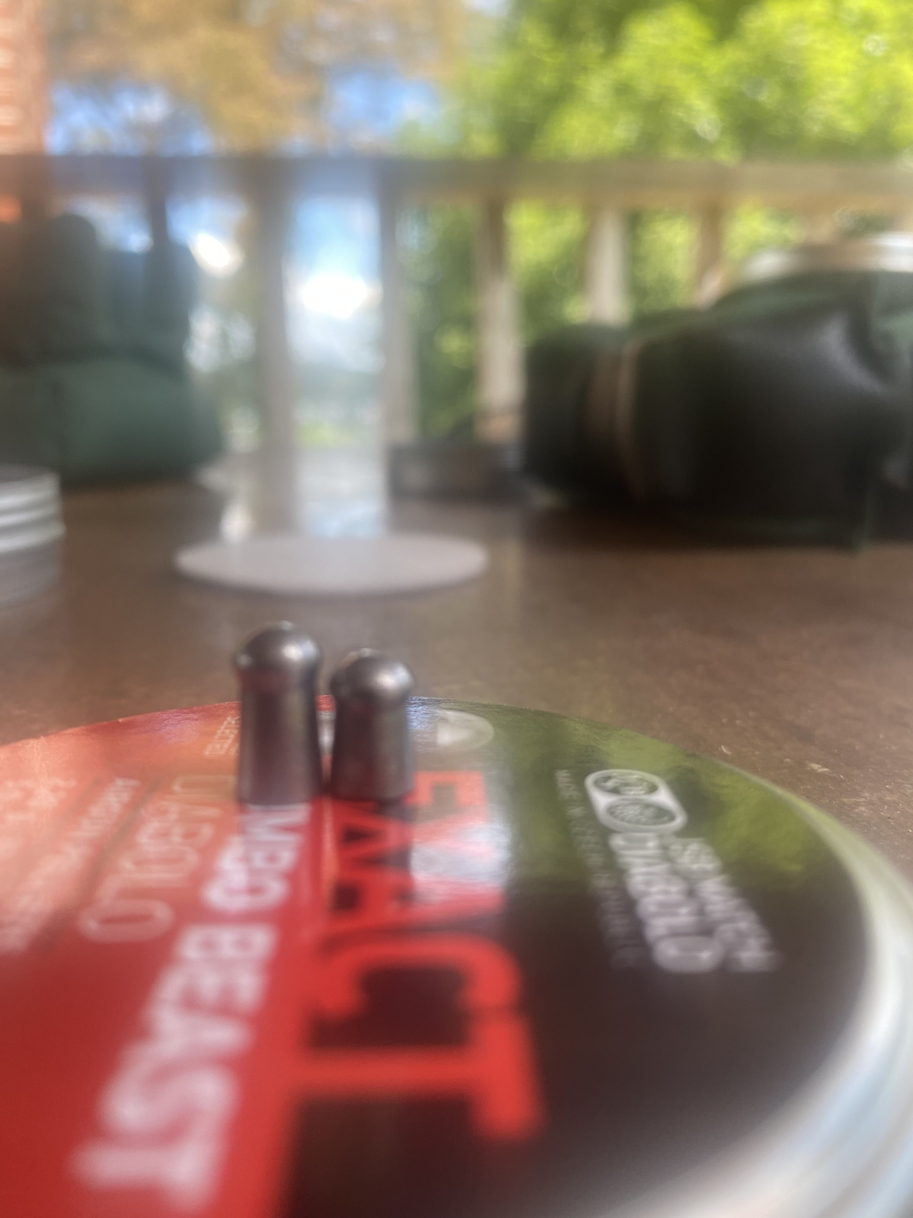

I have recently started using the 34g beast and are impressed by them, I don’t shoot over 100yds so I sold all my impact slug shooters, and went back to just shooting pellets, the slug craze is getting stupid crazy, my current setup is shooting the beast @ 965fps, that’s like 70fpe from a .22 pellet, so all you slug crazed people out there please tell me why my pellet is not as good as your slug? Yes I know slugs do better past 100yds, change my mind why a slug would be superior for shooting under 100yds, and my current pellet setup is lights out accurate the pic is the difference in height from the monster re-design and the beast
