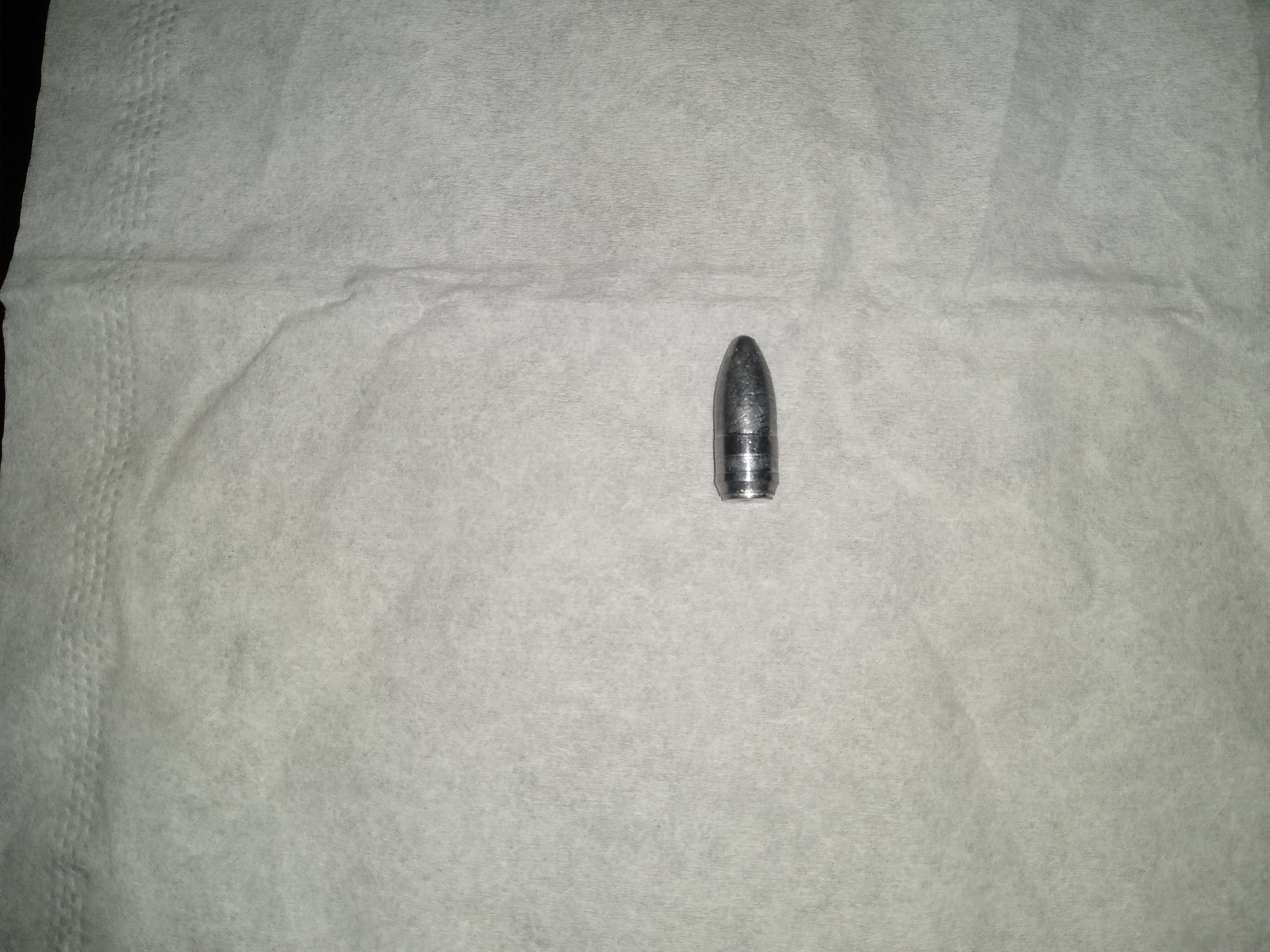

That would be a near perfect weight for a 25 cal of that design. I'd like a 308 cal to be over 100 grains. But, how about this one in 135 grain. My Cothran makes 185fpe with it. I know, it's a slug.

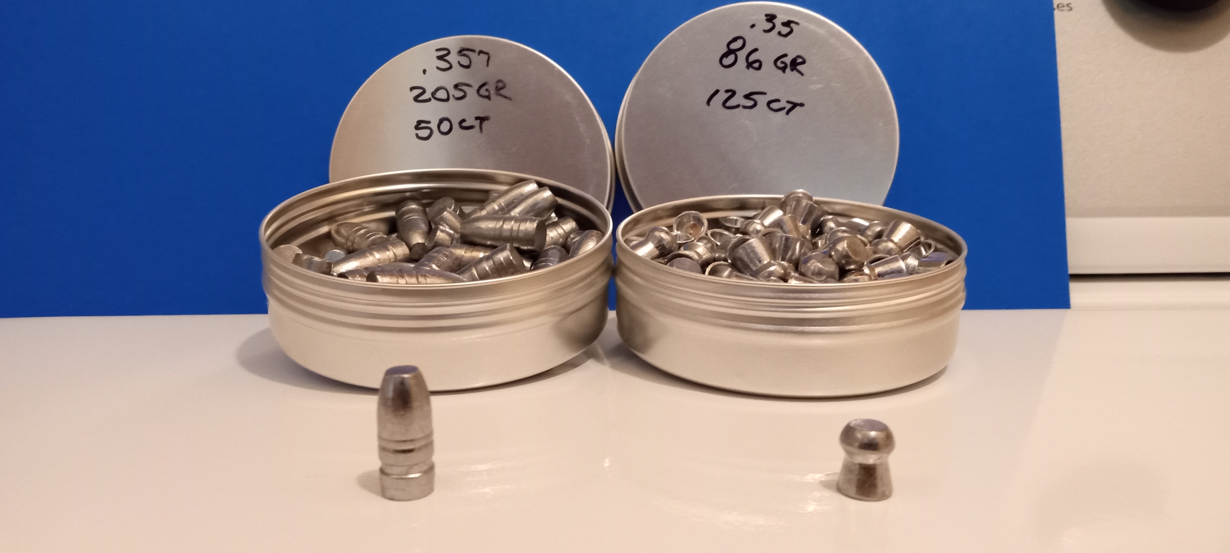

I think the main thing .pellets are best shot with speed up to 920 fps may be a bit faster. Anything more it become unstable and the range is shorter because of the aerodynamics or bc, A slug can be shot speeds well above the 920 fps and the range is farther and the bc is better for the longer range. Thats the best i can do,lol here is a pic of both, skirted= drag like a birdie in badminton, and a slug.
