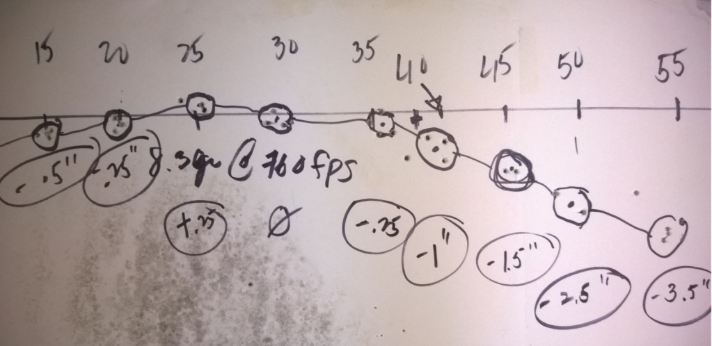

Been noticing changes in range finding esp in hot weather. Never really occurred to me that there is such a phenomenon until I read an article in hardairmag a few months back. When the gun would suddenly shoot high or low, my initial reaction was to blame the gun or the scope not holding true. Temperature was the least of my suspect.
Decided to wake up early one day when the temp was in the low 60s and the day would heat up to high 90s. I'm lucky to have targets in 5 yard increments to 55 yards.
I think I marked my scope wheel back last fall when it was colder (not sure at what temp though). Started to range find the 55 yard mark before the sun was fully out with temp at the low 60s. It was spot on. I then continued to range find as the day got warmer. At bet 68 and 70F, the shift occurred. The scope shifted about 5 yards more. The 55 yard was now focusing sharp at about 60 yards. It stayed this way to the high 90s.

My game plan now is first get a digital thermometer. Then observe at exactly temps the shift would occur with the digital reading. Will there be one or 2 shift points ? Then verify if I have to make a different holdover cheat sheet for the different shift points. Plan on shooting a pellet drop profile at 5 yard increments.
Does it sound like a sensible game plan ?

Thanks for all the reply. Looks like more testing next time I'm back in the man cave. BTW, I have my Tac Vector 10-40 scope mounted on a 12 fpe springer HW97. Will also test for pellet speed at the same time I check for shifts at different temps. Will report back. Understanding the quirks of your scope and air gun is a lot harder than figuring out the wifey.

Your best bet for mapping your scopes temp shift will be to use it on a pcp for testing, if you HF ave one. I say this because your HW is going to shoot faster or slower depending on temp as well and you don't want to confuse the two.
