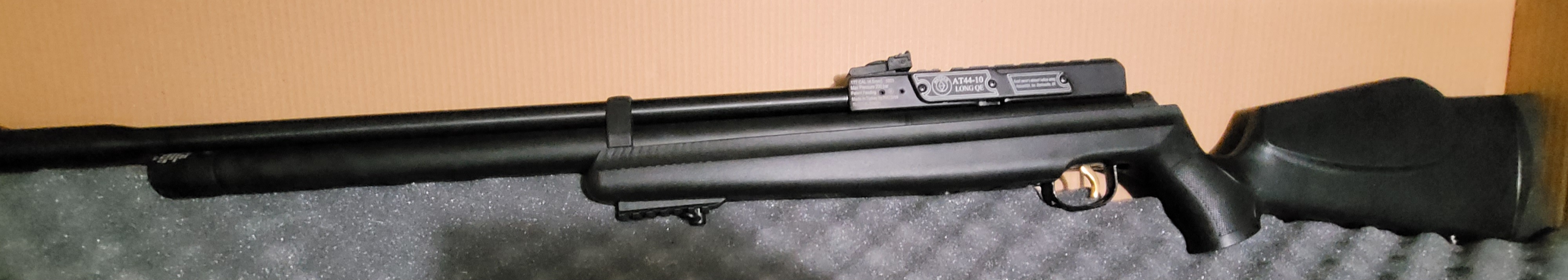

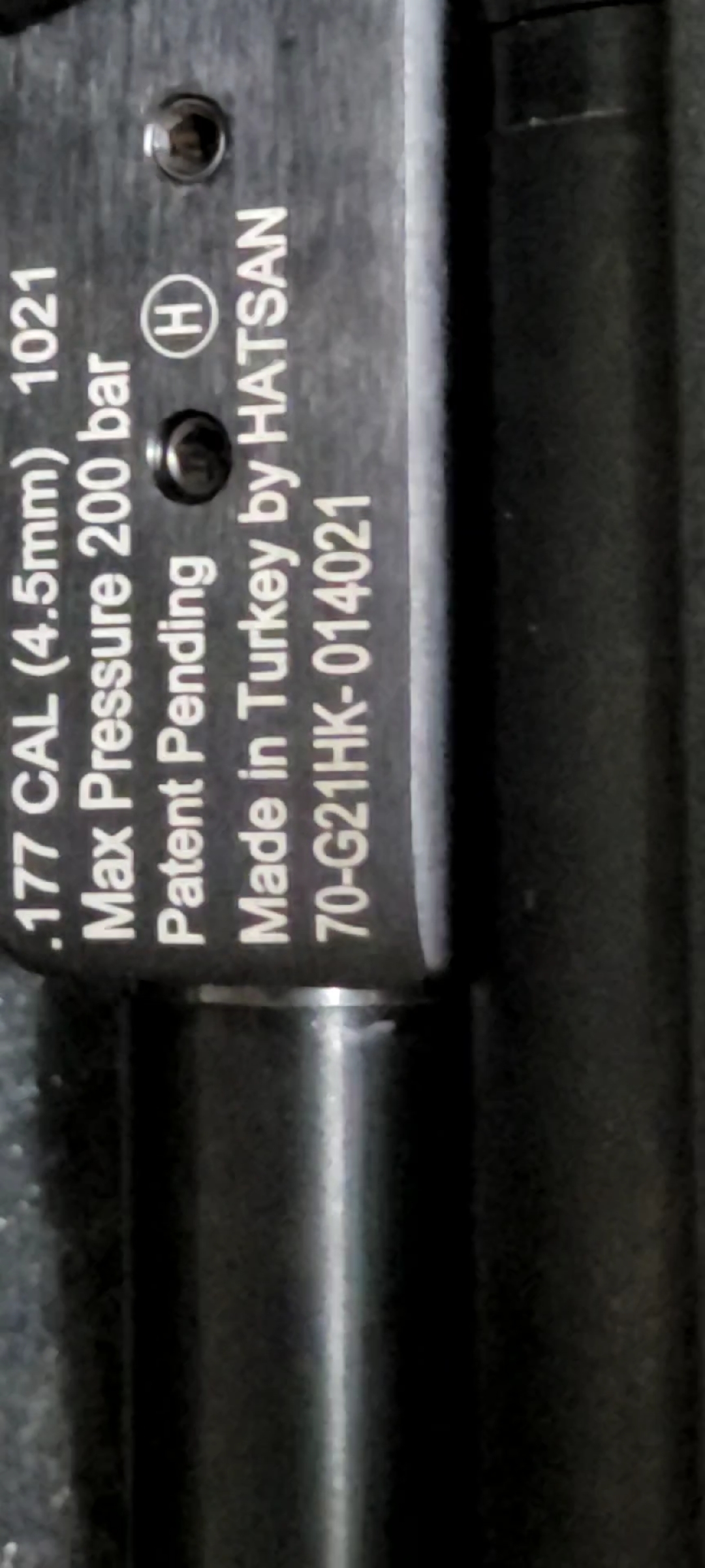

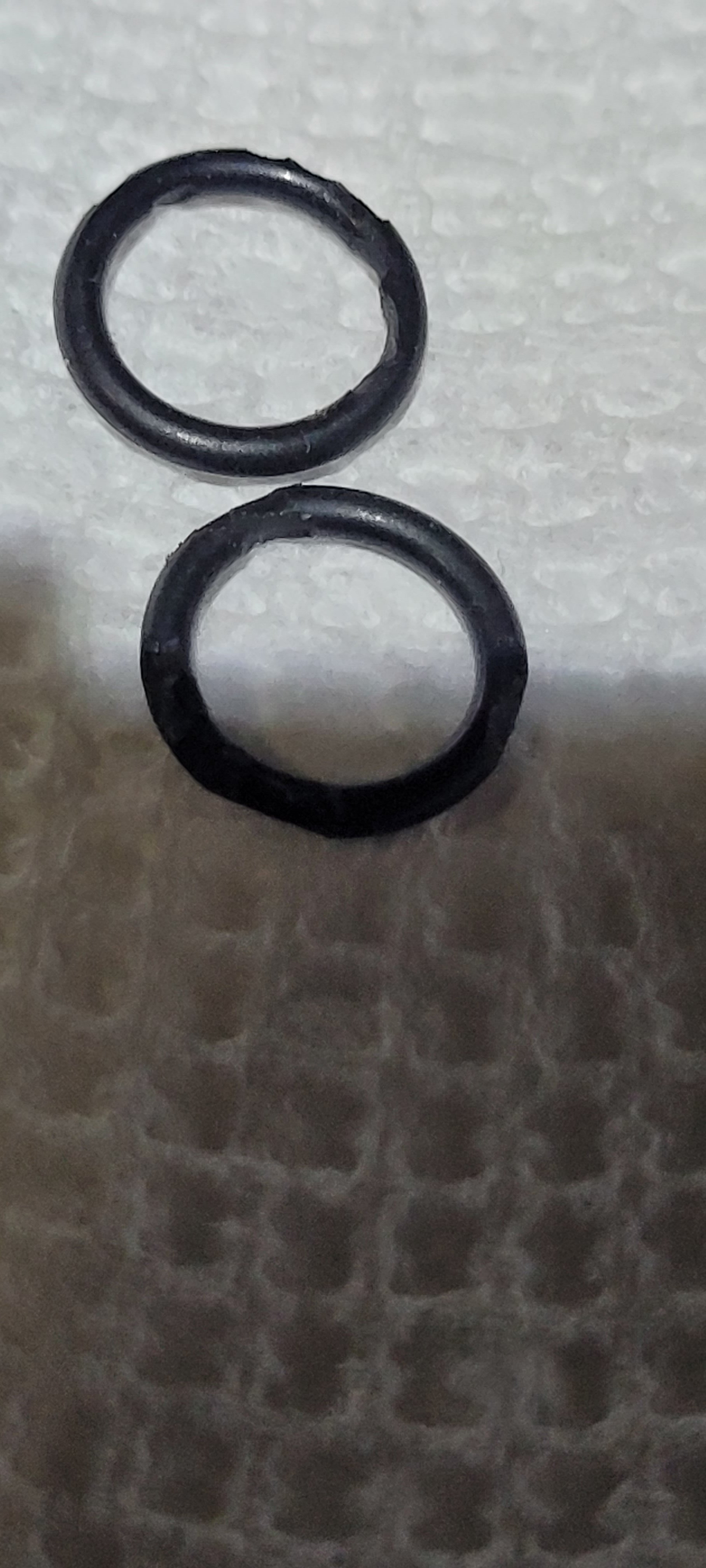

Well after reading some posts I determined that my gun was built in October 2021 then shipped to the US where it sat for 3years, and I also found I should check the two seals on the barrel that sit on each side of the air port and sure enough they were in horrible condition. There's no way this gun would have worked properly had I not found this. The problem seems to be that where the barrel goes into the receiver is sharp and has sliced the edges of the seals. So now I have to try and see if that is the only seals with issues or have the others developed dryrot. Anybody familiar with how many seals there are for the at44 long.177 I'm familiar with the breech seal and looking at it without taking the cap off the barrel to inspect just looking in the barrel at it and it seems intact.
Any help and guidance would be greatly appreciated. Thanks

Emery cloth on those burrs.

I've got the burr smooth on the receiver and on the cylinder fill port as well. Can't find a schematic that actually gives the sizes that are needed throughout the gun.
