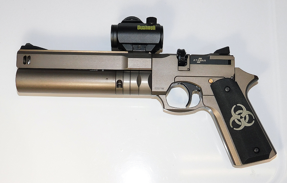

Hi , I've an Ataman AP16 pistol , which is by far the best air pistol I get. I like the "1911" look and I want to keep it like that . Anyway I need to put something to shoot accurately at 30/ 40 yards, without destroying its look ; so I don't want a scope , rather a small Red Dot system , like Vortex Or Doc Star . the problem is almost all Red Dot are fitted with Picatinny rail , an the Ataman is 11mm rail ; moreover I don't want , if possible , an adapter.
One Red Dot fitted in 11mm is the Diana , as you can see on the pic below ; it's not too big but for me a smaller one would be better, without this "scope look". Anyway I get some results with it , shooting a 5 shots group at 30 yards , JSB RS 13.4 gr. Red dot in itself is too large to be really accurate but , well ...that was not too bad .

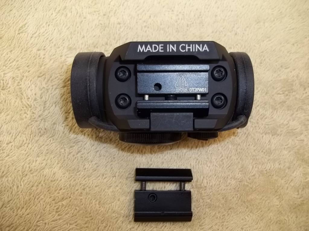

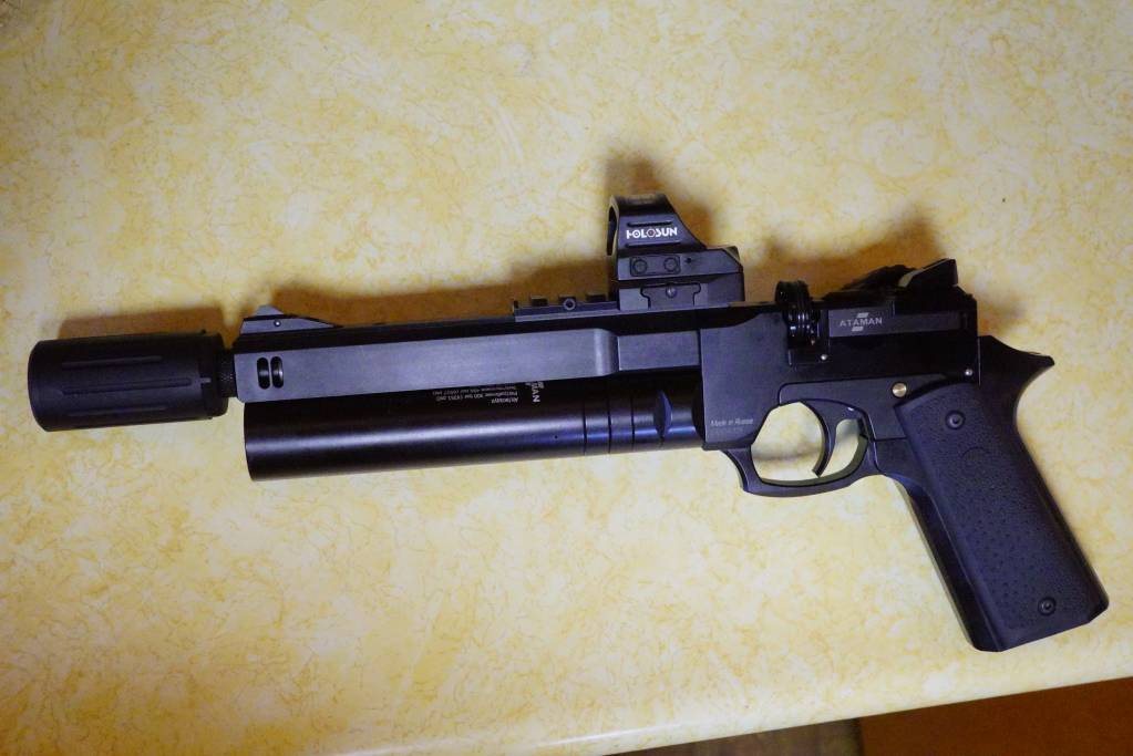

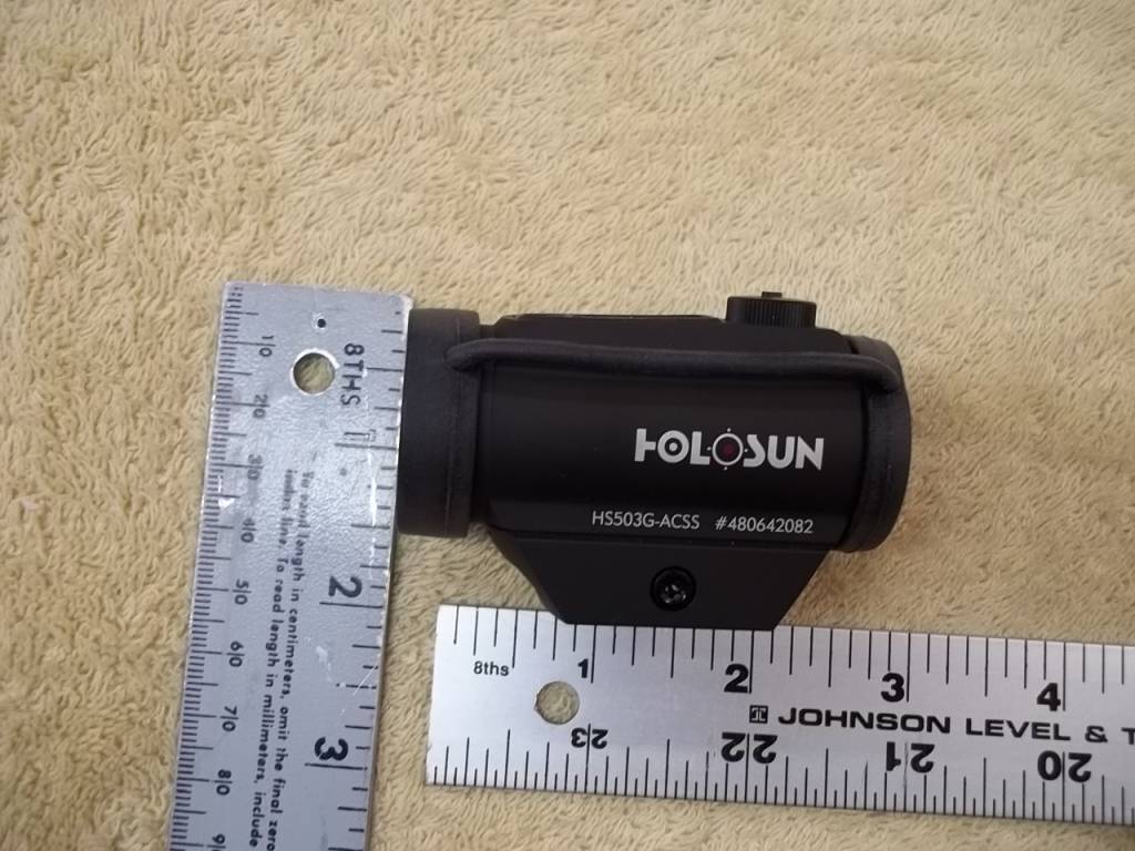

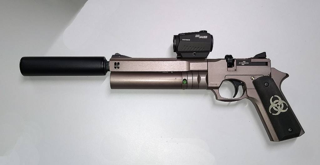

This maybe along the lines of what your looking for. Compact dot and adapter works great. This is a Holosun red dot with a UTG adapter installed in the base. below is the adapter. This is off my AP16 that will be reinstalled on the pistol after I find what pellets shoot best, Presently have scope and bipod installed for pellet testing.

One nice thing about the Holosun. They (most of'em) have a 2mm dot, OR a 65mm circle, OR a combination of both, just an adjustment away. Many like the circle + the dot. It make for faster target acquisition. After you get used to the sight, you can switch to the dot only if you like. They have very crisp, round dots also, not fuzzy footballs like may cheaper sights. Even for those that wear glasses as I do.

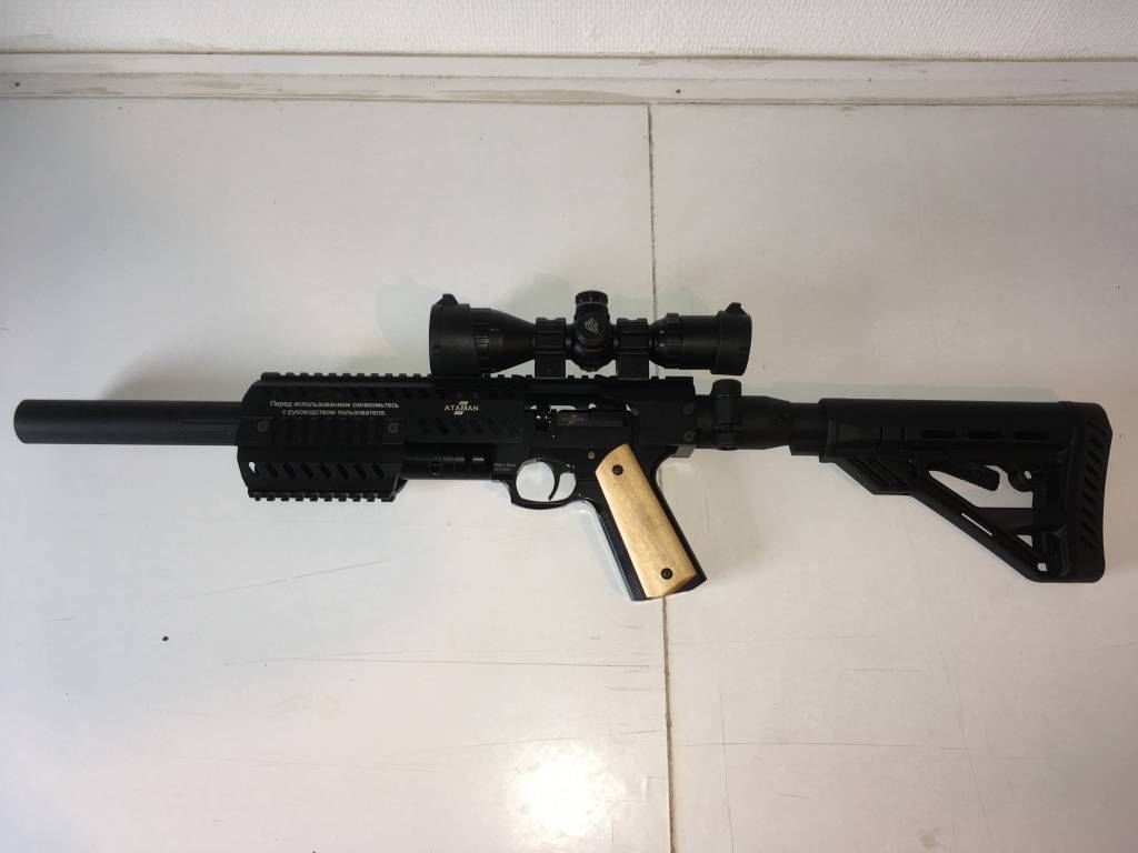

A year ago I bought a shoulder stock for my AP16 . It was neatly built in anodized aluminium , easy to install and fited with a UTG scope. The accuracy was improved , of course , but.....the AP16 wasn't a pistol anymore , so I removed it recently to get the real pistol back.The Huma moderator works very well on the Ataman , no POI shifting issues.
