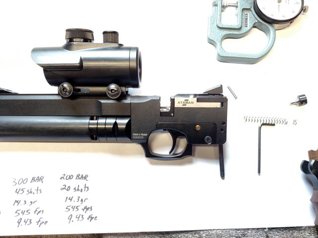

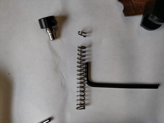

I just detuned my compact down to 500 fps with JSB 15.9. I actually couldn't get it that low with the stock hammer spring, so I had to remove the spring and cut two full rings off. This let me get the speed (and noise) way down. Just going from 600fps down to 500fps I doubled the shot count too. I was getting 3 full mags and now I am can get through a full 6 mags.

Here's some stuff I copied from a post I made back in 2017 on the Yellow:
Shot count numbers:
*The compact has a 60cc air cylinder. Ataman confirmed to me that the reg is set at 120BAR*
300BAR fill
45 shots @ 545fps @ 9.4fpe
14gr pellets
6 mags + 3 shots
200BAR fill
20 shots @ 545fps @ 9.4fpe
14gr pellets
1 shot shy of 3 mags
That's after I turned it down obviously. Mine will go down to at least 6fpe, and still go all the way back up to stock power just by turning the hammer spring screw. I see no downside to doing this, they should come this way.
Ha - thumper it was your exact old post I found that got me to cut the spring down a few turns. Thanks for reposting the meat of it here.
600 fps is cool, but dropping it to 500 fps, doubling the shot count and bringing down the report while maintaining the same accuracy in a pistol is even better.
At that time, there was almost zero info out on the Ataman AP16. I was going in blind for sure lol. Still haven't seen any more of those Chinese Remington pellets, I should have bought em out when Cabela's had em.
I agree, they are a lot more fun when turned down. Any kind of little moderator does a good job at 550fps it seems. The thing is insanely loud at full power lol
For pistol ranges and for the stuff I shoot with it, 550fps is plenty and I enjoy it a lot more this way.
Have fun with it!
