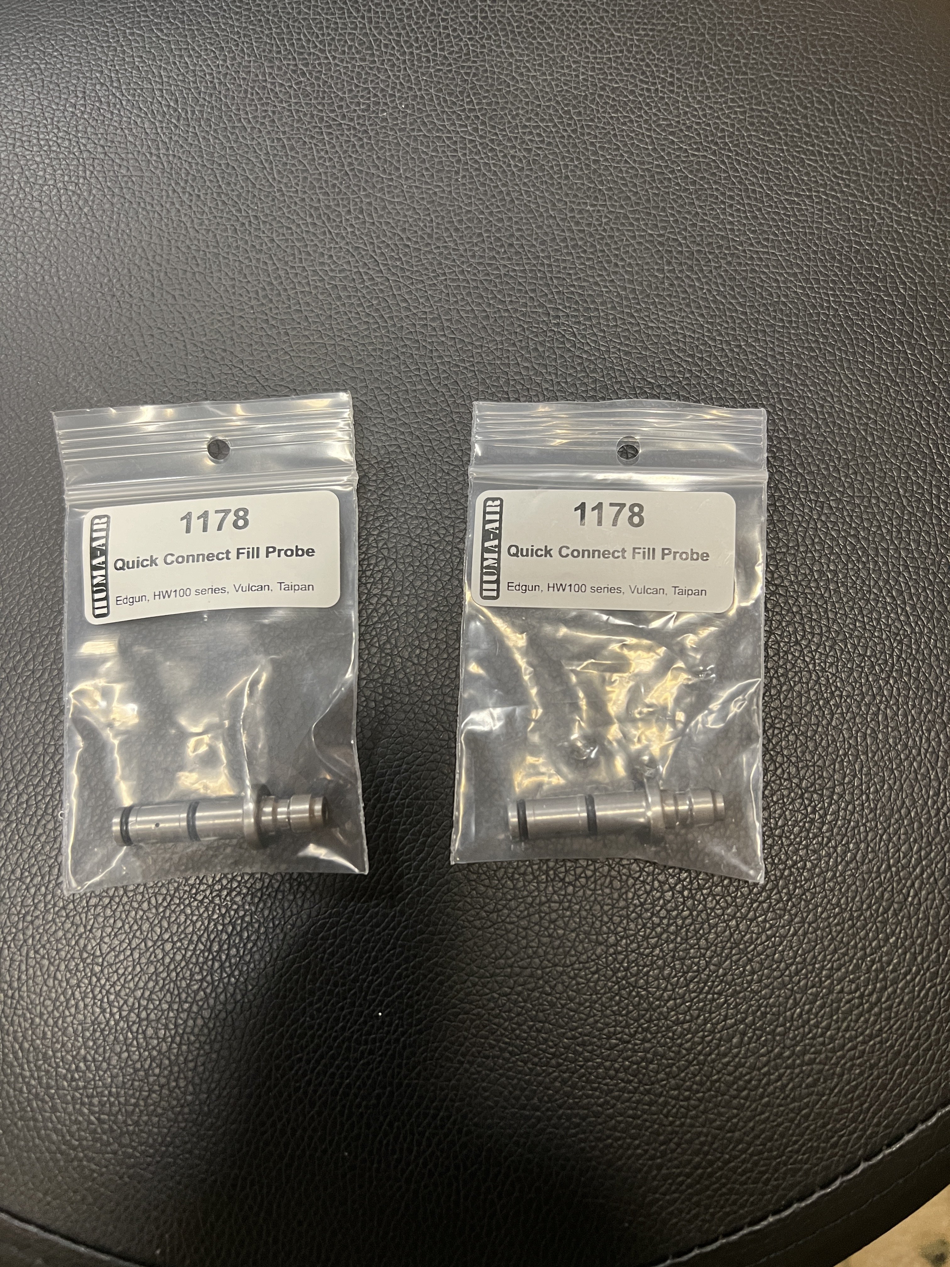

Help! Misplaced both fill probes for ataman ap16 and can’t find them online anywhere. Is there anybody who knows the size of it so I can hopefully replace. Thanks

We will be making all the Ataman fill probes shortly. And spare parts for all the guns from Ataman that can no longer be had.
.232 "dia. x .525" lg.
Then steps up to .270" dia., that acts as a stop, so the probe doesn't go in too deep.
The center of the first o-ring is about .110" from the end of the probe, the second o-ring is about .390" from the end of the probe.
Good luck
Mike

We make the probes for the AP-16 and they come with seals. Both threaded and foster are in stock at this moment.Thanks so much for responding i really appreciate it. I’m so irritated with the fact i misplaced the originals. I’m probably gonna need way more than luck to find that thing online anywhere with those same specsthere’s almost no doubt in my mind that I’ll never shoot my ap16 again. Poor gun has less than 50 shots on it

We make the Ataman AP-16 fill probes in threaded and foster connection. They are in stock and come with seals.
