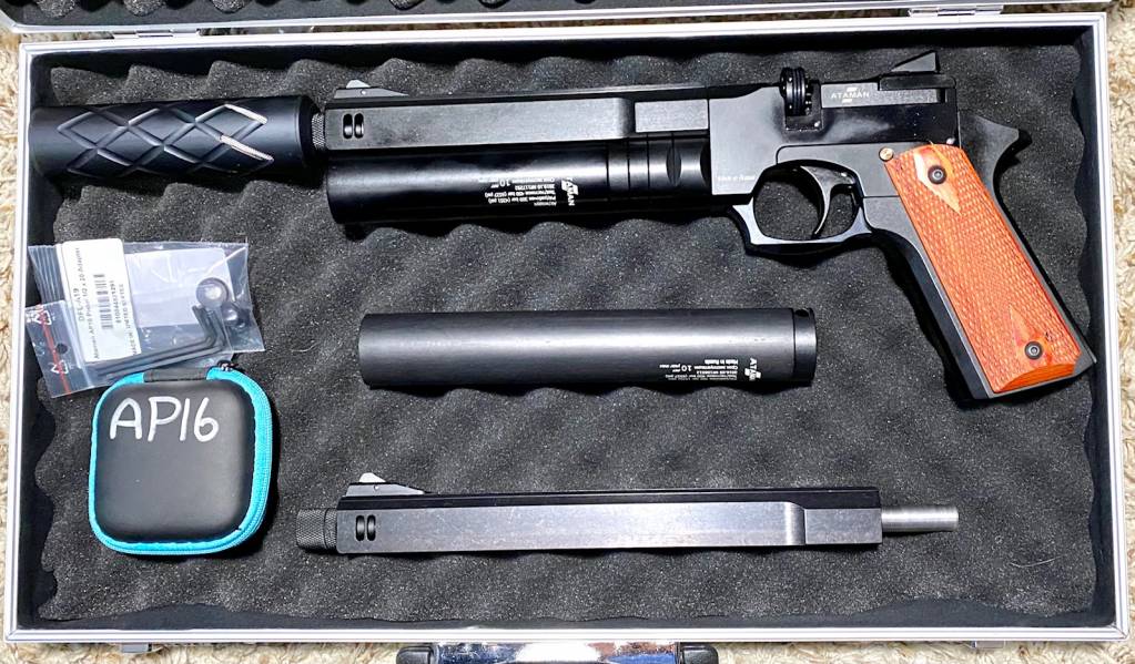

My newest project! I did some pellet testing today with both the Standard and the Compact Barrel/air cylinder combos. Here are the results:
Accuracy is really amazing! I did mount a micro red dot on it, which helped a lot. The stock iron sights are black and really hard to get a good sight picture. I did but a white dot on either side of the rear sight and the top of the front sight, which helped tremendously, but the red don't was way easier to zero! The 15.89 and 18.13 grain JSB's gave the best groups, and the was not that bad at 12.75/13.39 FPE with the compact barrel and 14.76/15.51 FPE with the standard barrel.
I also have a DonnyFL adapter and 0db Compact LDC, which makes it very backyard friendly! So far, I'm quite happy with it and have a tactical leg holster that fits the compact perfectly, just without the 0db LDC attached.

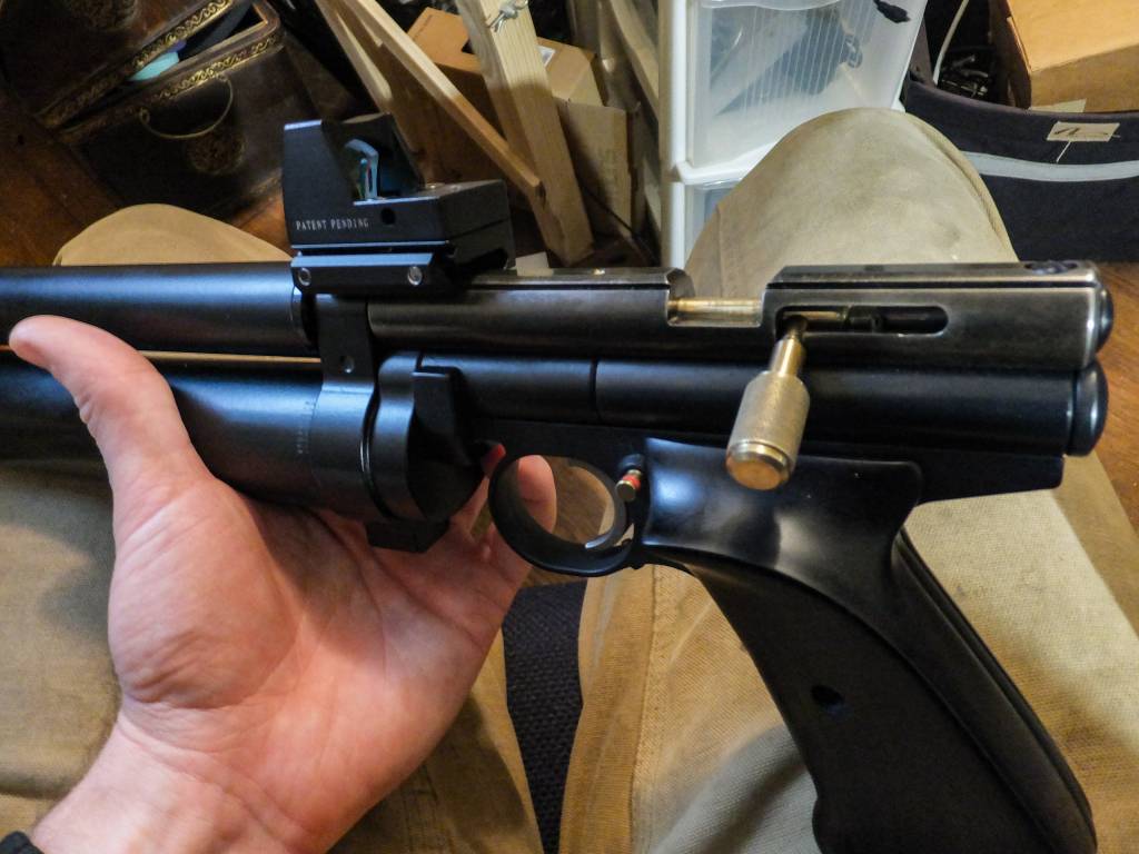

What Crosman variant is that Long_Gun?
