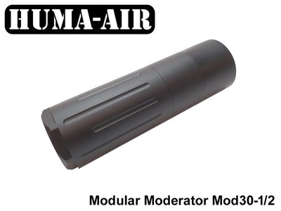

No arm twisting required! It's the Huma Air, Modular Air Moderator MOD30-2/0 (Mini), with one of the sections removed. You can double the size by adding the other section back to it, if needed. I have not had a chance to test it yet because I ordered it and then had to send the AP16 back to PA due to it not cocking. I'm hoping the weather will hold out today and I can see how well it quiets it.

I've tested the Huma Air moderator on an Ataman AP and some airguns . The modular system makes them very flexible . However , the density of the felt inside the tube is too high . Like @Odoyle said in another topic " let the moderator breathe " , so I remove the felt and put some open cell foam , the one used to fill some garden seats. Seems to works better, but it would be interesting to try others materials like sponge , cotton...etc.
This was one of their newer models, and they say the damping material is kevlar. If so, I guess it would be pretty dense. To my ears, it's as quiet or quieter than the 0db Compact I had on it. I also like how compact it is, no long LDC nearly doubling the length of the pistol, yet it's still very much backyard friendly. The model I bought came with 2 more section, so I might experiment a bit with the other 2 sections to see if I find a material that is quieter than the kevlar. Thanks...

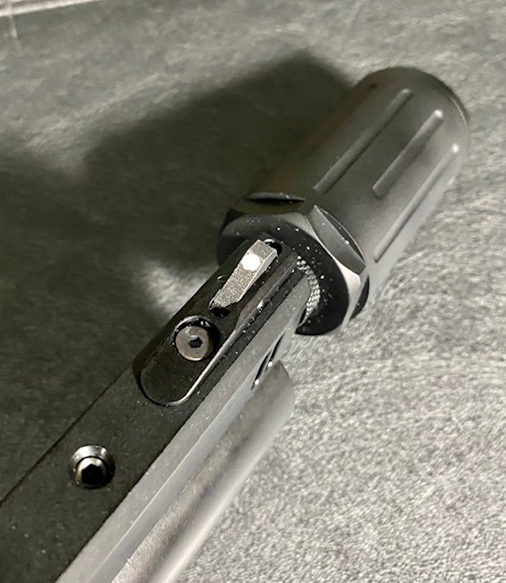

Huma silencer is in hand. Very nicely done. And yea, I like the two piece design. Visually, it fits a handgun perfectly, both diameter and length (with the second piece in the storage cabinet). The guts seem interesting also. Hopefully it cuts the bark enough. Will try it on a rifle here shortly.

I'm hoping a single section of the Huma quiets the bark of the AP16 enough for comfort. Hmm, if "looks" were only...everything !

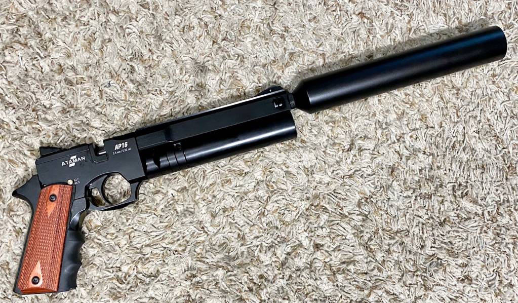

Well, after all of the bad that I've read, plus the above info, guys with scratches of the anodize coating, rough material surfaces, dents, etc., etc., and to boot, the one that I received was the last of that litter, all is well.
Visually, all is in good shape. The black anodize coating is in very good condition, no dents, dings, or scratches that I see. The "test tape" that came with the gun shows an average of about 645 fps.with an 11.9 gr. pellet. in ten shots.
I filled the magazine (still had enough air for a few shots), and shot twice with no muffler. Then twice with the "full sized" Huma, then with the half sized Huma. No muffler IS fairly loud. Too much for here. The full sized Huma is nice and quiet. Almost as quiet as my Sig Sauer, ASP, single shot. The half a Huma is borderline loud. Will probably leave it that way.

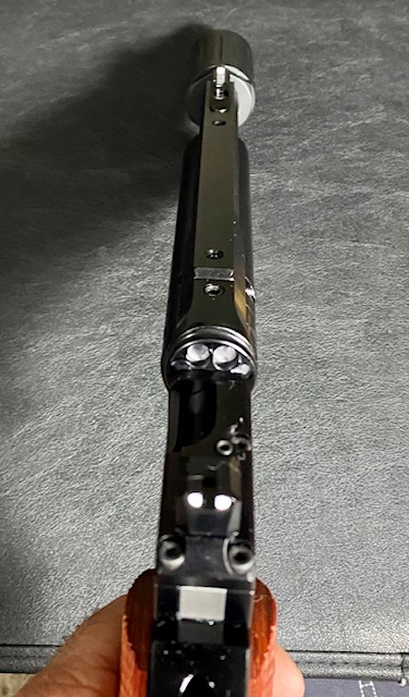

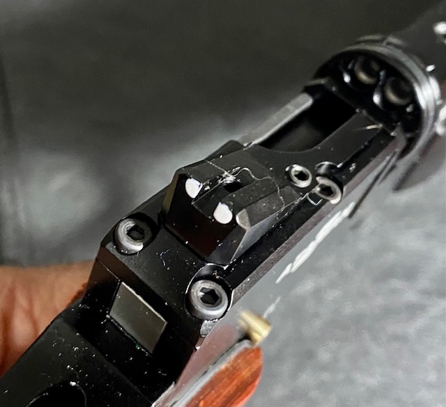

I put a SeeAll sight on it. It may stay a while, it may not. I like the feel of the gun. While it's obviously front heavy, I put the 11MM adapter back, almost as far as it will go, then put the SeeAll back as far back as it...will go, to try to keep the weight off of the front.
