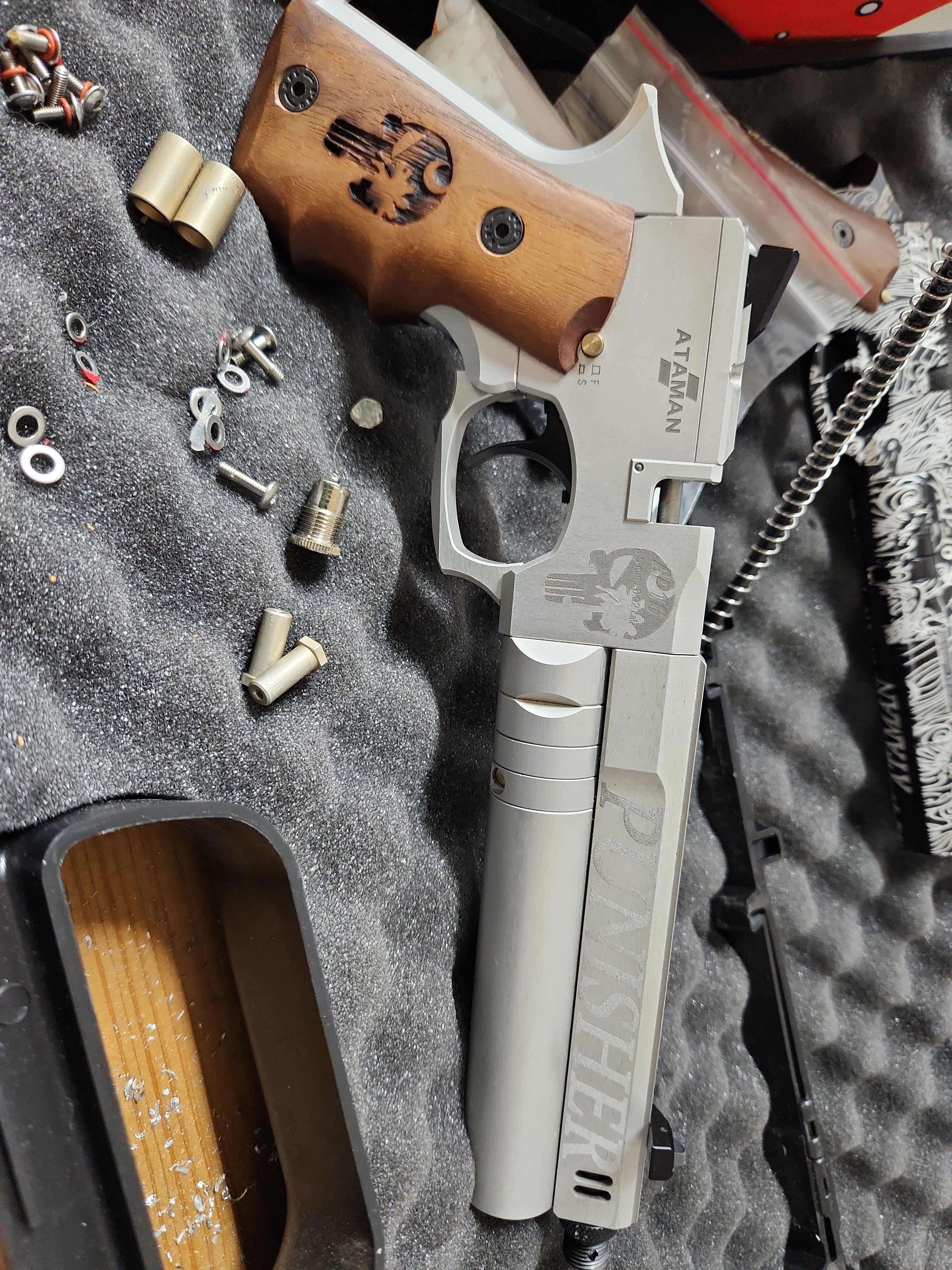

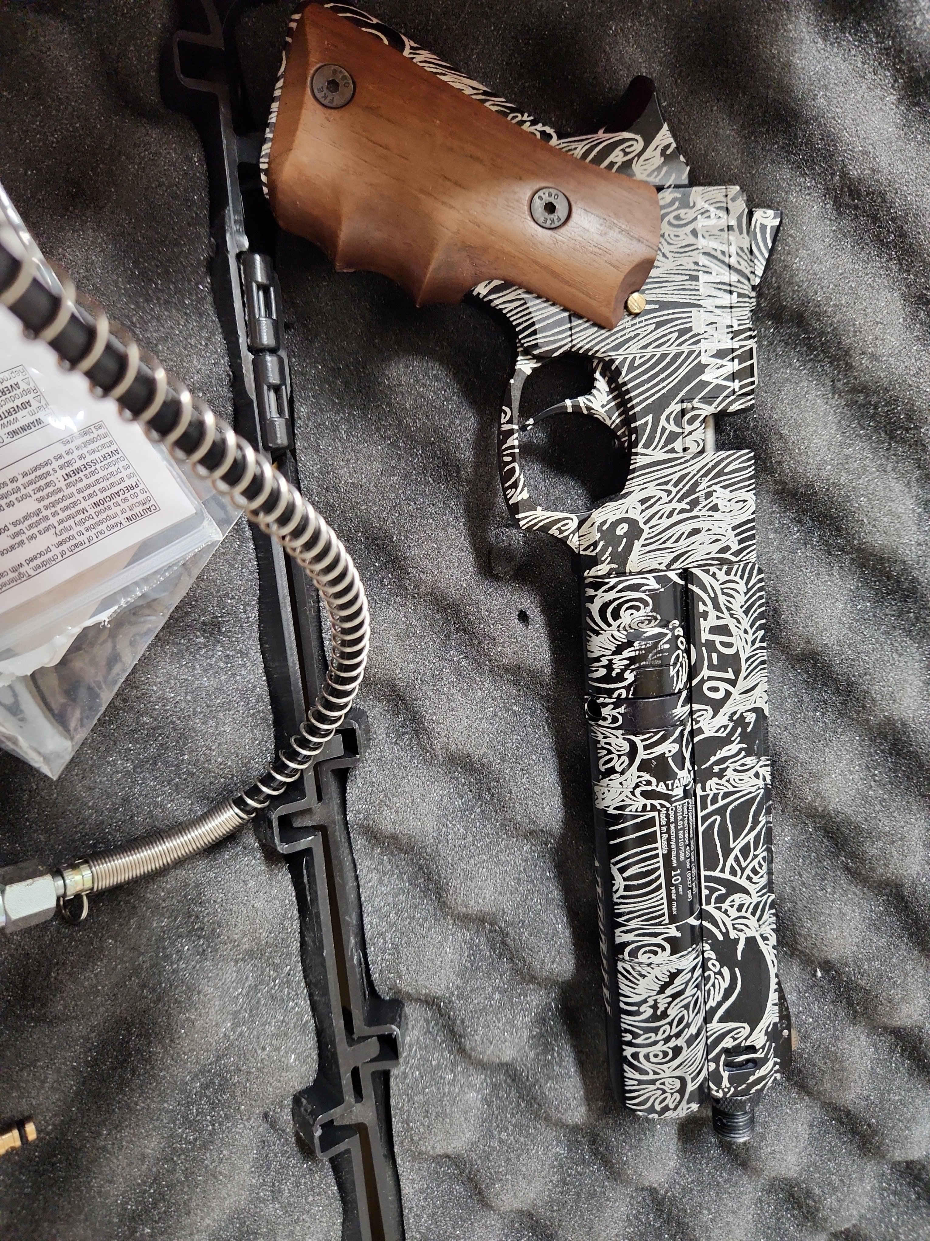

I have 6 of those Atamans, thanks for you words..Love the punisher grip (@LeeThomas) and the black plastic grips (@MikeVV).
Well done.
The psychedelic scheme on the action of @LeeThomas is HOT!

You can always send your handles to me and ill see what I can come up with. I only need the handles so I can create a digital file. Then I can work many ideas till it suits me without damaging original handles. I even machined a set of grips out of pre historic Mastadon teeth. And also N5 Titanium. [email protected]You have great skill!

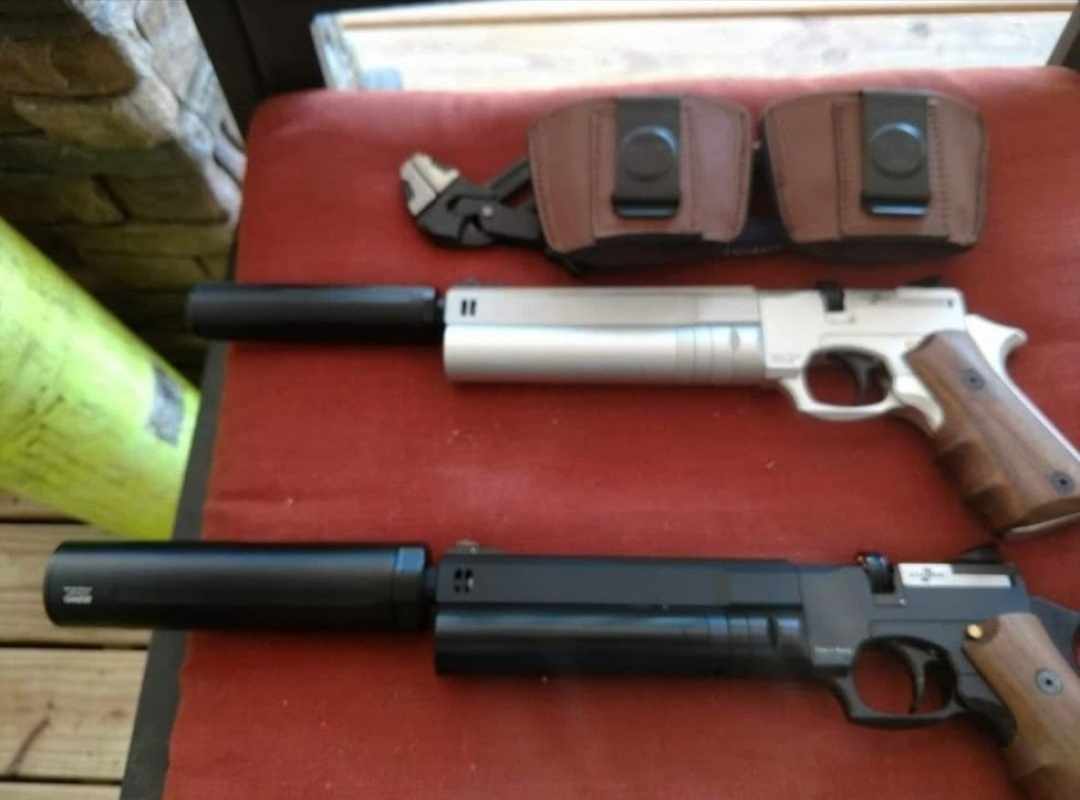

I agree...The build quality extremely well done...too bad they are not being imported again.One of my favorite air pistols...extremely well built
If anyone's looking (as of 11.13.24) -
