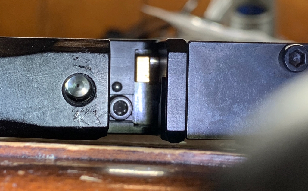

I think I found the issue...... not being one to step down for a challenge I pulled the whole gun apart checking everything along the way as I worked my way into the valve area. I thought I was going to find an obstruction somewhere, but nothing like this one. The TP was never machined all the way through and just a tiny pin hole to flow air.
What size drill bit would be recommended to open this up?
