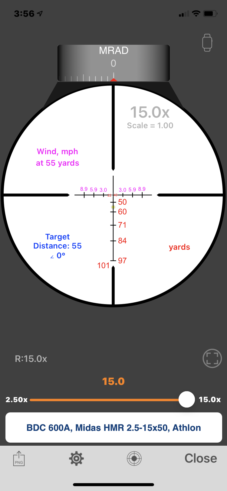

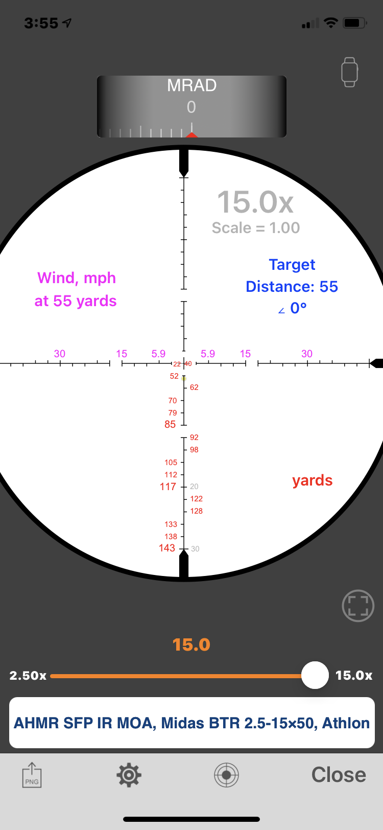

I thought I would post this. I put both reticles of the Midas in sterlok the 600BDC reticle would be a little thicker. I think I would even like it better.

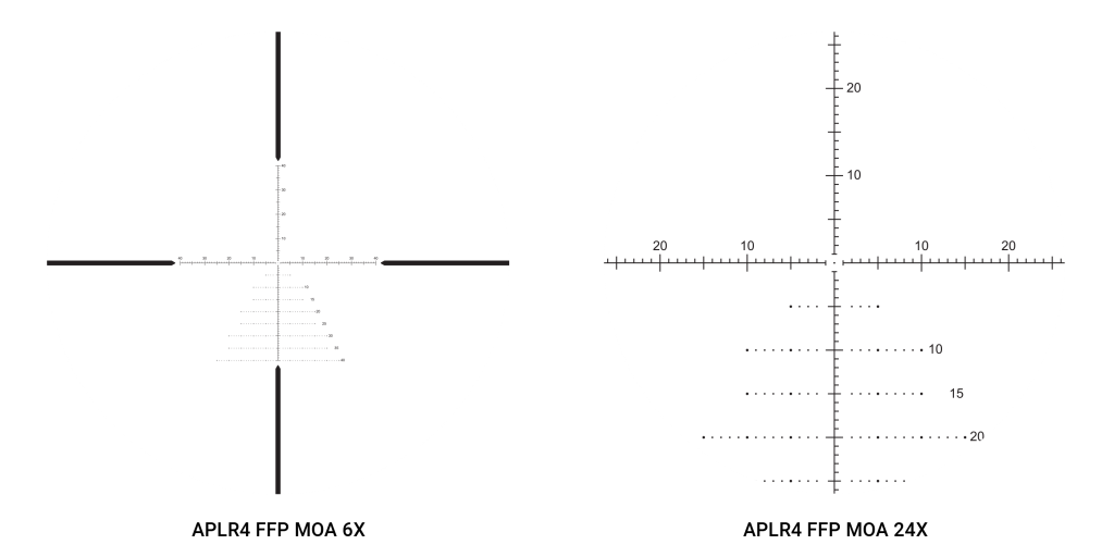

I grabbed the 6-24x50 with the #4 reticle (ALPR4) MOA - I think it is THE nicest, cleanest reticle on the market. I realize that is completely subjective but the #4 has the floating center dot (I'll put a pic below) it does not have the Crosshairs or center +
