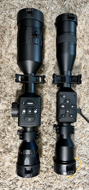

Here's the X-Sight 5 next to the X-Sight 4K Pro.
And, a close up of the controls on top of the scope. The zoom wheel is gone and it's an electronic zoom now.
