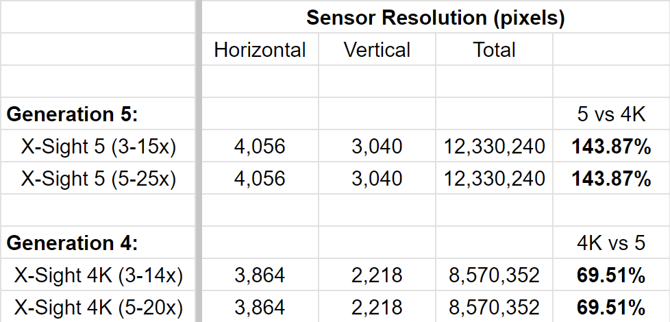

- X-Sight 5 has 143.87% of the Sensor Resolution of the X-Sight 4K.

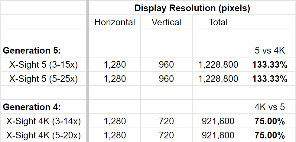

- X-Sight 5 has 133.33% of the Display Resolution of the X-Sight 4K.

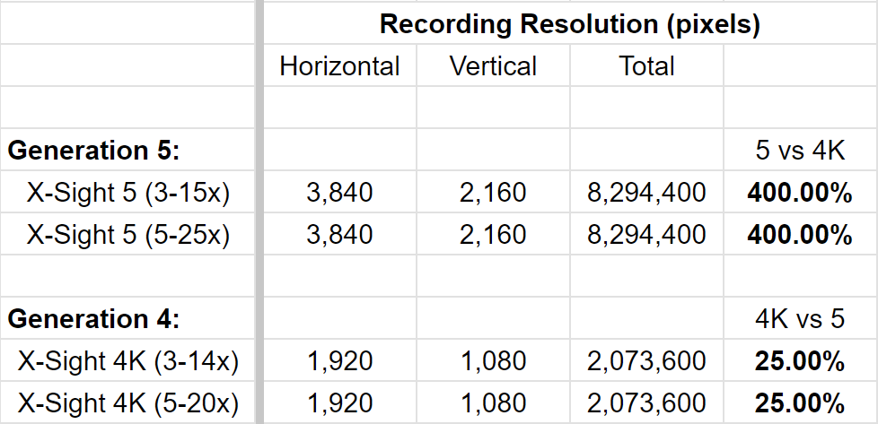

- X-Sight 5 has 400% of the Recording Resolution of the X-Sight 4K.

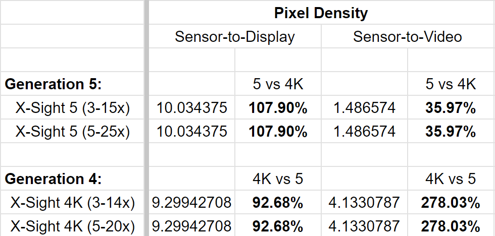

- X-Sight 5 has 107.9% of the Pixel Density (Sensor-to-Display) of the X-Sight 4K.
- X-Sight 5 has 35.97% of the Pixel Density (Sensor-to-Video) of the X-Sight 4K.

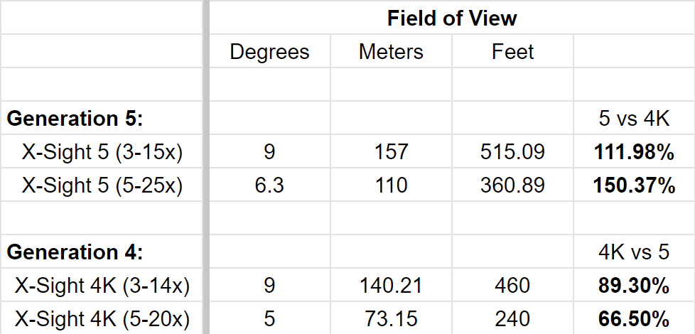

- X-Sight 5 (3-15x) has 111.98% of the Field of View of the X-Sight 4K (3-14x).
- X-Sight 5 (5-25x) has 150.37% of the Field of View of the X-Sight 4K (5-20x).

- 400% increase in Recording Resolution paired with a 35.97% increase in Pixel Density (Sensor-to-Video); which means MORE Recording Resolution from LESS Pixel Density.
- 111.98% (3-15x) and 150.37% (5-25x) increase in Field of View paired with a 107.9% increase in Pixel Density (Sensor-to-Display); which means MORE Field of View from LESS Pixel Density.

@FLgunner - Thank you for taking the time to respond, appreciate it. Your initial thread is what prompted me to start compiling the metrics above in hopes of finding explanations for the issues early adopters like you were experiencing. I am starting to believe at least some of the X-Sight 5 issues being reported by early adopter customers can be explained by the metrics above.
For example, your commentary about the X-Sight 4K Pro appearing much sharper than the X-Sight 5 makes sense when considering the relatively small increase in pixel density (7.9%) compared to the relatively large increases in sensor resolution (43.87%) and display resolution (33.33%), particularly as magnification increases.
Along the same line, given the difference in magnification power between the 3-15x and 5-25x models of the X-Sight 5, I suspect pixel density issues (i.e. display clarity, recorded video quality, zoom functionality, etc) will be more prevalent amongst customers with the 5-25x model than with the 3-15x model.
