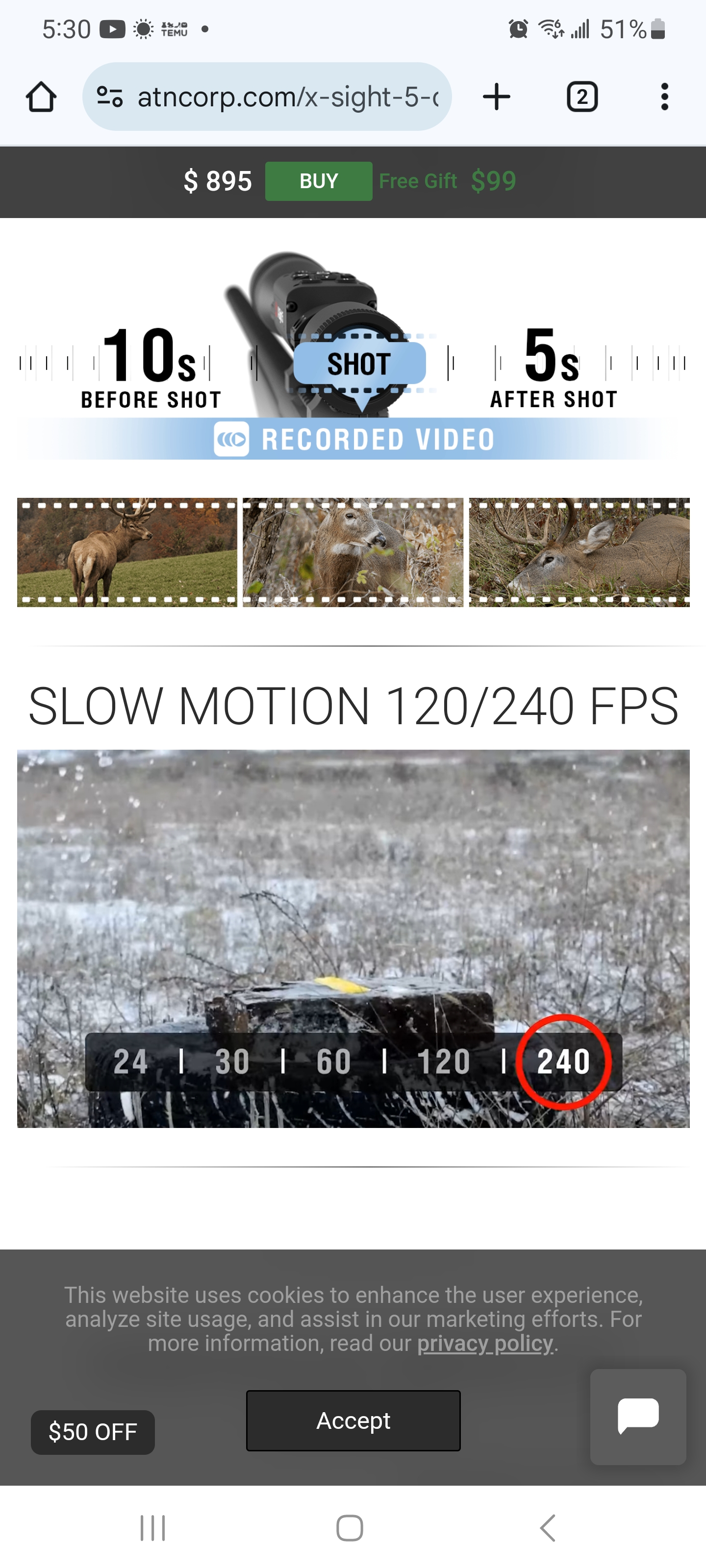

So atn released their new model the xsight 5. It's supposed to record up to 240fps in 4k. But I can not find any videos on youtube showing this. Most ppl who review this scope is using it on a firearm and doing normal 30 fps. Specs says it can do 4k 240, why the f are these reviews only doing it 30fps. Smh. Anyone have the new xsight 5, can you confirm it can record 4k 240 fps. And is the video better than using a gopro scope cam at 1080p 240fps.
I don't believe it records at a true 4K when recording at 240 FPS. The resolution is not as good as what they show on their website. It does pretty well recording at 120 FPS, but still not as clear as recording at 30 FPS.

I'll have to try and find the video I did in 240 FPS and send it to you. I may not be able to upload it here because it was a hunting video. I did check the manual last night, and 240 FPS is only available in daytime mode, not NV. Also, it's not a setting under the recording section like the 30/60/120 FPS selections, it an option under the quick menu, which is kind of odd. When the scope was first released, 240 FPS was only available when using RAV (Recoil Activated Video), which unfortunately, does not work consistently at all with an airgun. Shoot me a PM with your email address, if I can't find the video, I'll record a couple using 240, 120 and 60 FPS for comparison so you can see actual footage.
