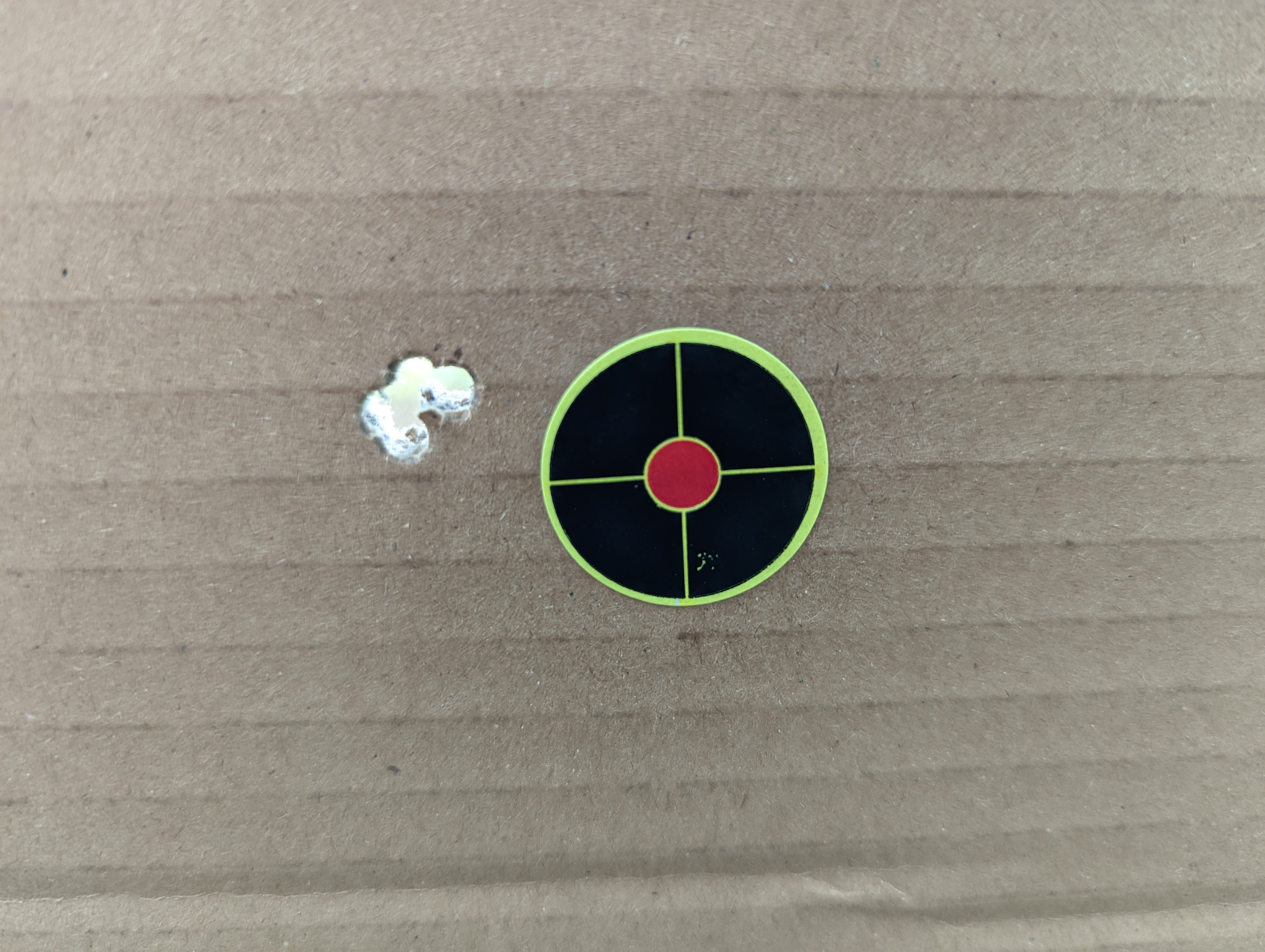

So if it moved a third of a squirrel head that wouldn't work?
I haven't experienced any poi shift but I wouldn't fall to the floor kicking and screaming if the first shot was a half inch off the others.

I would, I find it unacceptable for a hunting gun to have any kind of POI shift, might be 1/2' today and 2.5" tomorrow....I would never, ever have confidence to take a gun hunting that I know has possible POI shifts, No way !
Those 2 groups mean nothing,....POI shift is when you put a gun away that printed great groups right at your zero, but when you take her out the next day it will still print great groups but not at the same place it was the day before.
