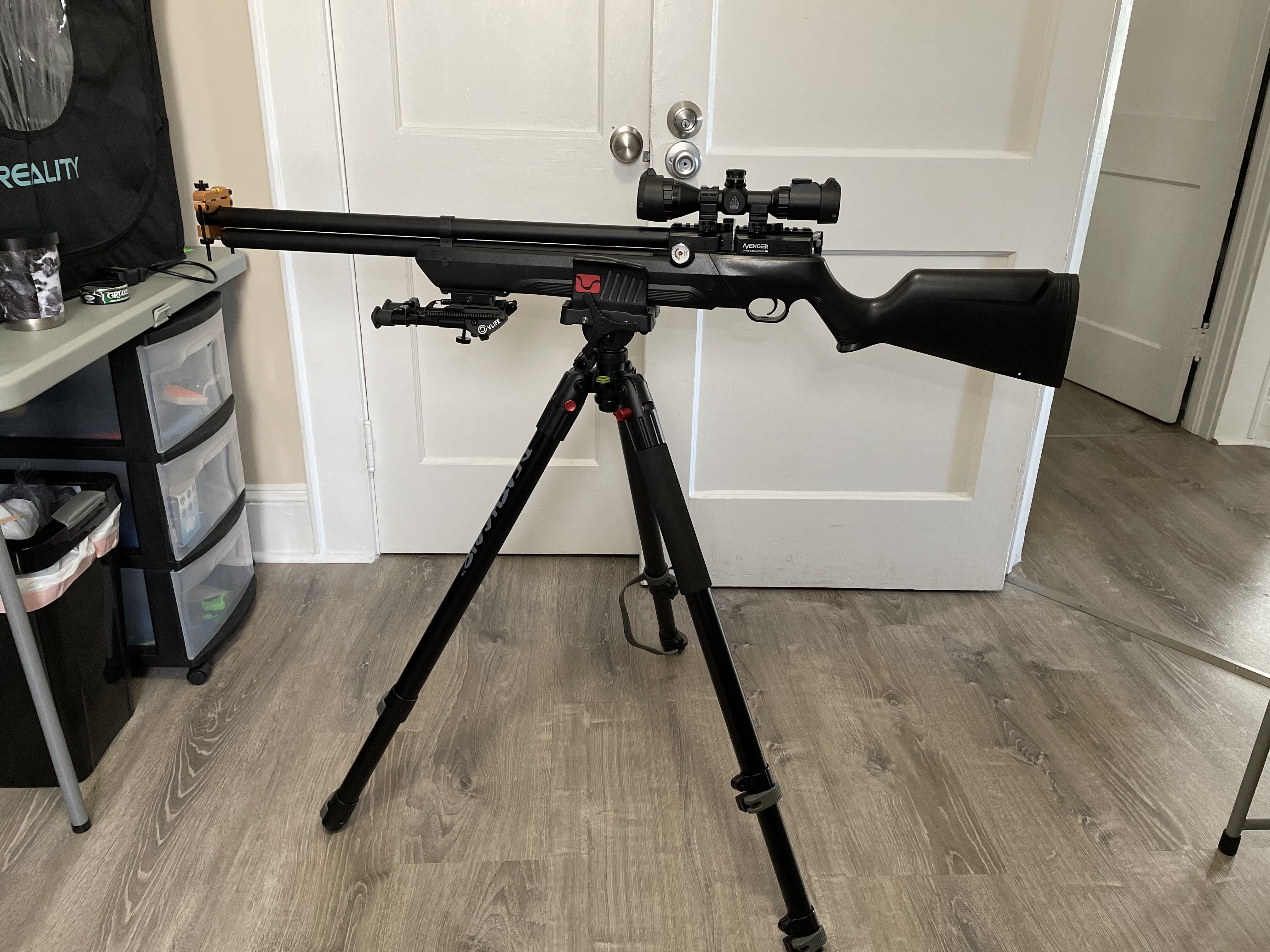

Just got my first PCP , The Air Venturi Avenger in .25 cal, just wondering what upgrades you guys have done to yours and which have yielded the best results regarding accuracy, also trying to get 10 post so I can get in on the classifieds action lol. Let the suggestions fly! Thanks in advance 👍

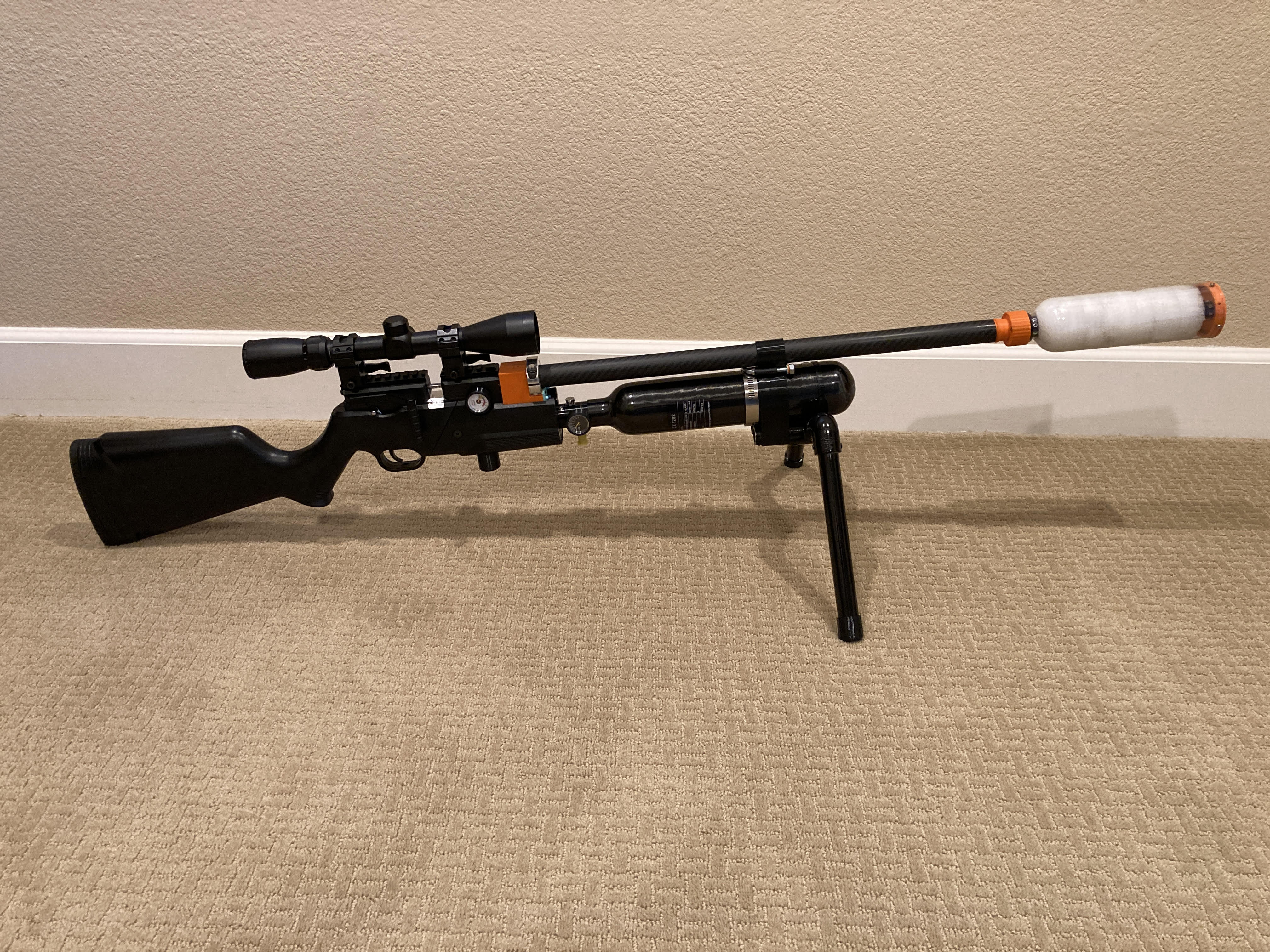

Get yourself a block off and bottle adapter kit from AE Swede they are worth it. I also make the reinforcement block for his kit so you don't have to worry about breaking at the connections.

Ok cool so if I get a kit like that what kind of bottle would I need to buy and how much $ am I looking at

i got my 500cc CF bottle from aliexpress last year and it’s been working great. I think the CCP is trying to kill aliexpress(because they don’t like Jack ma) cuz all the stuff that were available now are all 404’d. Now the bottle prices are over the roof I’d recommend thick wall aluminum bottle from amazon I just checked recently you can get a 500cc aluminum bottle for $50 just fill it up to 3000psi to be safe. AE Swede now has the right high output regulator in stock just make sure your bottle has M18x1.5 thread and you’ll be all set.
Alliexpress has 0.5 L carbon fiber 4500 psi bottles now for $100.00/free shipping. I have a aluminum 4500 psi 0.5 l bottle and it is very heavy.
Oh damn they always come back alive when I wasn’t looking. Or you can just yolo with a 700cc.
