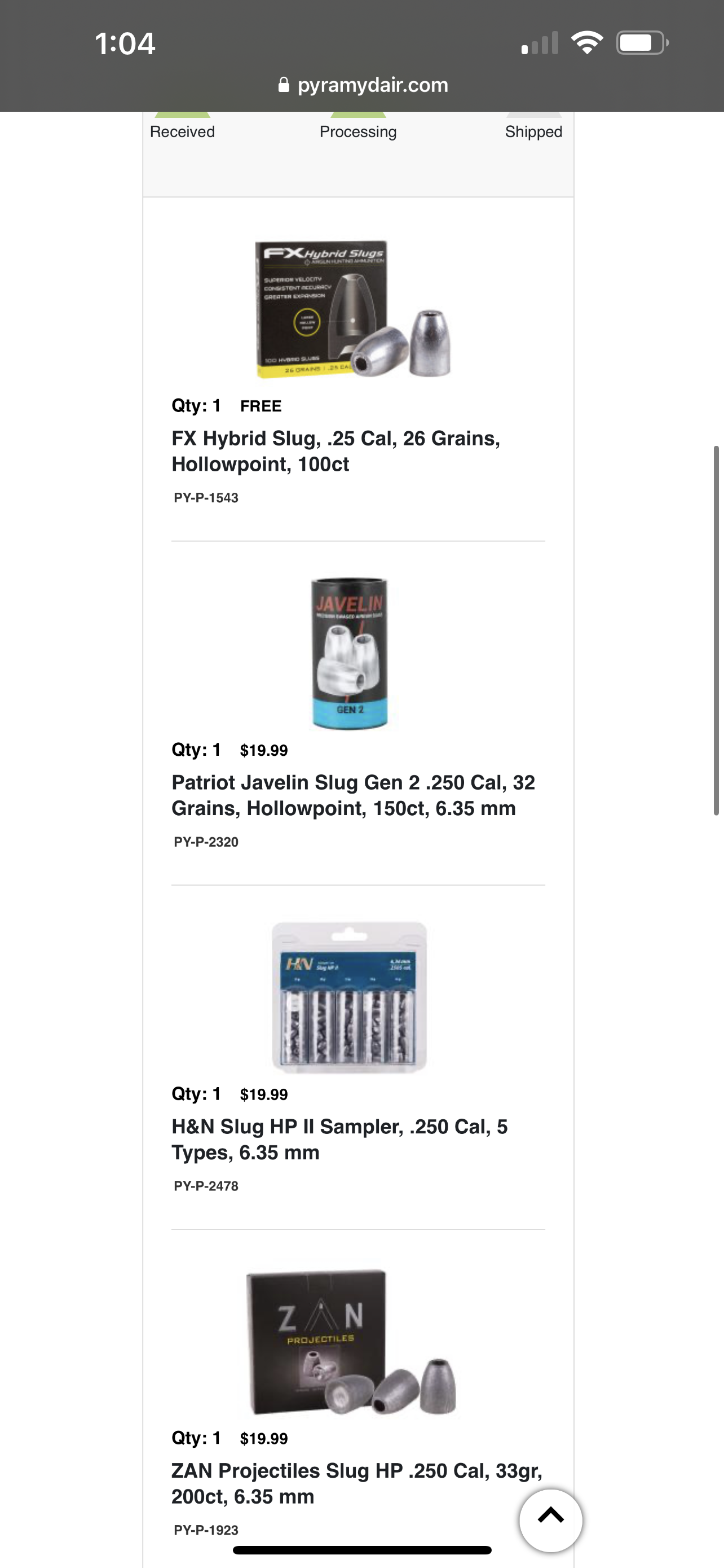

So my wife suprised me with order the avenger in .25 for Christmas. I plan on making it a full time slug/ small to medium game gun. Have these on the way and will keep y’all posted. In the meantime has anyone had luck slug shooting the avenger in 25? I’d love to hear about it!
