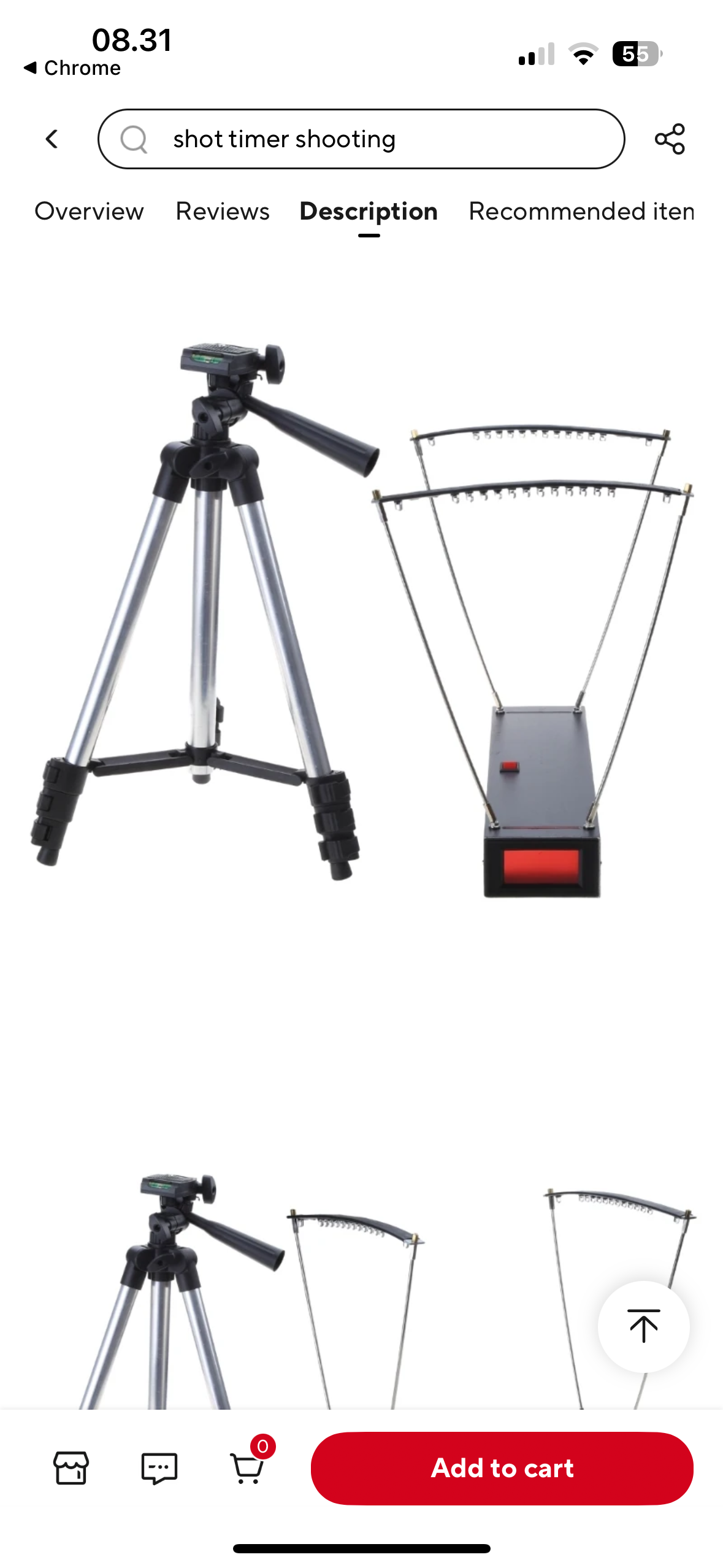

I have two different inexpensive chinese made chronographs. I bought a barrel mount one first and they are still available from Aliexpress for less than $20 or from Amazon for about $30. Mine works fine but it shifts my point of impact and I like to shoot groups while getting velocity readings. So I bought a tripod mount that works on infared light like the barrel clamping one but sits by itself unattached to the gun. I got it from Aliexpress and it was harder to find. I'd post a link but I cannot do them from a track pad like I use on this laptop. But a google search like "cheap chinese chronograph for airguns" should find at least the barrel clamp one.
Like this one?

I've never tried one of the conventional looking chronographs from China. Aliexpress calls the clamp on "shooting chronograph bullet speed tester" and the tripod "high sensitivity multifuntional for shooting speed meter ball velocity energy measurement shooting chronograph shooting speed". The clamp on is under $20 and the tripod under $25. Both are much smaller than a conventional chronograph with a black plastic base with four metal standoffs holding up the top part where the display is. The clamp on has a V shaped block on the base with a rod that curves up over it to clamp to the shroud or barrel.
I do not like searching aliexpress but if you did it with that exact language I think it would work. Or just google "cheap chinese chronograph" and at least the clamp on should show up.
Both the ones I like have rechargeable batteries that last a long time and they almost never miss a shot inside or outside. The work better than my last conventional chrony. The first ones I got only read mps but the last one I bought can be set to fps if you push a button during the startup.

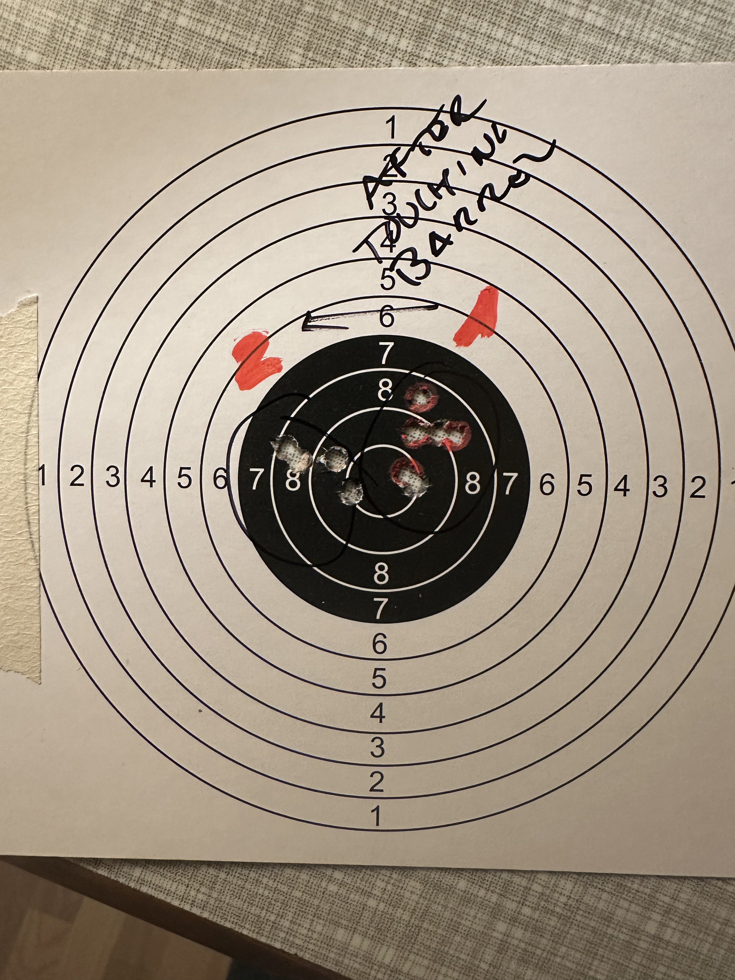

Update - in a way… so I took the stock of the gun and tightened every screw down. Nothing seemed off. BUT I was able to push the schroud/barrel itself from side to side, almost as if its not seated correctly in the “housing” But it seems to be, I am not able to push it in any further, and both setscrews are tight. Is this normal? I put the gun back together and tried to shoot some groups again. It grouped okay, but it was off to the right. So I pushed the barrel very gently to the left and voila - the gun suddenly shot to the left of the target. There is a small gap between the schroud and the housing. It almost looks as a shim or a gasket of some kind could remove the gap. This is not supposed to be this way, or is it? I have heard of free floating barrels, but not like this. Or?

My first thought is the barrel isn't pushed in all the way but my barrel has a very small gap like yours. I think mine* might be smaller. Does the magazine click into place fine?
Is your barrel supported by a barrel band and if so, is that secured to the stock?
Yes the barrelband is secured to the stock. And the magazine clicks in fine. Irs just weird that you are able to aim by pushing the barrels to one side by hand🤣🤤
You'll need to show us what you're pushing on. There should be two things inside the shroud, some spacer more towards the middle of it and the baffle system at the very end of it.
I can push/pull the barrel with the schroud on from side to side relative to the air cylinder. I dont use any force. Almost as if the barrel is not fitted 100p to the housing. The bafflestack and the center plastic thing in the middle of the schroud sit as they are supposed to.. so if I grab the cylinder with one hand and grab the barrel with the other, I am able to change the “direction” of the barrel
