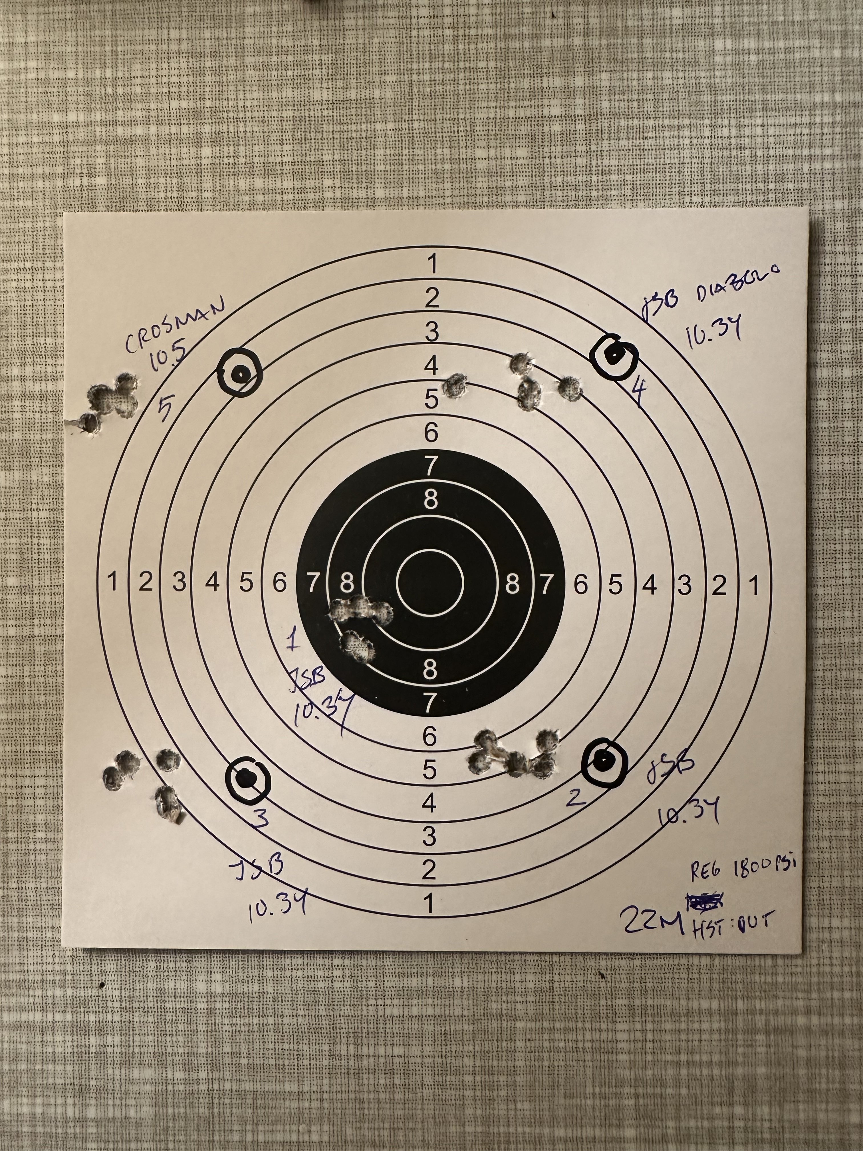

Where do you live in Denmark? I just tried the gun after a clean last night, and its completely useless. The groups are not even groups anymore. So I need someone to test my gun and see whats wrong with it. The reg settles at 1800psi but creeps up to about 2000 psi eitin 10 mins. The barrel is clean and the probe orings seem fine. Here are my “groups” on 22m with the crossmans on one and h&n on the other🙁🤣😅🫣

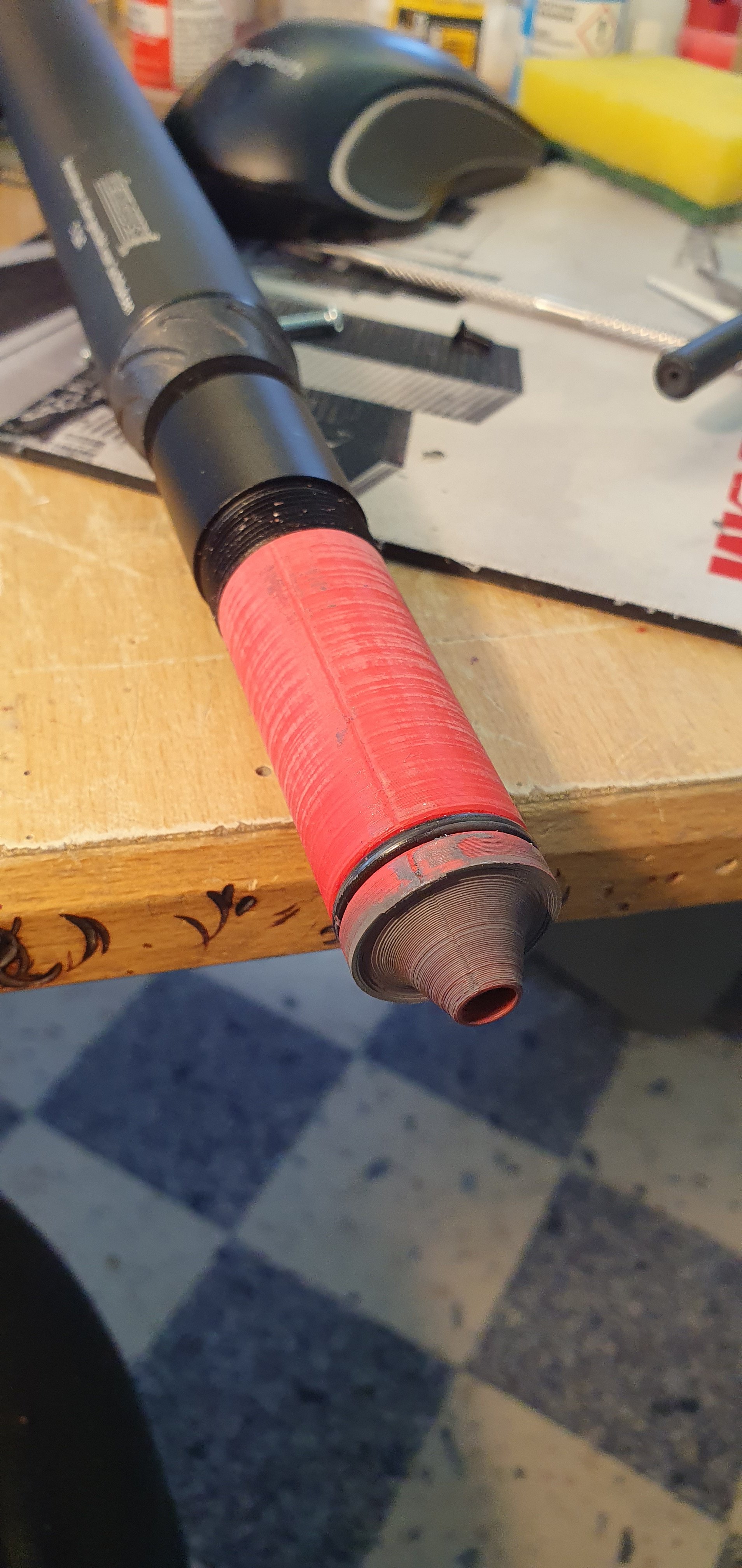

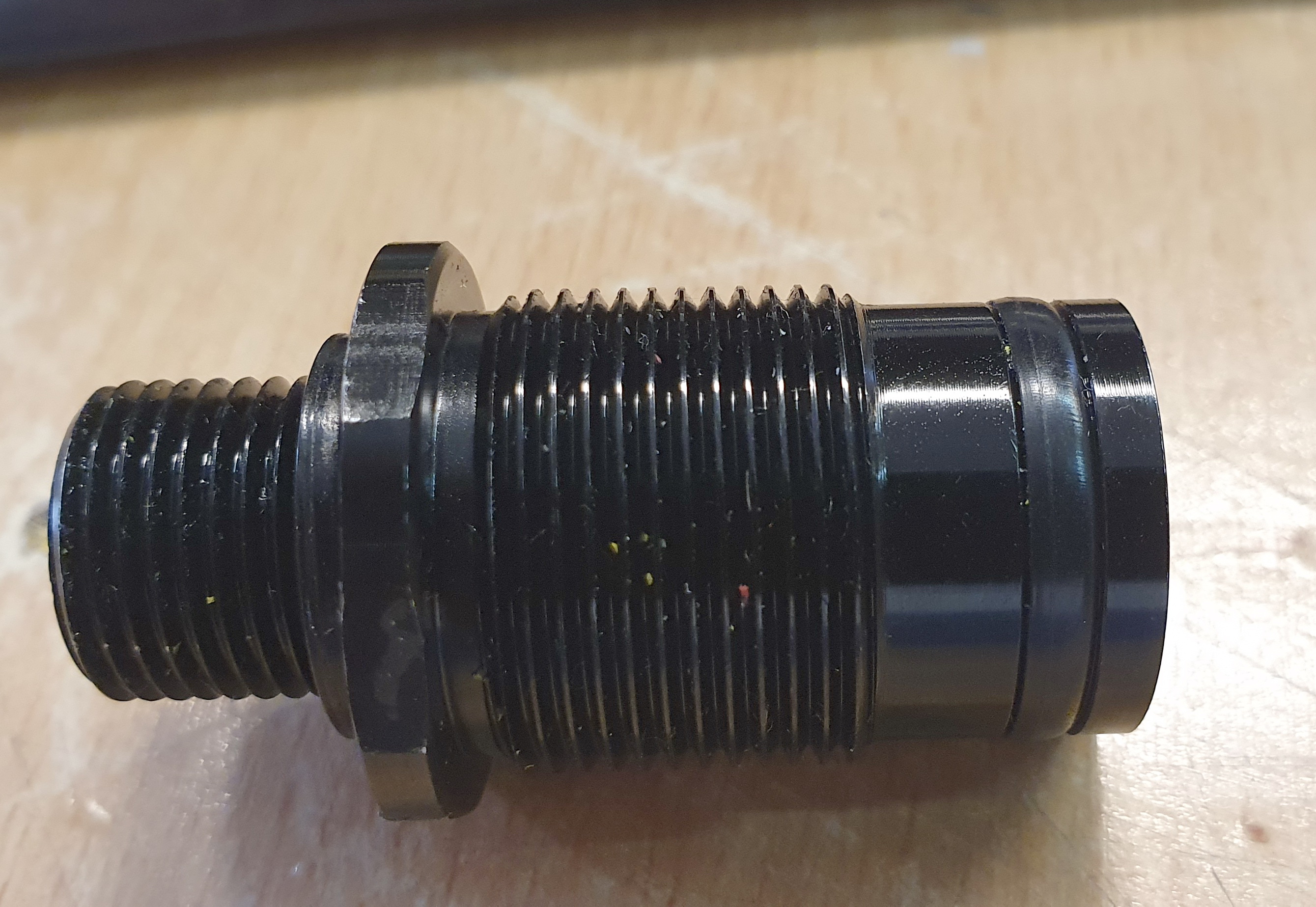

Great that you improved. I designed and 3d printed new centering brackets for the shroud. I have no baffles in mine. I bought the 1/2"-20 UNF adaptor at Krale - and that has a pipe that extends over the barrel, but the pipe has got a much too lose fit. So I redesigned the system and shortened the pipe on the moderator adaptor and 3d printed an airstripper in stead.
That improved the accuracy a lot.

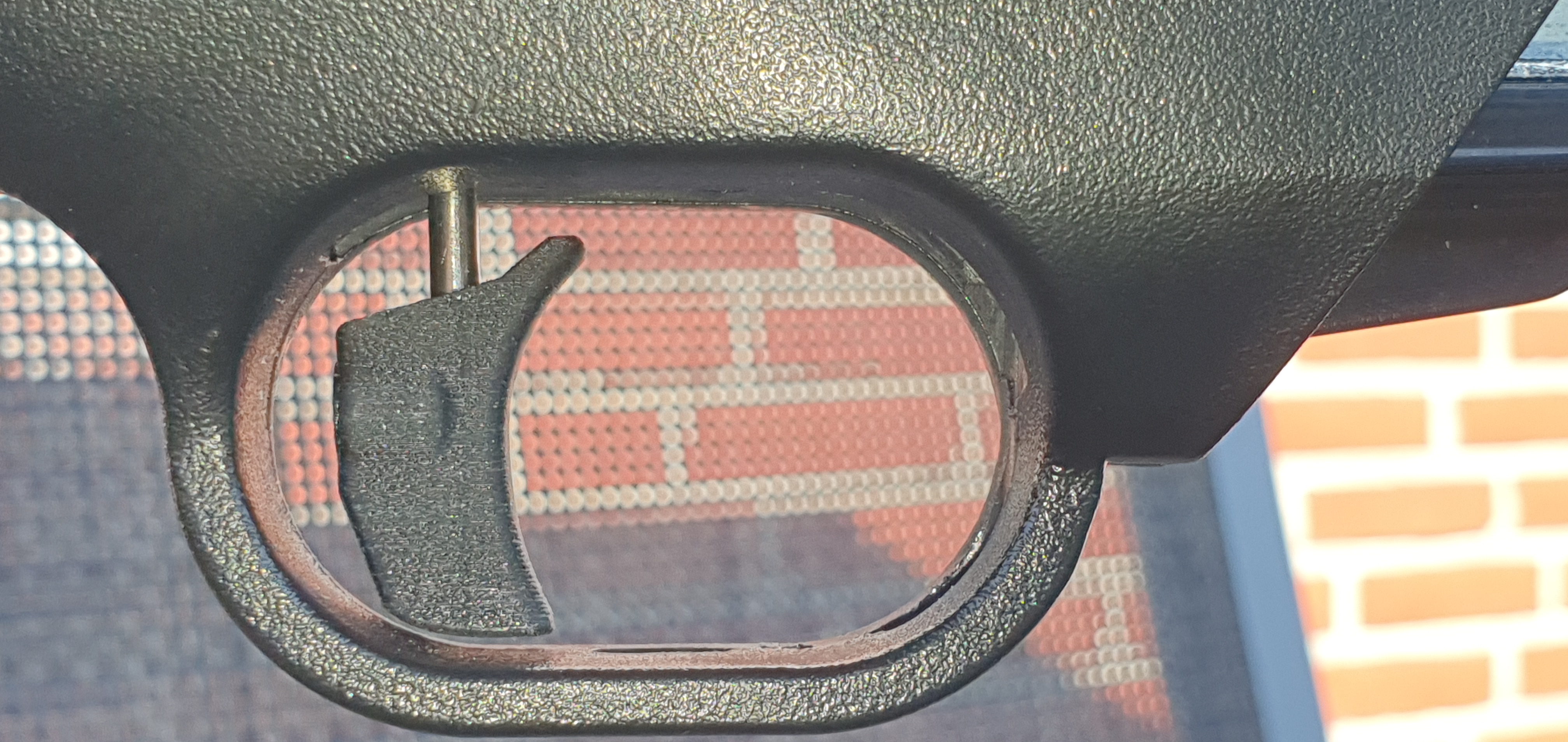

I also spent a lot of work - improving the trigger - changed angles, springs and polished all surfaces. It is so bad from delivery - very difficult not to pull the shots. Also moved the trigger location and shape.

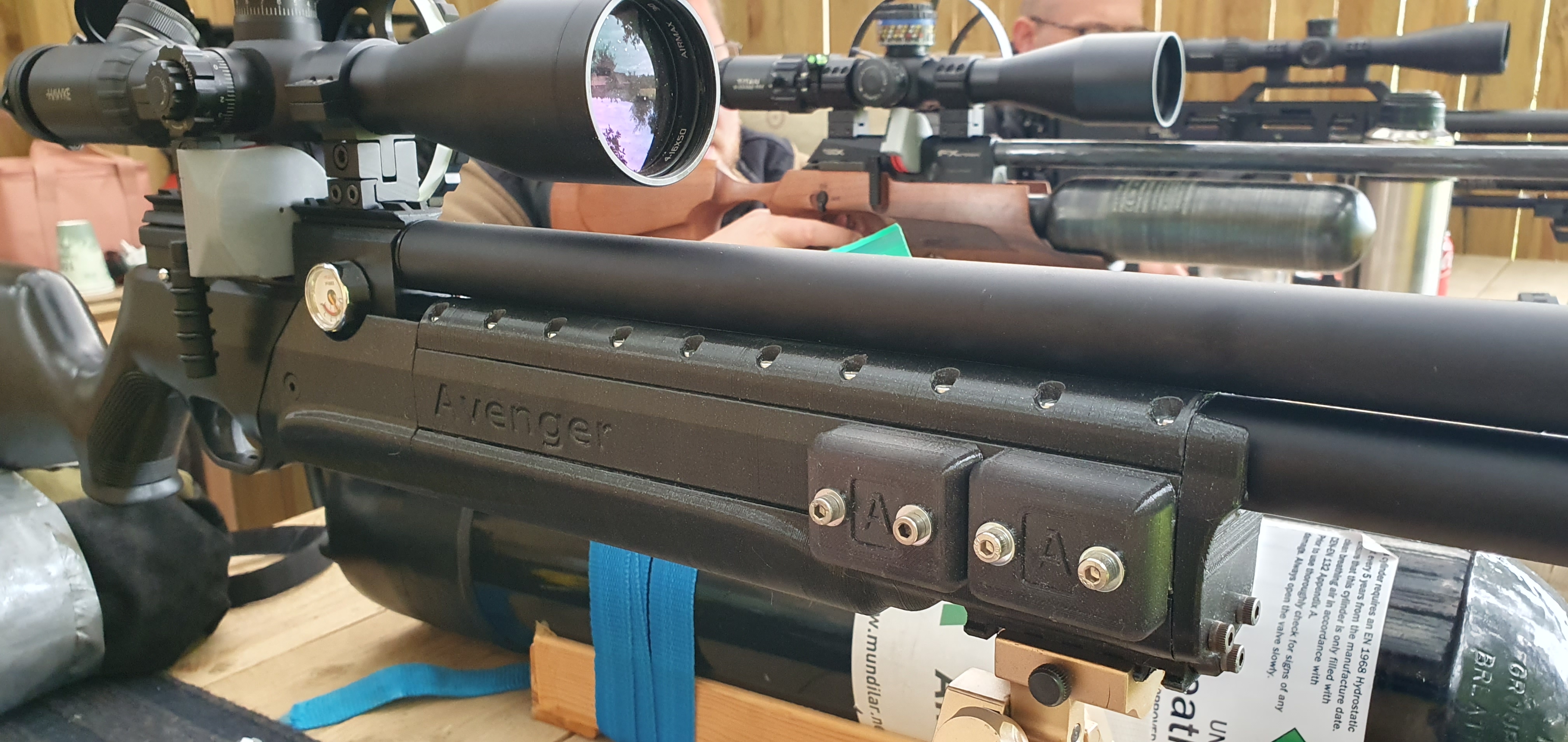

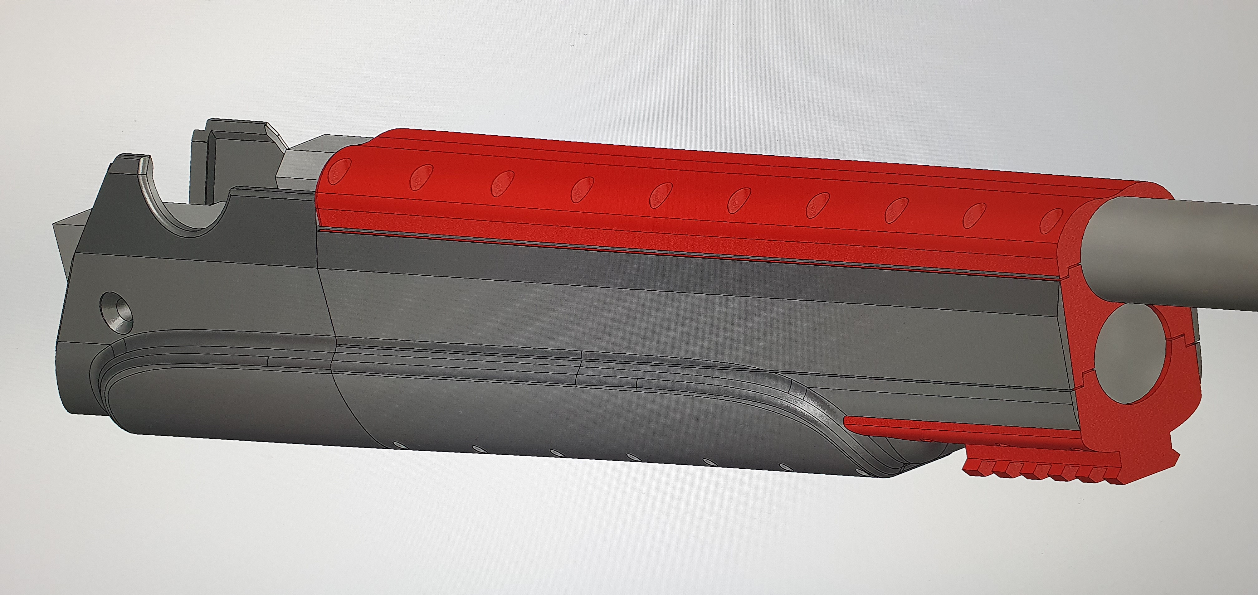

I Designed a new front part for the stock that squeezes on the two pressure pipes increasing stability for the Bipod support - to get rid of poi shifts when moving from target to target. I added 0.5 kg lead into the rear of the hollow stock - and designed 3d printed Ballast weights and casting positives to add weight to the front stock, but i never took time finish and cast the lead ballast weights.
Over all everything did improve a lot - but it is still no high end rifle. I Live in Sabro - 12 km west from Aarhus.

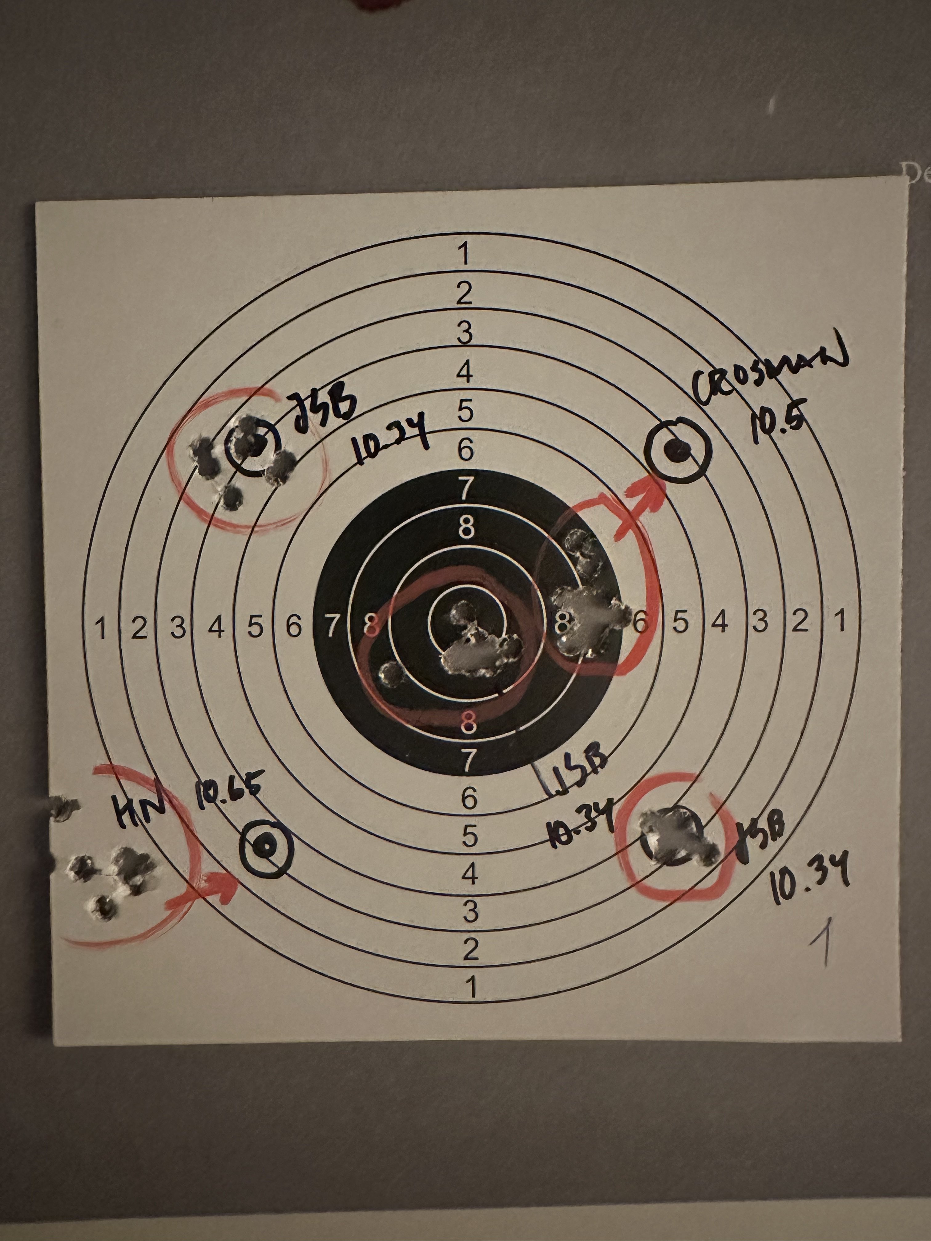

Its an Avenge X Classic synthetic I have. Dont know if the trigger is any different. Also I tried to shoot some groups today. The JSBs 10.34 Diabolo shoots great overall, but the Crosmans 10.5 seem to do well now that I have tightened everything down in the barrel. But both the Crosmans and the HN Barracuda I tested both shot way to the left of the target. Same scope, same distance, same fill. Why is that so?
