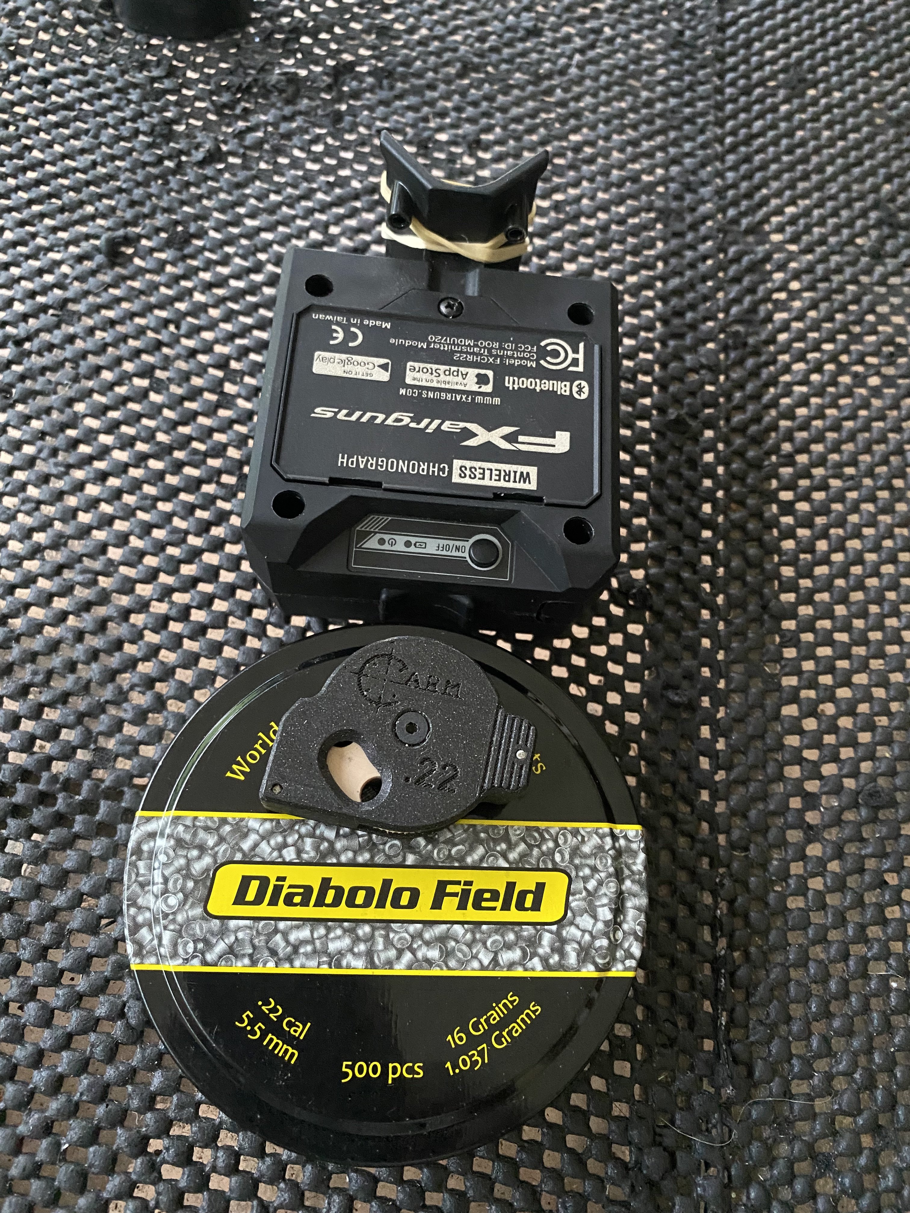

This pic is showing the chronograph and aftermarket magazines I am currently using with my Avenge-X .22 cal airgun.
Thanks for the photos. Yes, spoke with Darko earlier and he said that his only listing for the Avenger SHOULD work for the Avenge X. I told him I needed to confirm 100% before I purchase but looks like you are doing that now. Is this the version with magnetic cover? Already watched that video, thanks for sending.

The Carm mags I am using in my Avenge-X are the smaller ones that only hold 10 pellets, however I had to move the rifle barrel forward a few thousandths in order to make them fit perfectly into the breach. This is a little try and error procedure until you get it right. If you try to use them without moving the barrel at all in the factory location, they can still be used but they fit a little tighter compared to the oem ones (there is a slight tolerance issue between this aftermarket mags and the oem ones but this issue only happens with the new Avenge-X not with the first gen Avengers). Also the side lever becomes a little more stiffer compared to the oem mags that comes standard with the airgun. But after you do this very simple mod you’re still able to use the high capacity 16 shots oem mags along with the aftermarket Carm mags but not the smaller 10 shots oem ones because they get a little lose inside the breach after this mod is done. I attach my first gen FX pocket size chronograph underneath the air tube of my Avenge-X with rubber bands.

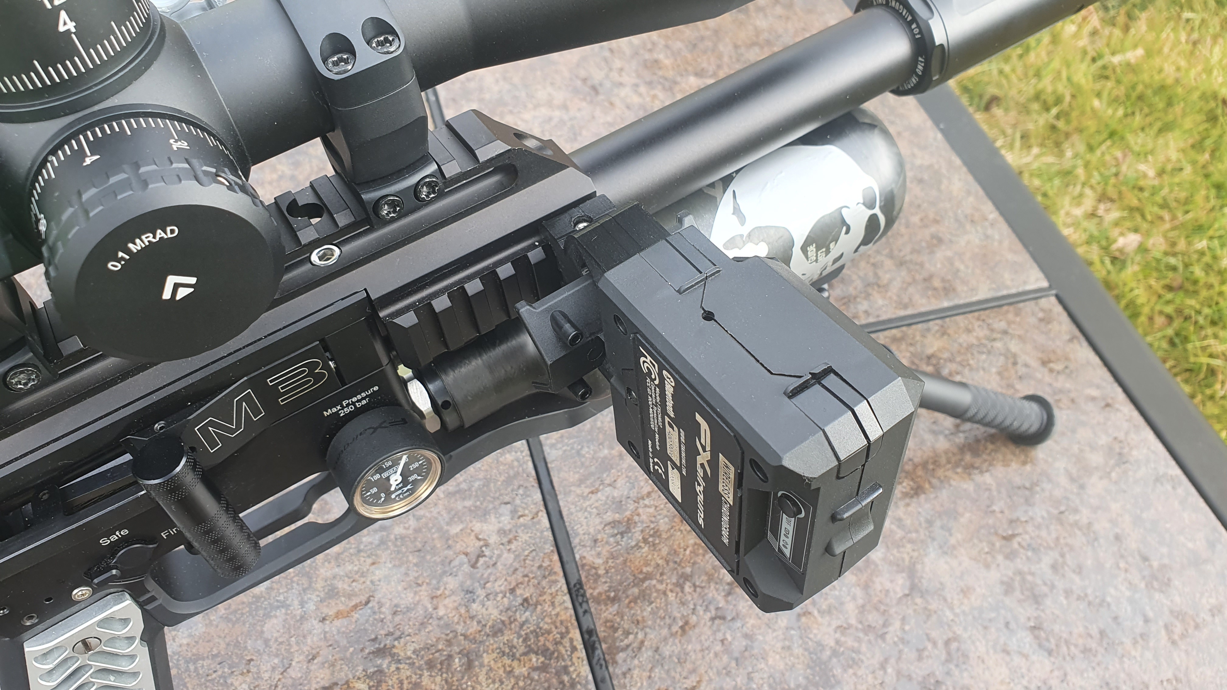

i dont know about everyone else,
but i mount my fx chrono on one of the side rails of my impact and uragan.
always works (y)
