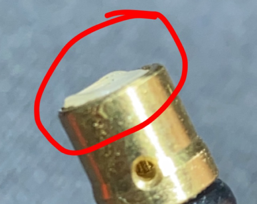

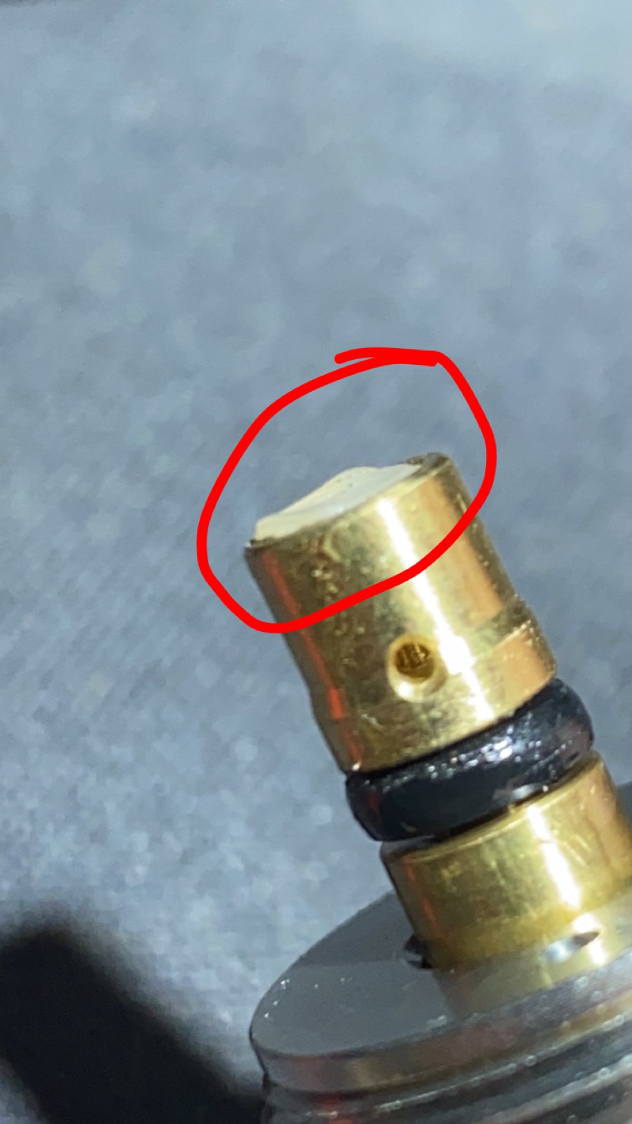

Finally took my reg out to look at it for the first time and believe I found the reason it creeps 400-500 psi in a 10 minute span.I emailed pyramid air to see what they could do, now I’m just waiting for a response Monday. Pictures below.
Trying to figure out what could cause the piston face insert to get so distorted.... All I can think of is factory defect during installation.
Good pictures by the way with decent focus and good lighting. You can tell that that o-ring needs to be replaced because of its flattened profile - no longer circular cross-section. Probably all the other o-rings as well.
Hope they get it fixed for you, looks like you've done some good footwork.

My guess is also factory defect cause the problem has been consistent from the 1st pellet to the 2000th pellet. Never worse never better.
You know, now that I look at that very first photo that shows the face of the seating surface, It appears that the polymer plug may have been glued in place rather than press fit into the socket of the end of the piston. Is that just excess glue on the surface? Perhaps you can just scrape it and very lightly hone it on some 400 grit wet or dry sandpaper and restore a nice flat face.

It’s definitely smooshed plastic lol
