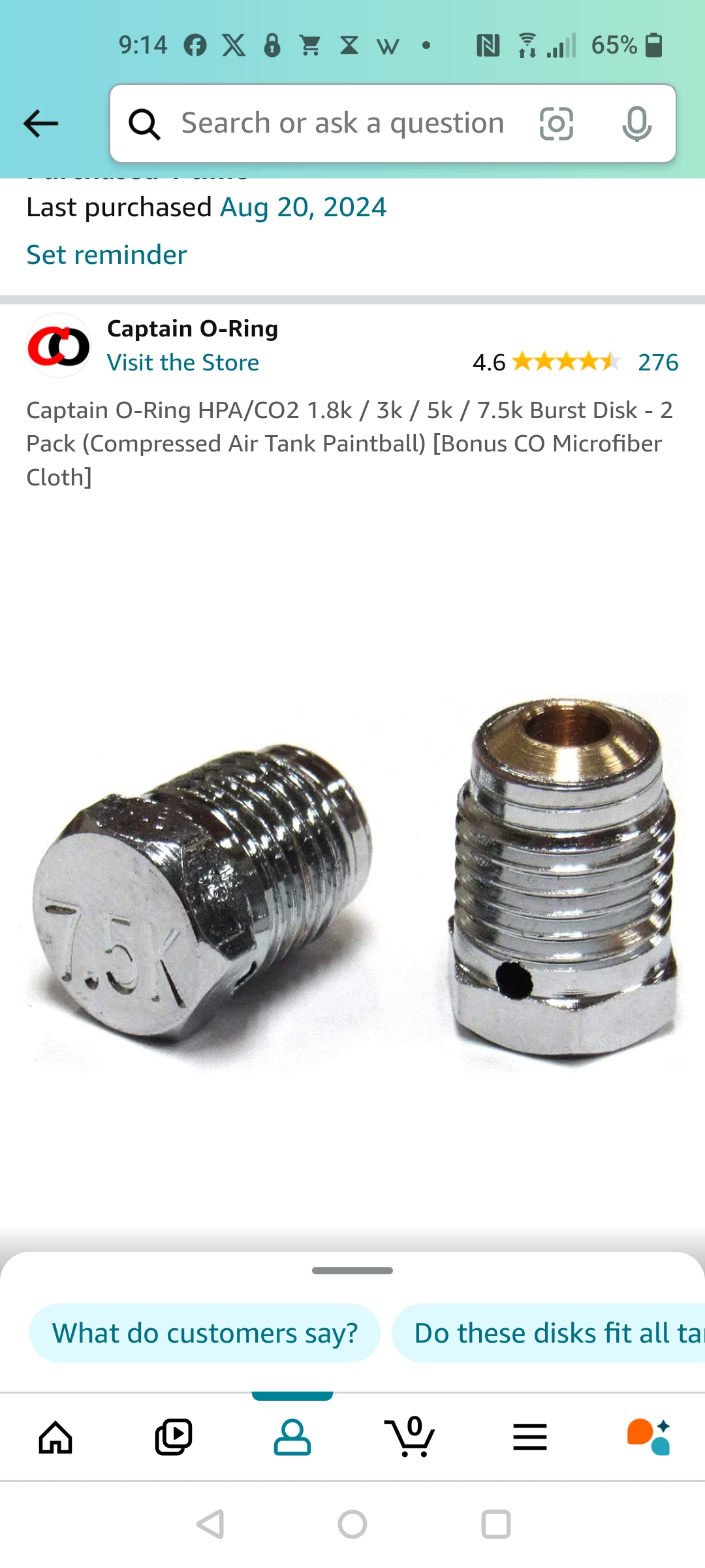

Avenge X burst disk specs, anyone know what the thread size is? I blew it out @ 3800 PSI, kinda disappointed with that. Trying to find a replacement disk assembly. I'm getting these from Amazon but not completely sure if they are going to fit

Thx for the link, I went with the 7.5 simply because I fill from a tank which is never over 4500 PSI. The tank dropps to 3000 and I top it off, as many other people do.
