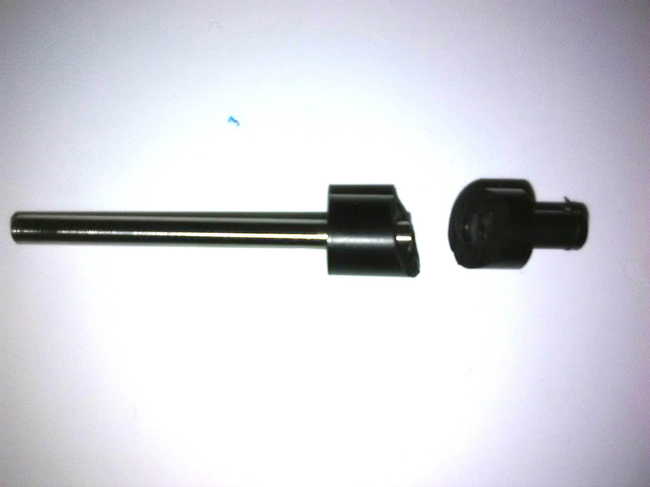

After removing the plug and spring, you will see the turquoise colored valve at the bottom. but it has to be pushed out from the back

This exposes the back of the valve and the valve stem so you can push it out the front.
There is a set screw on the side of the gun that holds the valve in place - it needs to be loosened but you may as well remove it as you will have to look in that hole to be sure the valve is in the correct position before locking it in place.
A very firm push with a dowel rod will push the valve assembly out the front of the gun - including three o-rings, the valve head and stem and the valve seat.
The replacement valve has to go in at the correct angle - the port has to be facing up and equally important, the notch that the screw sets into to hold the valve must be facing exactly sideways for the screw to hold it correctly. I blackened the bottom of the grovoe with a pencil to make it easier to see.
The assembly pushes back into the gun from the front and after pressing it in, you need to look through the screw hole to make sure you see the bottom of the notch and that its square to the screw - it may take a few tries to get it correct but its important the port be straight up - which it will be if the screw is centered on the bottom of the notch.

Its probably worth it to replace the o-rings you encounter as you go but several are very hard to get back in place - I found dried out and deformed o-rings and several that were brittle and broke into pieces while trying to remove them (and were usually the ones leaking as well).
I did have to re-tune my settings after replacing the valve -
Hope that helps - my valve seat did have damage and was one of my leaks - with o-ings replaced and the valve repaired, the gun holds 4300 PSI for days
