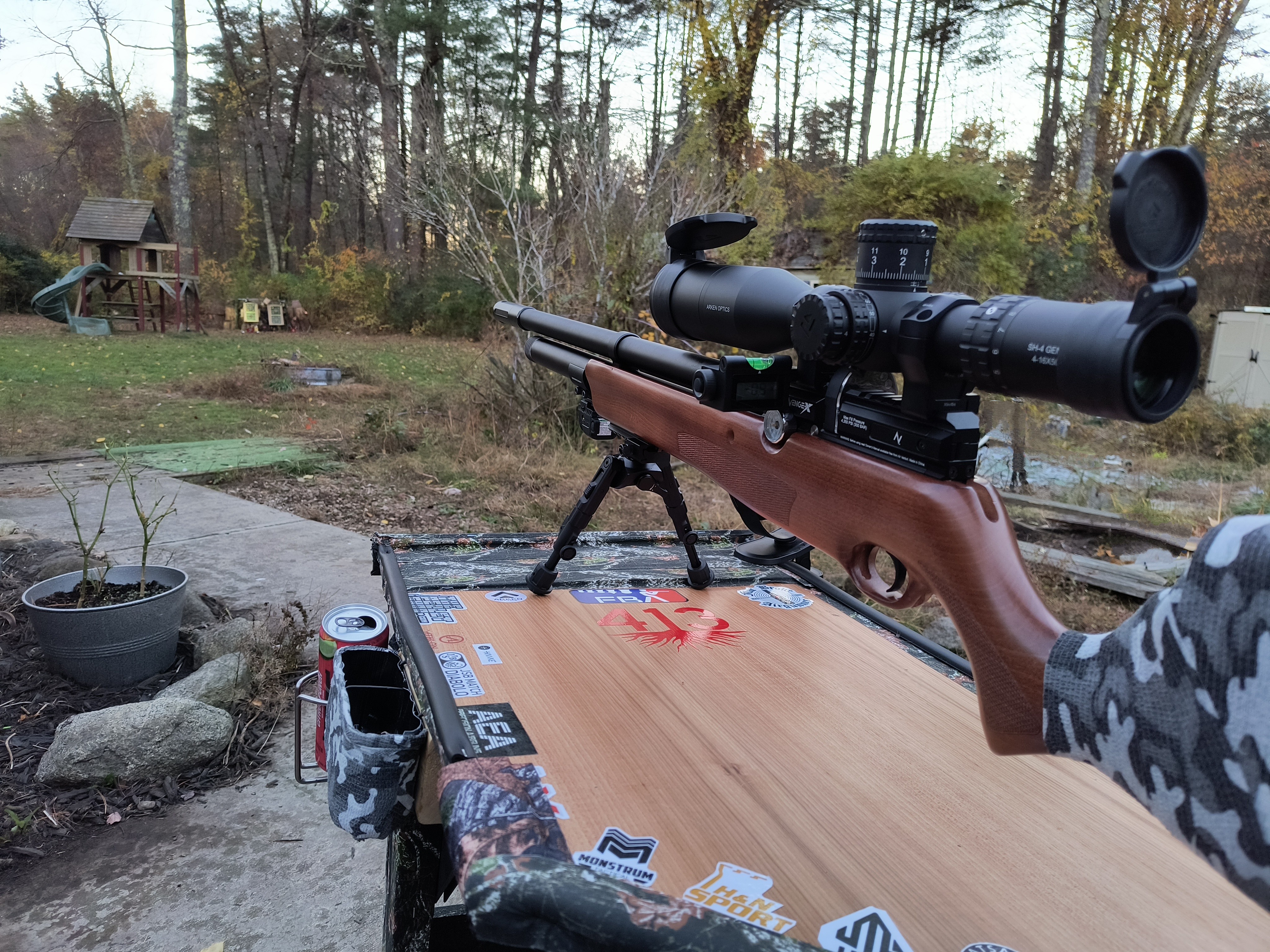

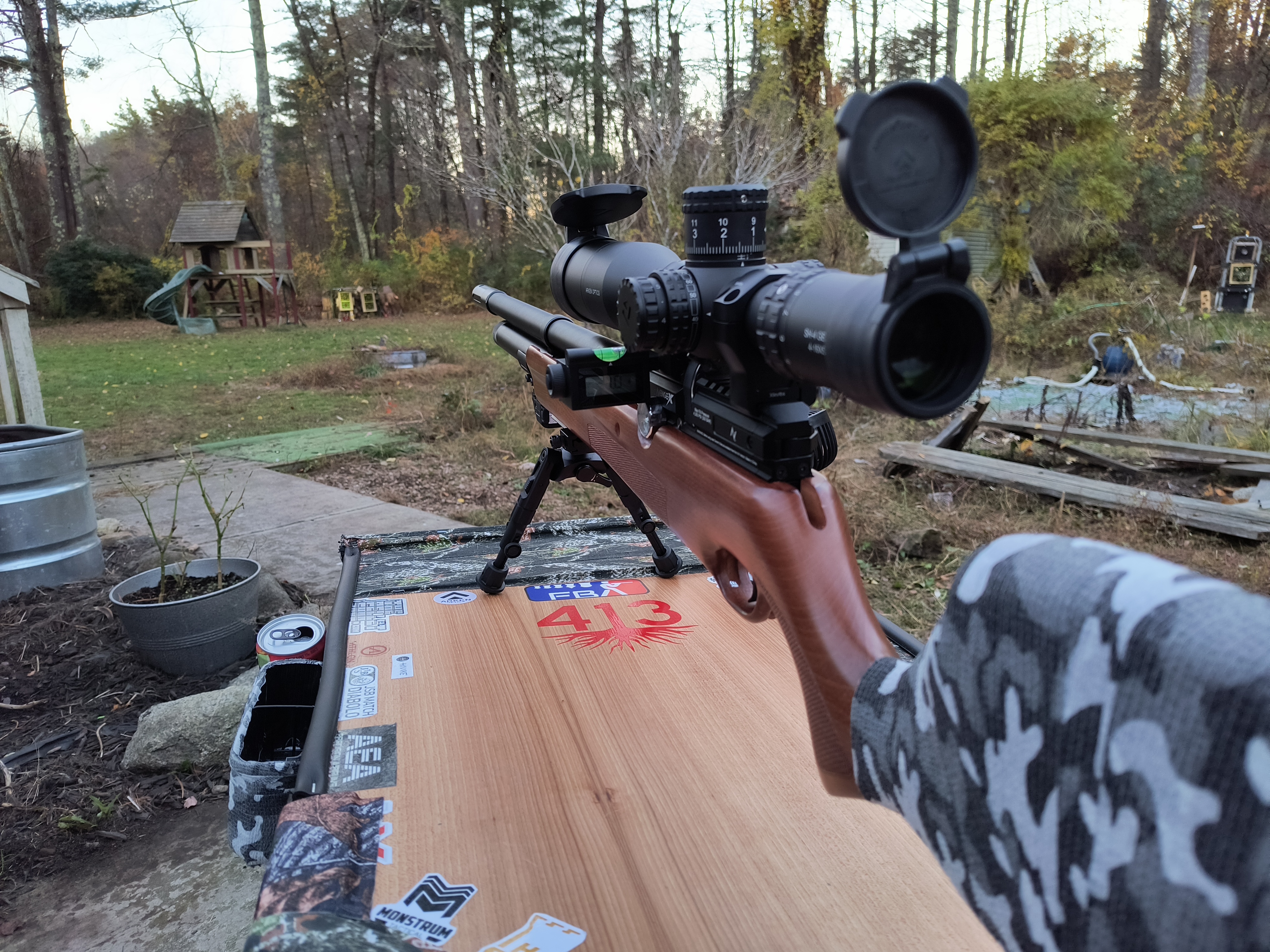

Shooting in my back yard range (42 yds)

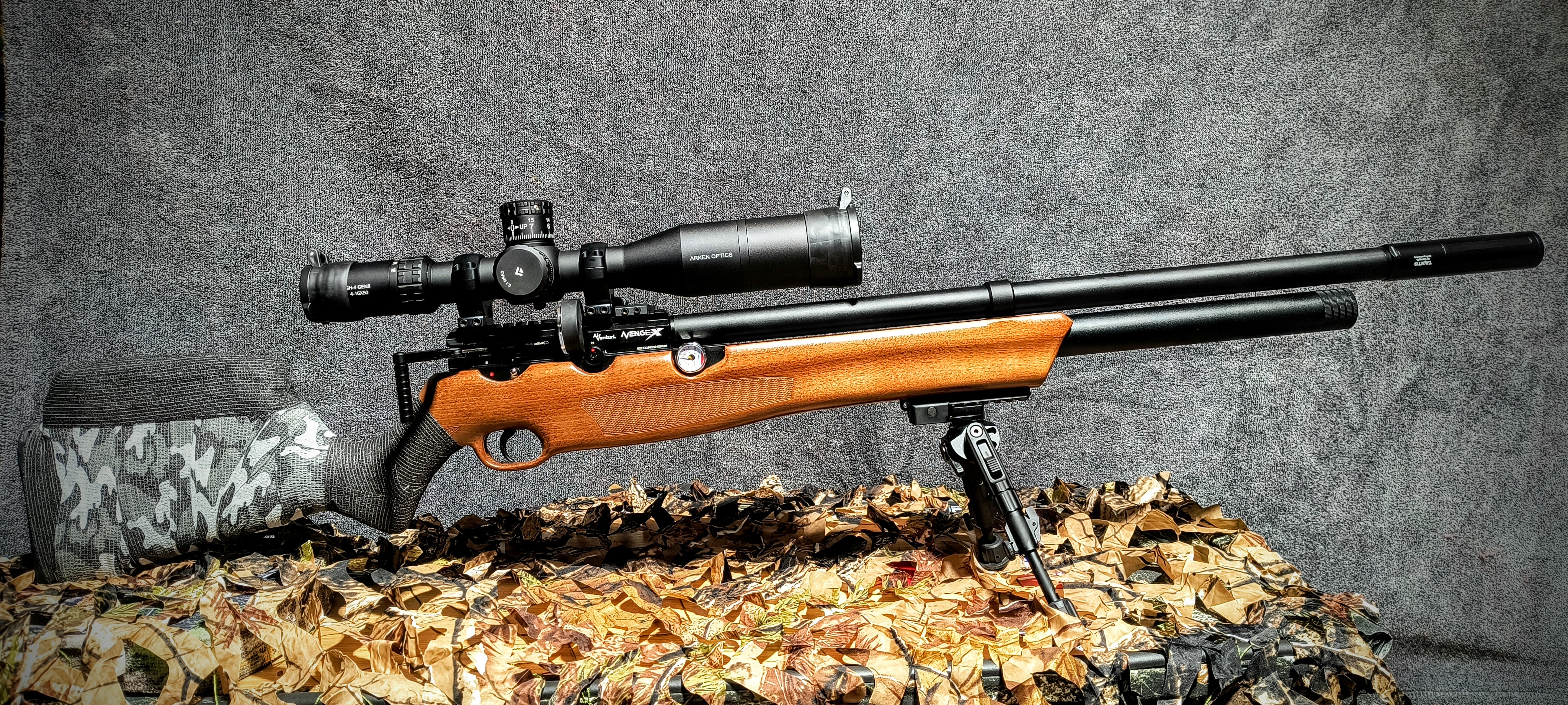

It's raining today so figured I'd take a few photos of my air guns. Here's the beautiful new Avenge X with my improvised cheek riser.

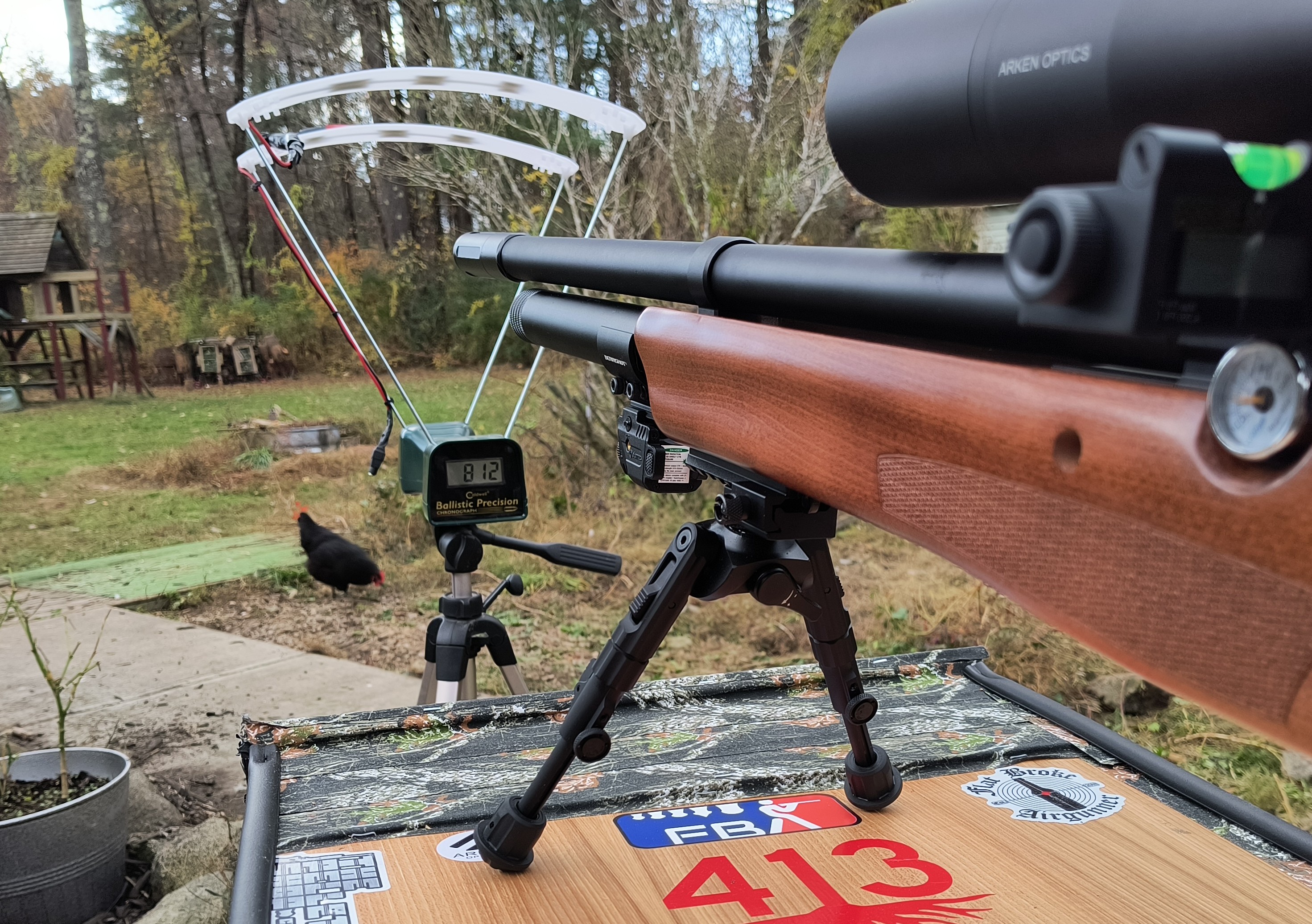

Chronograph showing 812FPS with the JSB Jumbo monster 25.39 grain. (Excuse the chicken photobomb 😂)
