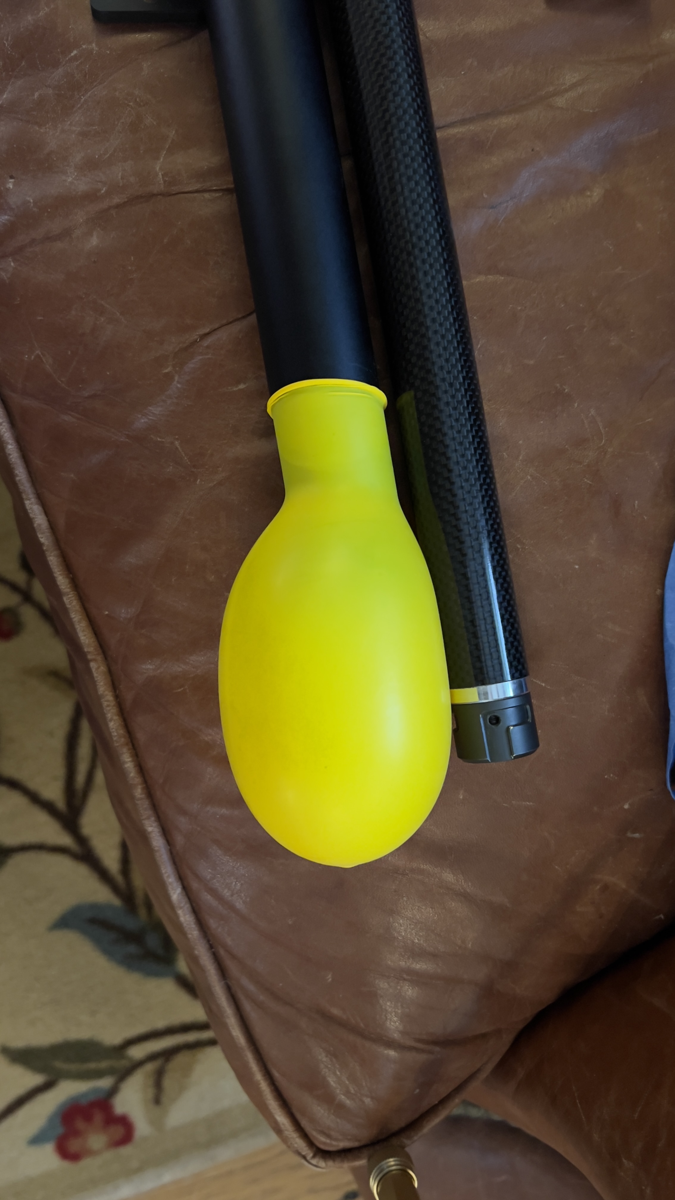

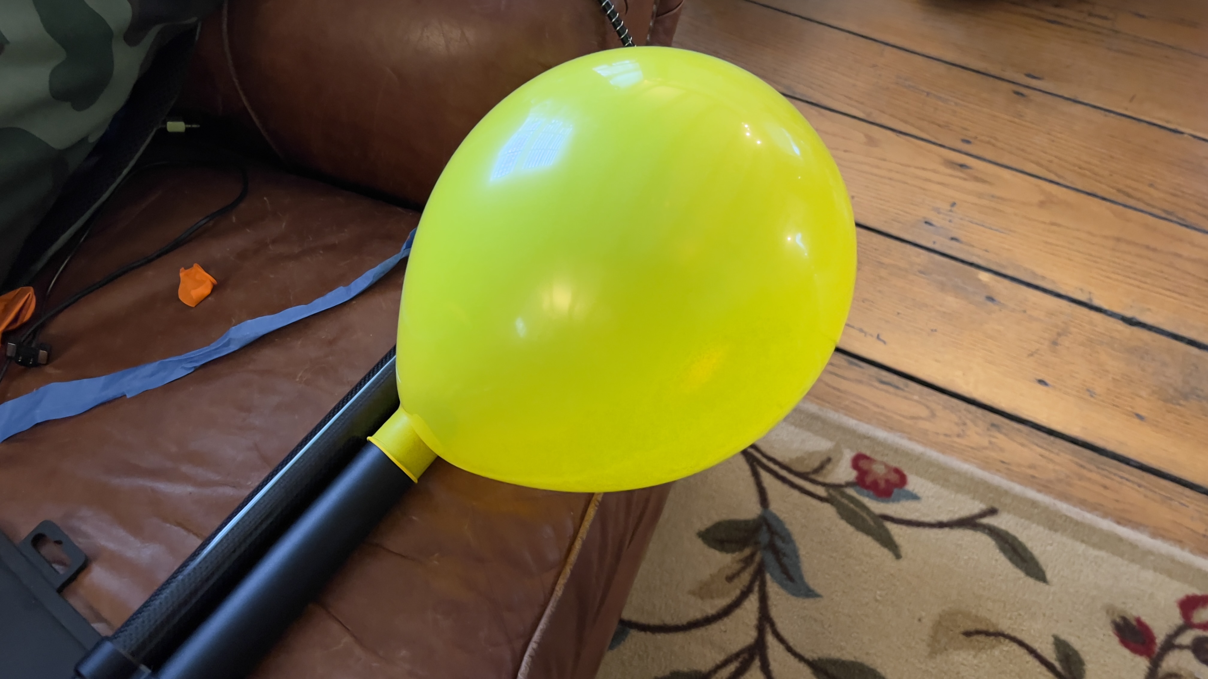

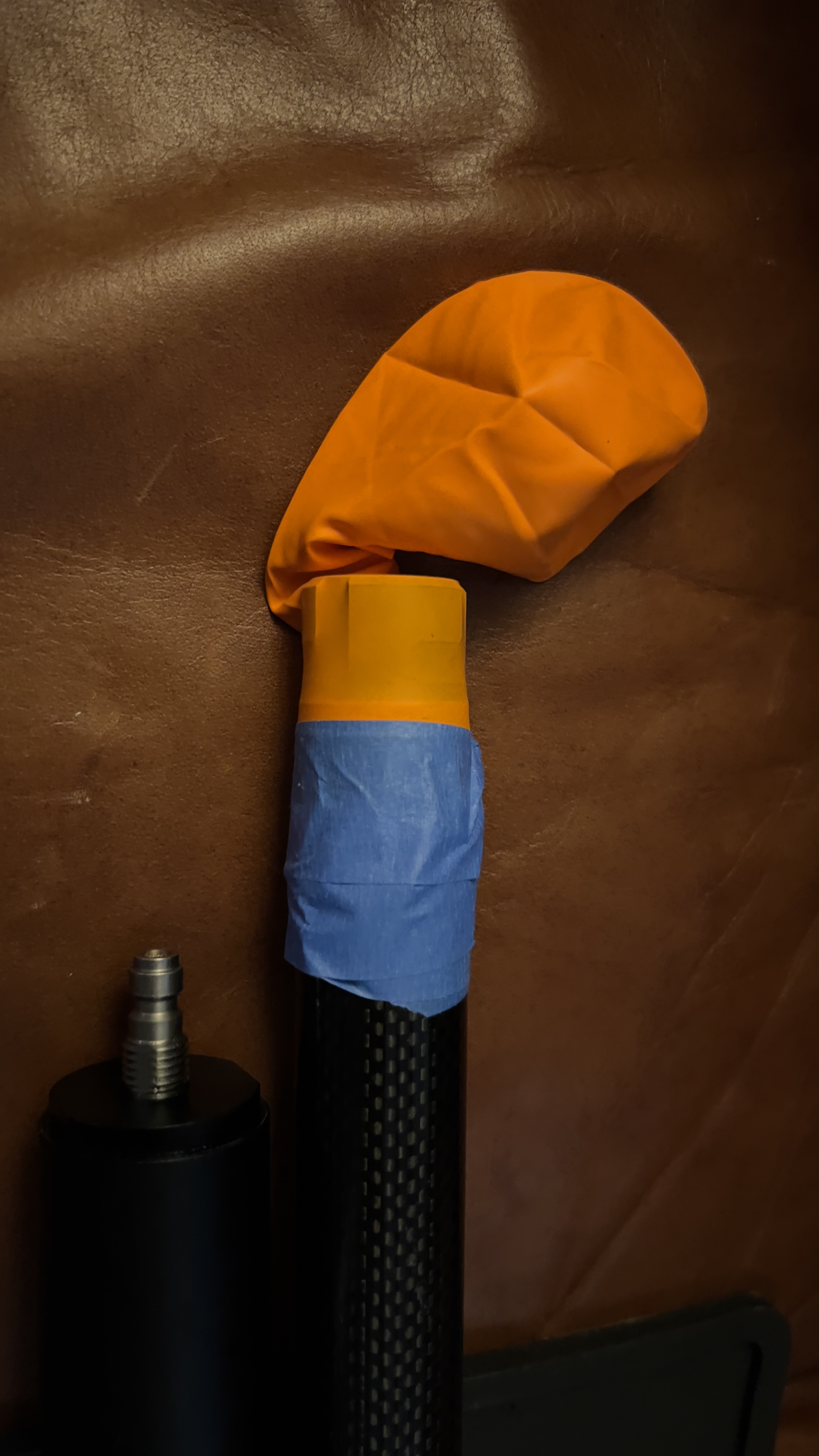

UPDATE:
Turns out to be a leak from the fill probe.
I need to find out how to fix that.
I wish I had put a balloon on it weeks earlier.

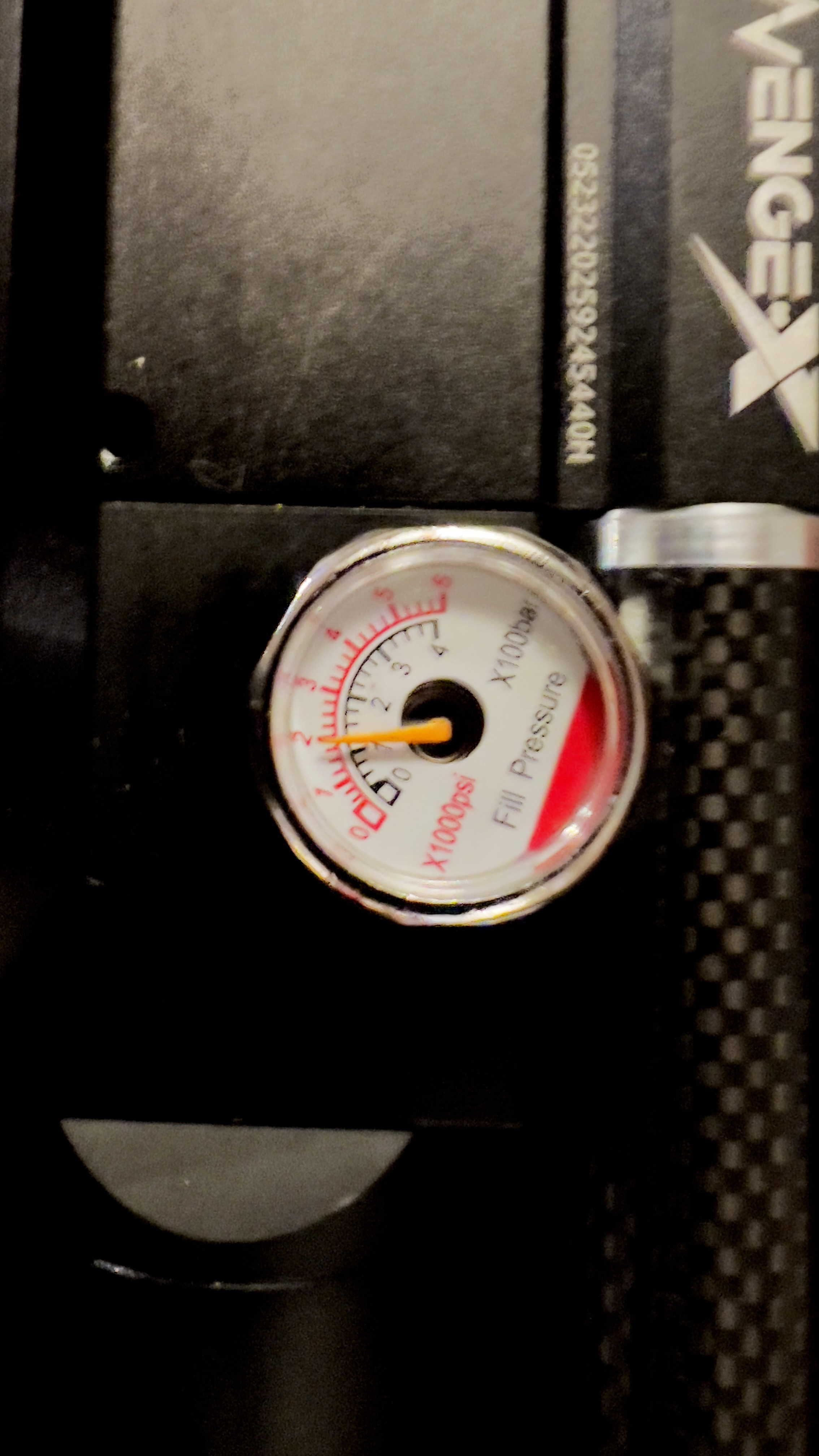

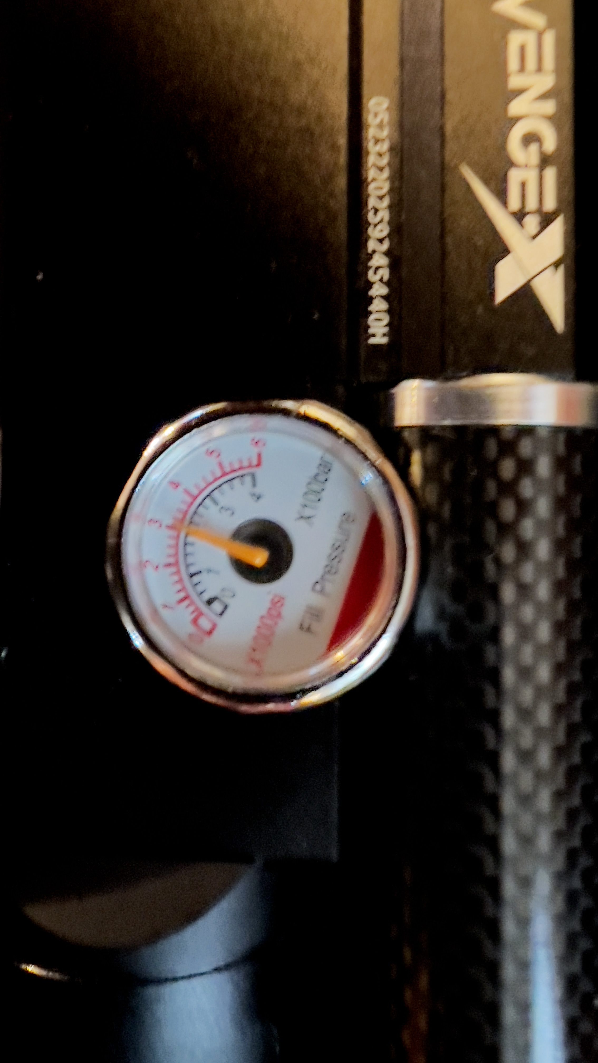

I have had leaks on my Avenge-X since I received them and I've sent them back to Air Venturi for repair or replacement and Air Venturi sent it back allegedly repaired. I've just now found out that they said that they found no leak when I returned the gun to them for repair of course they never told me that they just sent me the gun back as if it were fixed. I've documented the leaks in numerous photographs that are time and date stamped. The leak has progressed to from 4000 to empty in less than an hour and Air Venturi is telling me "find somebody else to help you (me)". Refusing to honor their warranty. I've had great experiences with Air Venturi in the past and found their support Superior but now I just don't understand how they're telling me to take a hike. I'm not going to accept that. This is the second Avenge-X that I received with leaks and could not be resolved. I tried working closely with Pyramyd Air and Air Venturi to find and fix leak to no avail. I even asked them to sell me a new block or a complete action and they said they don't sell those.
Soaping it down all over failed to reveal any bubbles. The Avenge-X is unusable as it now leaks from 4000 psi to 0 in less than an hour. More like 30 minutes. Nothing audible.
The time and date stamps on the images show the progression of the leak.

If it leaks from the base of the fitting where it threads into the tube, then it needs tightening or maybe some teflon tape. If it leaks from the end of the fitting then its the oring not seating right inside of it. The oring may be distorted or have a little debris on the seat. You could take the fitting apart and clean/inspect it, or replace the oring.

That is a super easy fix actually. First just try adding some silicone oil into the fill port and filling it back up. This often will do the trick. If not then you can take it out when the gun is empty and replace the tiny oring inside. THEN WHEN NO LEAK ….(if it were me )…..I’d sell it and never ever never ever buy another AV product again.
