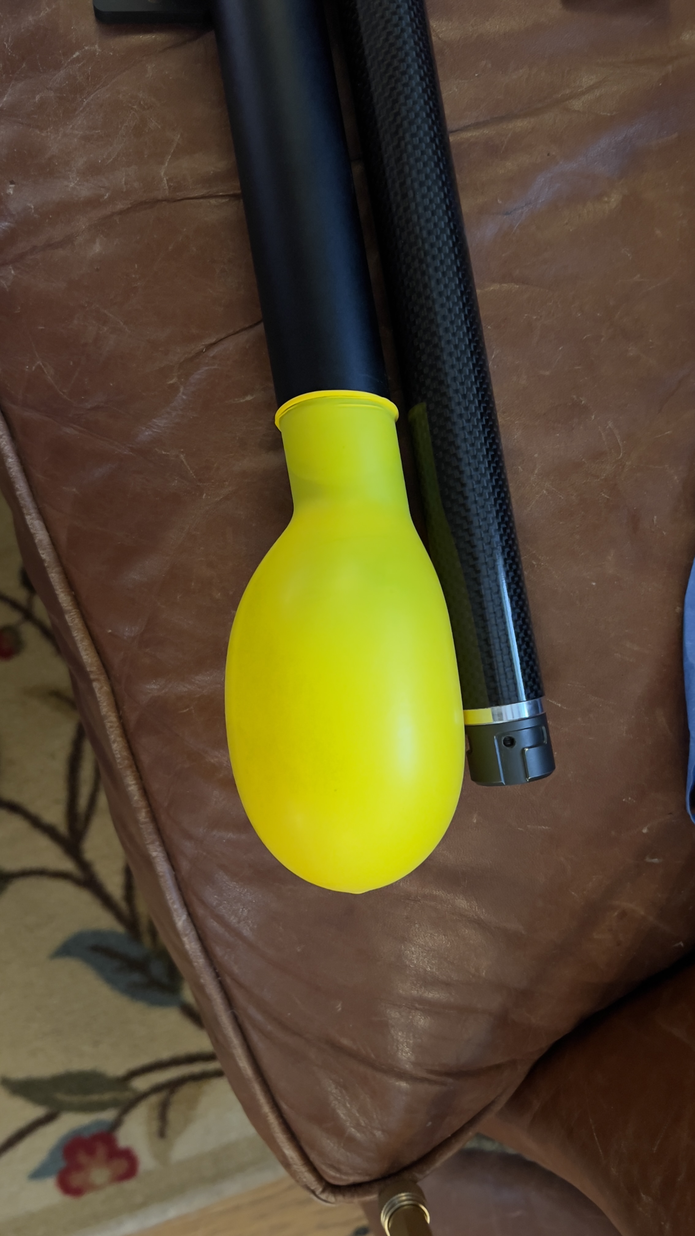

easy fix!I could not hear it but I put a balloon on it and it turned out that it's the Foster View attachment 454805fitting

The leak was in the foster fitting and I'm waiting until Monday to hear what will be done to fix it. I'm confident I won't have any problemDont mind giving guns attention after warranty's are out until then that's what warranty's are for. While I dont mind working on some guns part of the reason I buy new is for the 2-5 warranty manufactures say they will honor.

Hey thank you for your lesson. Of course I tightened the foster fitting which did not solve the problem. It's simple the PCP is under warranty and it's Air Venturi's job to repair it or replace it. I told him if it's a matter of a new foster fitting or a new air tube did you send me the items and I'll fix it. Your response was "Find someone else to help you fix your gun". And I can't say that I am "pissed off" how disappointing I've been getting the runaround for months on this. Fortunately somebody on Facebook told me to put the balloon over the air tube which for some reason I never thought of doing that and when I did I found the leak. Air Venturi was no help for several months on this. And it wasn't "a matter of principle". I was simply trying to find the leak and get the parts. Thank you for your helpWith all the time you've spent posting about this & the emotional energy being pissed off you could have fixed it yourself & be having fun shooting. I truly understand it's a matter of principle but if you're sure it's the foster just grab a wrench & cinch it down. I don't remember reading if you said it's leaking THROUGH the foster or AROUND it (threads). Either of those is a really easy fix so why not get on with it? The WORST that could happen is you learn something & hopefully fix the leak. It's not like having to tear into the internals. You can buy a 1/8" male foster w/check valve for around $10 if you want to replace it or have a spare.
