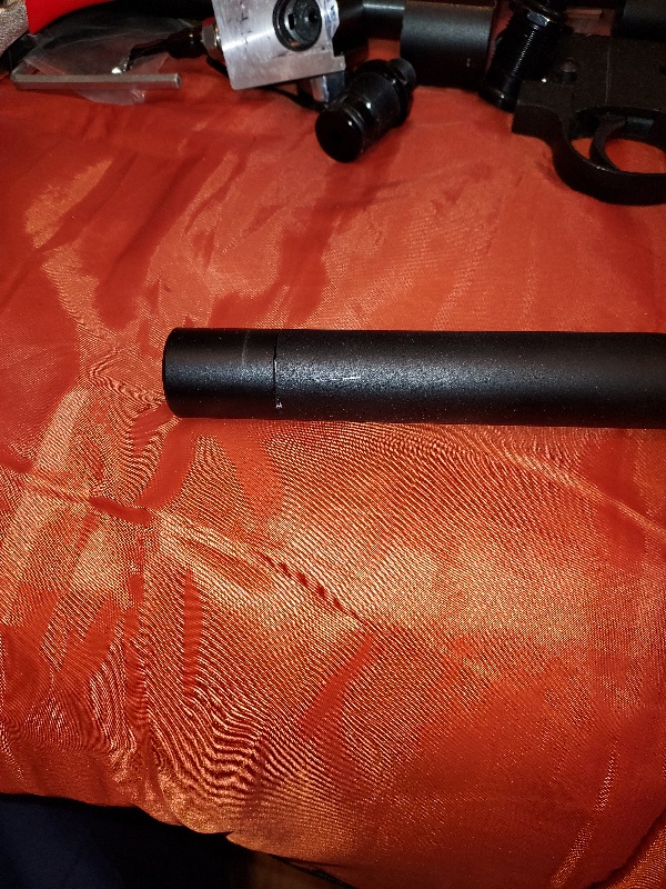

Air Venturi Avenge-X leaks from day one even replacement leaks. Air Venturi refused to fix

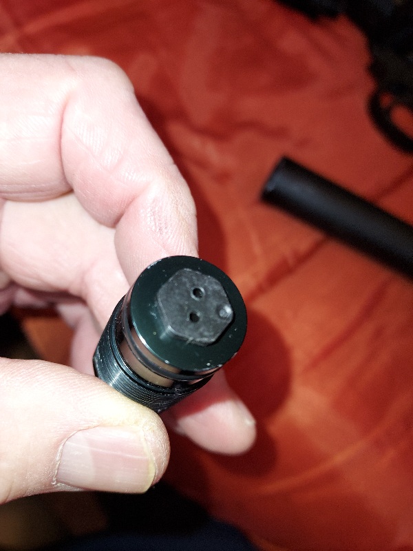

Update: Reason for large leak discovered

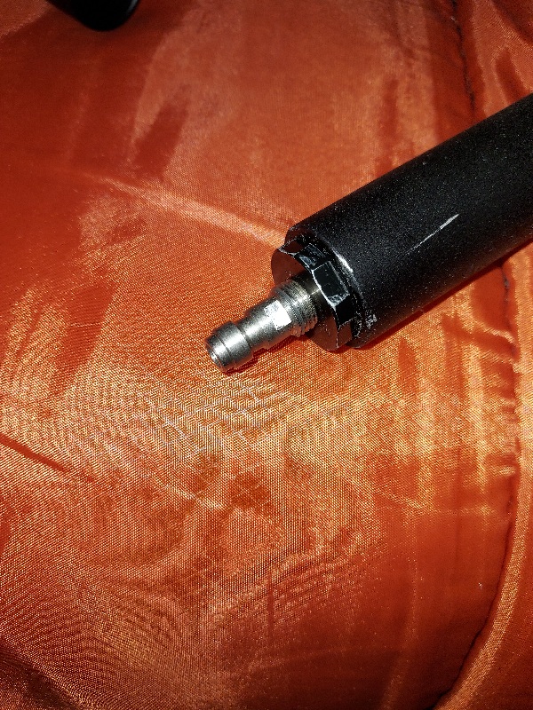

Update on "large leak": The non-return air screw came loose from back of foster fitting. I've asked Air Venturi to send me new long air tube end cap with the foster fitting and screw properly attached.
Another update: Air Venturi sent me an entire air tube with fittings, gratis and by 2nd day Air. All's well that ends well.
