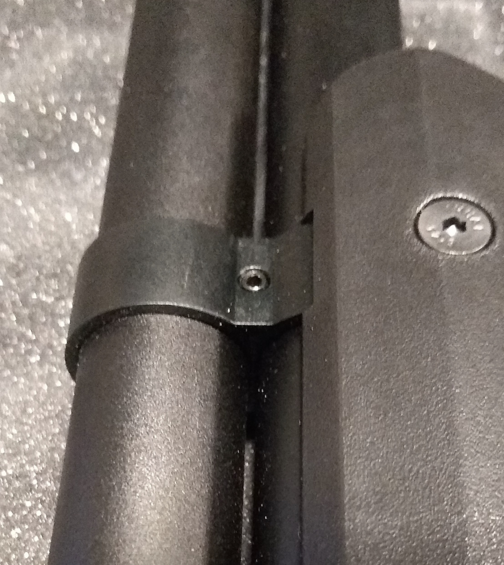

I modified my Avenger barrel band by hacksaw cutting through the tangency point of the 2 diameters, drilling throught the barrel band at that point and adding a modified clamp screw to simultaneously clamp both tubes together. Barrel Band Mod.jpegBarrel Band Mod 1.JPG
