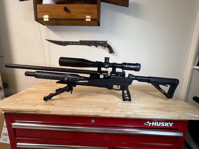

As a matter of fact you will see I treated it to a few "Upgrades" in the pic below.
I hope this helps any future buyer....
