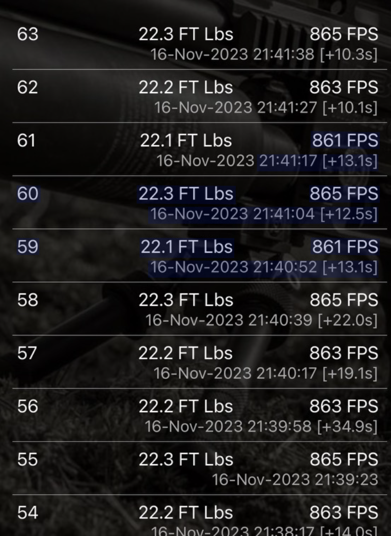

Well gentlemen, I think I just completed my first successful tune. 1800psi reg, 177 13.43gr, ~863 fps. Max velocity at that reg was around 900 so using the 5-7% rule I aimed for 864. This is pretty fun! Now to see how it groups because I did this tuning indoors shooting 2 feet away at ballistics gel (thank god tomorrow is Friday).

p.s. - does anybody know how to get the damn FX pocket chronograph to not miss shots??
No experience with the FX chronograph but the $20 alibaba ones almost never miss shots. Congratulations on your successful tune.
I've been messing with tunes of my 177 caliber P35. Very different gun. It's hammer spring was too much so it got shortened. But it doesn't like the velocity to go even 5% below the peak. I shot 2 5 shot groups as I gradually backed off on the hammer spring. My peak on H&N Baracuda Match 10.6s was about 900 fps (reg is about 130 bar (no gauge) which is about 1900 psi). Barrel is only 450mm. I am not sure yet where the best accuracy is but 850 fps (6% below) was too much - groups opened up noticably. Groups from 865 fps to 885 fps are pretty similar. I need to investigate further. But the whole point of this comment is I think it is worthwhile checking accuracy before deciding on how much under peak velocity you want to use. You may find going a little outside the "5-7%" shoots better. It is still efficient with this sort of tune.

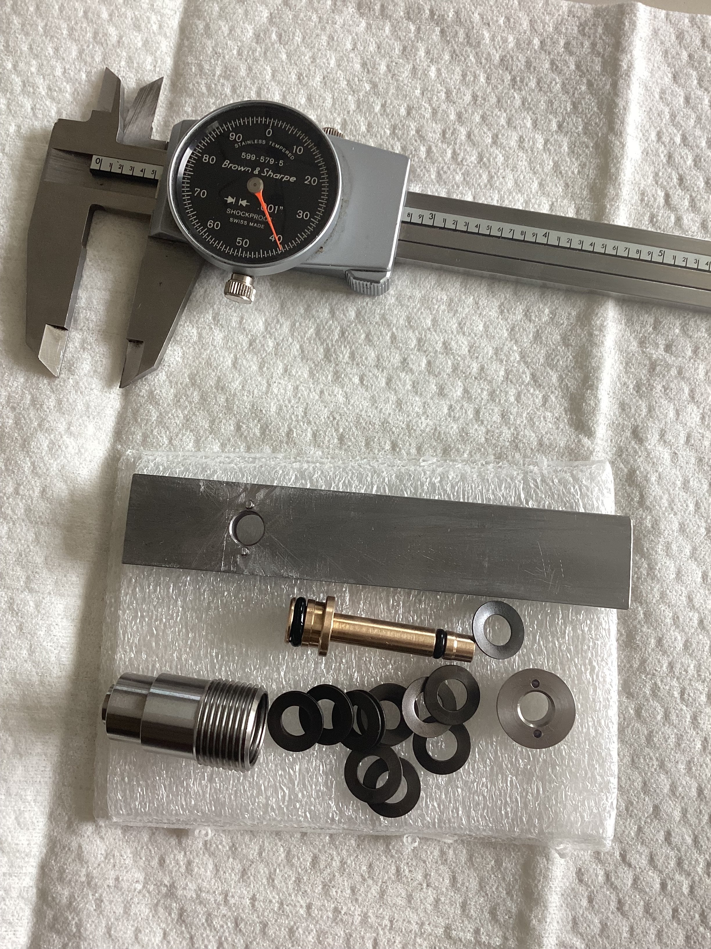

I saw you mentioned “changing washers”. All mine fell in my hand when disassembling, could you help me with the order of washer stack to get me back shooting? appr it very much. Hankiam avenge - x
So I have several new regs that I purchased just to have. Two of which are the avenge x stainless steel and dimensions are the same and you can swap between the two types. That's the reason for assuming they are the same internally except older being brass and newer/ avenge x being stainless steel.
Hello Charlie, this my delema, I need to place these 16 washers on correctly. Slipped when disassembling.
This is not official or anything like that just thinking out loud kind of deal. To get 16 washers I would try ))(())(())(())((
This is basically like the original that I posted in the same orientation but everything is double and comes out to 16 washers and the pattern is equal from both sides.
I’ll try that. I noticed that when I try different combinations of course the length can change. So when I assemble the threaded cap on washers contact cap after turned(threaded) in certain distance. wondering if there’s a certain preload on springs.
