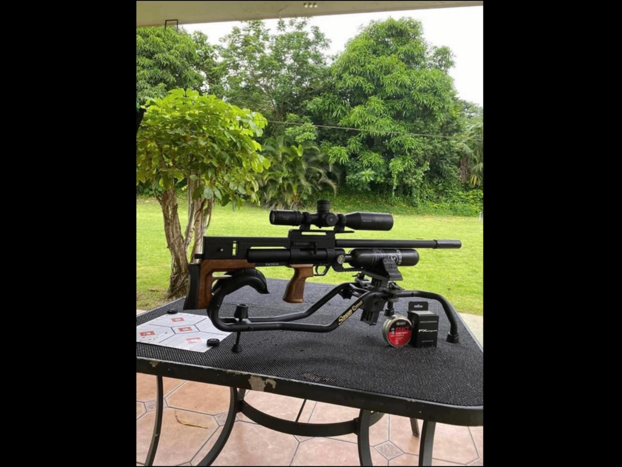

Today I received the new member of the family, another Avenge-X .25 cal. I removed the scope of my other Avenge-X .22 and put it on in this one since the new Arken SH-4 scope I bought still remain in back order due to the incredible high demand they have. By the way if anyone is planning to use one of this scopes that comes with the bigger 34 mm tube, is a must to use it with the higher Arkens 1.45 mm rings to be able to use it with the high capacity mags, otherwise they will not fit I learned this the hard way. I also borrowed the Hugget snipe standard moderator from my other Avenge-X .25 and put it on this one because the new one is still in transit.
My future plans with this one is to converted to a bottle to increase his autonomy and shot count per fill, (if finally Air Venturi change the shape of the extremely ugly carbon fiber bottle they are offering now…👎). Tomorrow I will start his tunning process to shot exclusively with the heavier JSB 33 grains pellets after I clean his barrel to increase his accuracy and lubricate his probe orings with silicone oil to increase their longevity. The airgun came already completely degassed because I live overseas and the USPS does not allow any pneumatic weapon to come with air. I am planing to use Steve “34 grains 850 tune” but start with the h/s with only one turn at a time until the desired fps speed is reached along with the lowest spread and std as possible, this is the way I usually tune all my airguns with excellent results…👍.

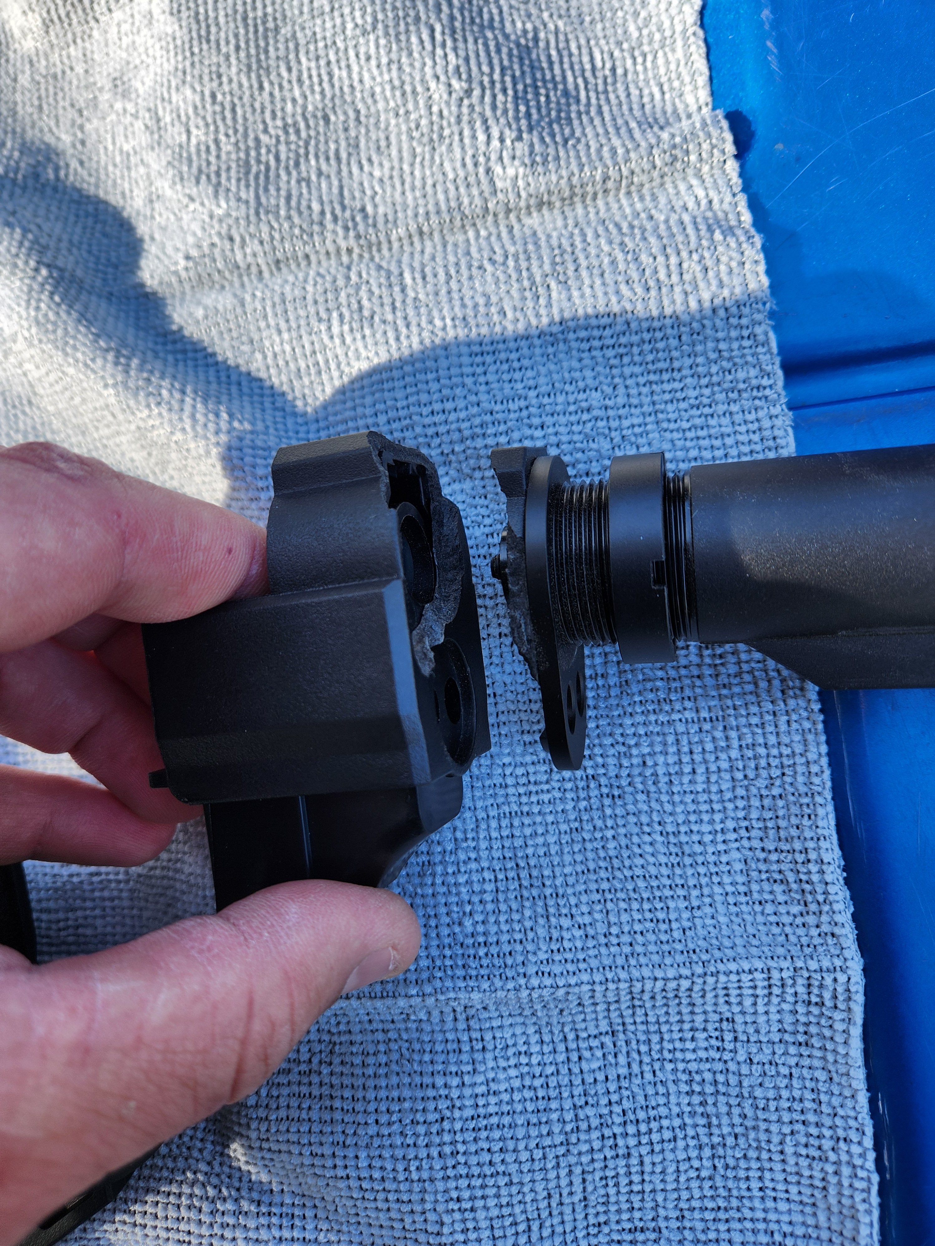

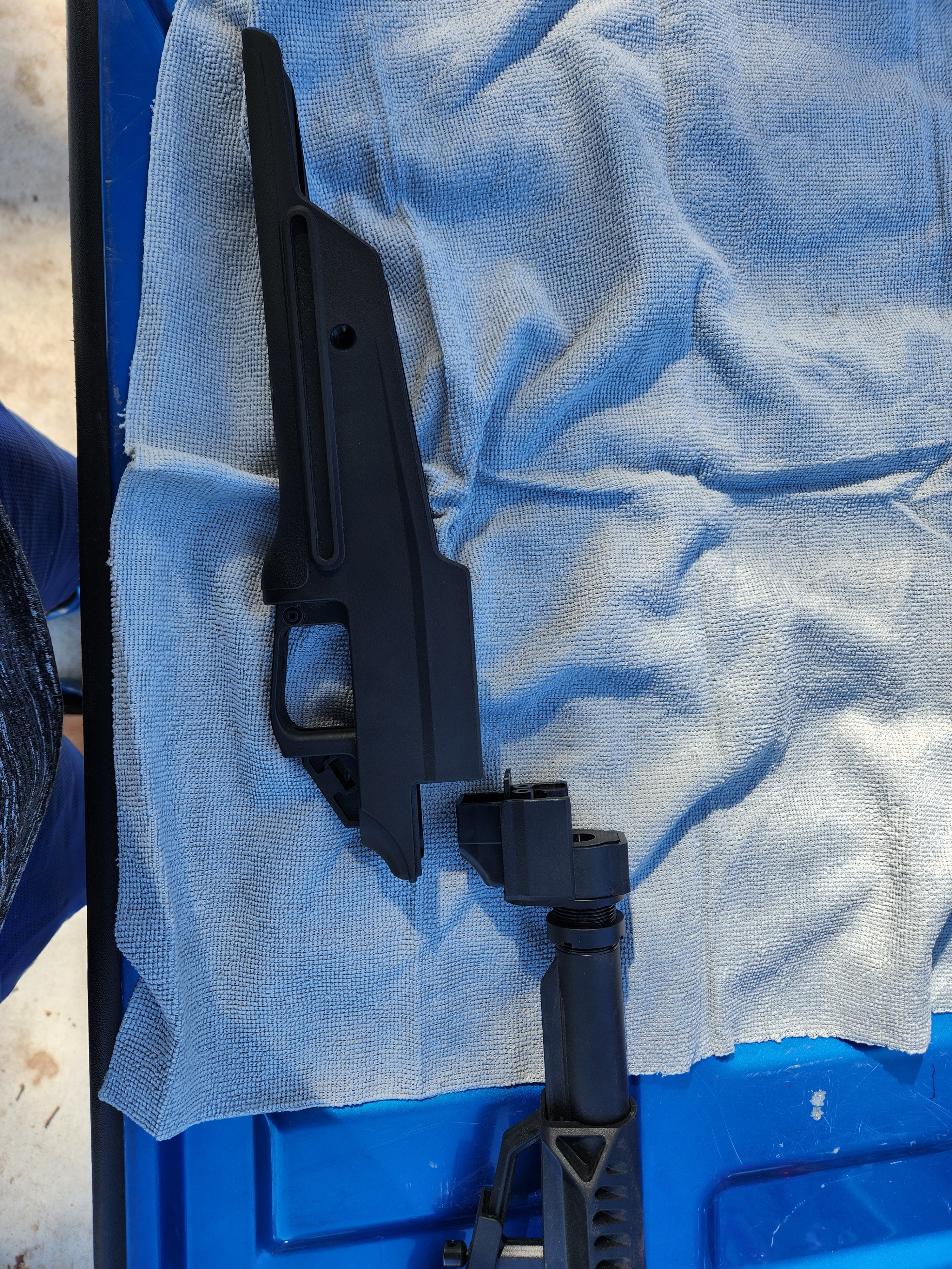

Have a question. I let my cousin inlaw shoot my avenge-x tactical. Well he knocked it off the table smh.. and broke the back end of the stock off . Anyone have a schematic for replacement parts for it?. It broke right where the buffer tube deal connects . I know there supposed to have kits for stocks and all that for all the rifles they make I just cannot find the tactical tube stock anywhere. **Edit I took the stock off and it is a 2 piece design which is good bc that means I should not have to replace the entire thing I assume air venturi will have this part since they have full parts list for the other 2 models ?. Or will I need to send it off to get someone to model it and 3d print me a replacement?.
