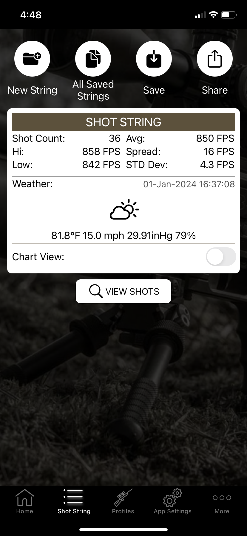

Just to add. Using JSB Exact Jumbo Heavy18.13 and I sort my pellets. Gun came out the box set at 2000 Reg and Hammer turned all the way out. I tried it today at same settings and it is not shooting correctly. Had it turned down to 1800 and 1 turn in at one point. Was shooting 840 to 850 fps. Turned the hammer spring in 1 turn and reg at 2000 today. 56 shots average 863 fps with a spread of 27 fps, 875-848 fps. Gun is shooting consistently as far as speed. Just not consistent on paper. Not sure what the H happened.
