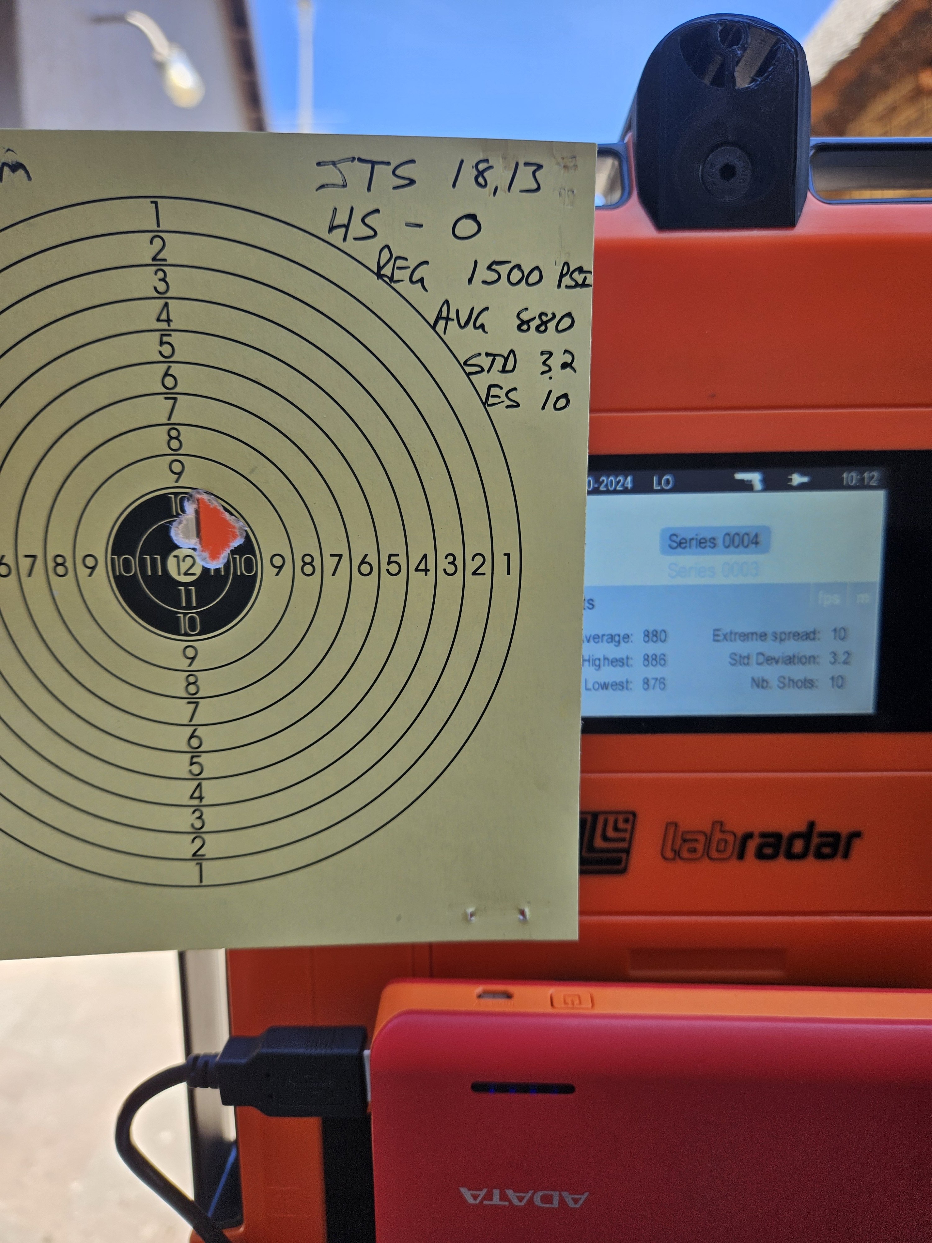

where did you order the snipe from ? im on the fence between the donnyfl yoko and the huggett snipe 1 question i know donnyfl always suggest ordering 1 size up. did you do this with the snipe? i have a .25cal as well so i was wondering if you went with the .22/.25 snipe or the .30cal they sellThis are the current tunes I am using with my Avenge-X .25 cal with the JSB mark II 33.95 grains pellets but with reg set to only 2100 psi. I started at 175 bar with 5 turns to the h/s as suggested by Steve but my airgun was shooting to hot at over 900 fps with this particular tune, so after messing for a while with the h/s I degassed the airgun again and lowered the reg pressure and started all over again, (remember that none of this airguns are alike). I was filling it up to 4000 psi only that’s why the shot count is a little lower as well. Currently the h/s is around 4 1/2 turns in. Later in the day I will keep messing a little more with the h/s with very extra small increments to see if I can achieve the same es and std Steve is showing in this chart (I am retired). I can spend hours shooting my .25 caliber Avenger-X without scaring any of my closest neighbor's chickens, this just goes to show how quiet and backyard friendly my Avengers are with the Hugget snipe moderators even though the shots are passing barely two feets above their heads and the shooting targets are just a few feets behind them. None of our houses have fences. PS I shot a very big iguana that was passing through my yard but couldn’t get an accurate shot in her head because she was moving too fast, and even though the shot penetrated her body near his head she keep running and went to one of my neighbors yard and disappeared.
