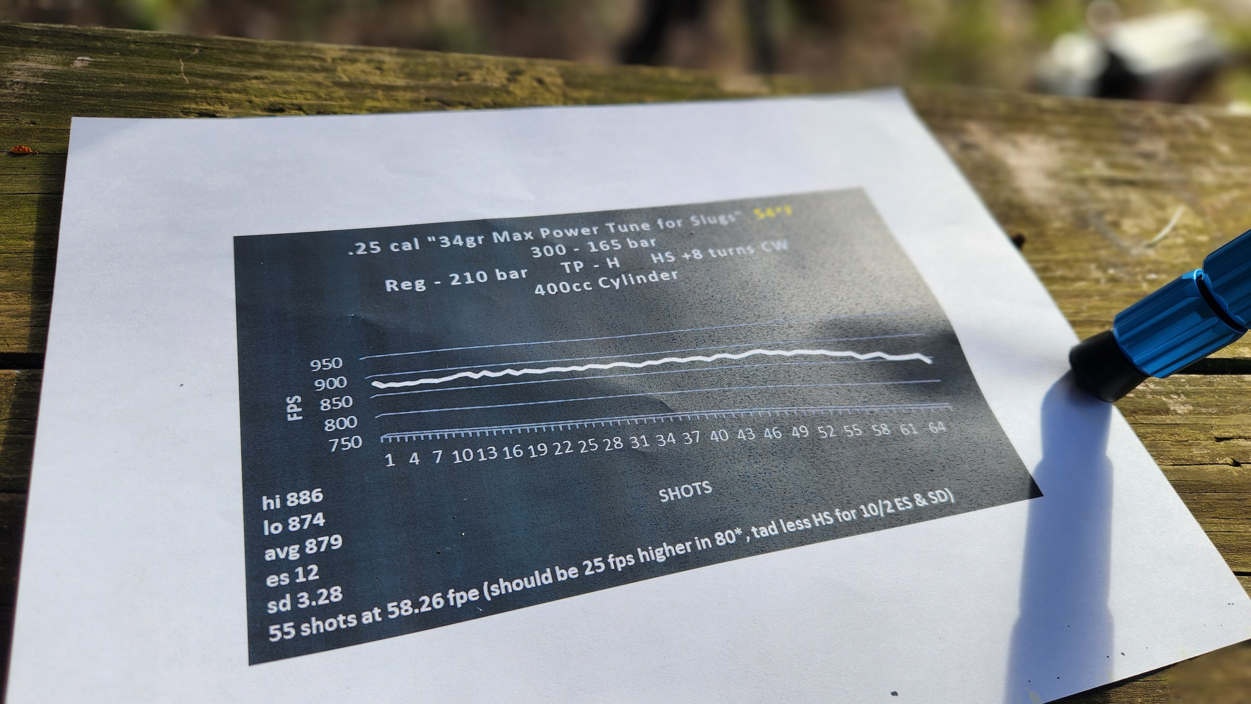

Thanks for these great preludes to your full write-up. I eagerly await more, more more. Quick question concerning the tune charts just published: How are you measuring the HS turns? In your 34 gr tune HS is shown as " HS +5 CW + 2 CW." Please help me to understand your meaning.
Good question, thanks.
This means from full stop counterclockwise, rotate the allen driver 5 full turns clockwise, then add 2 more of the tiniest movements possible, clockwise. The HS is that sensitive to input.
Steve

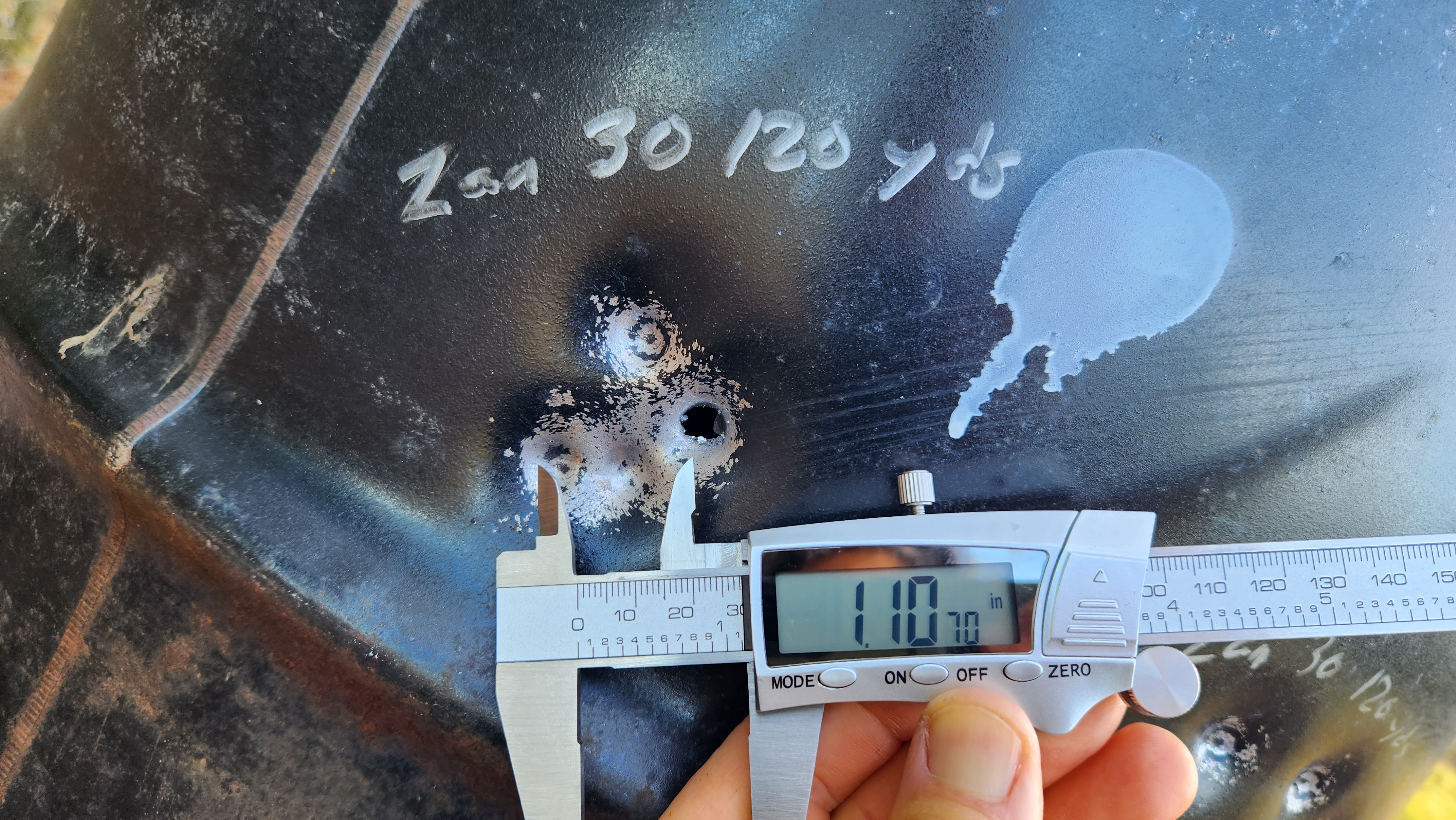

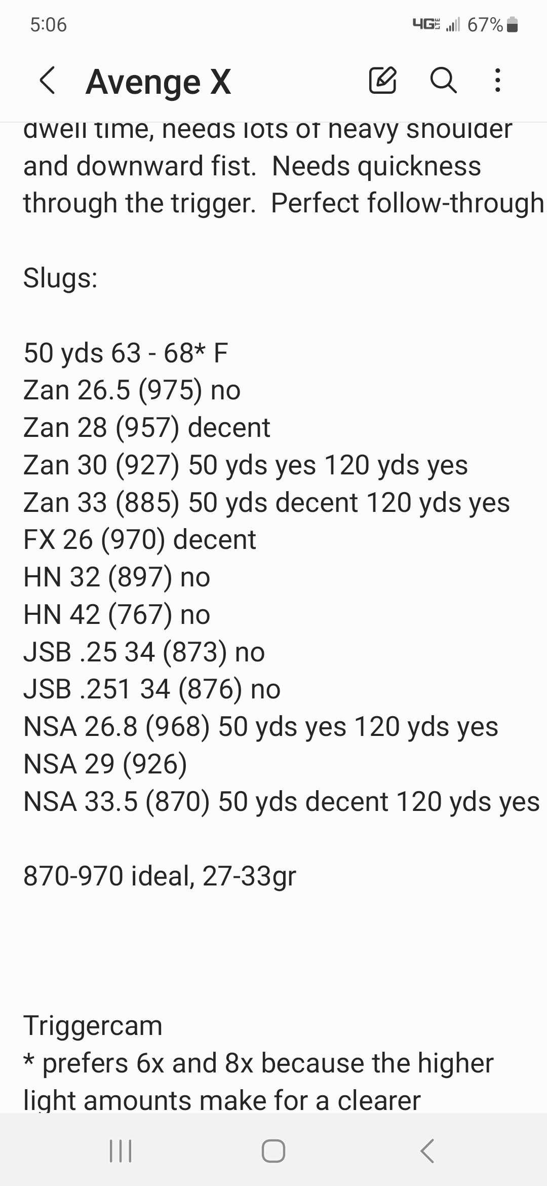

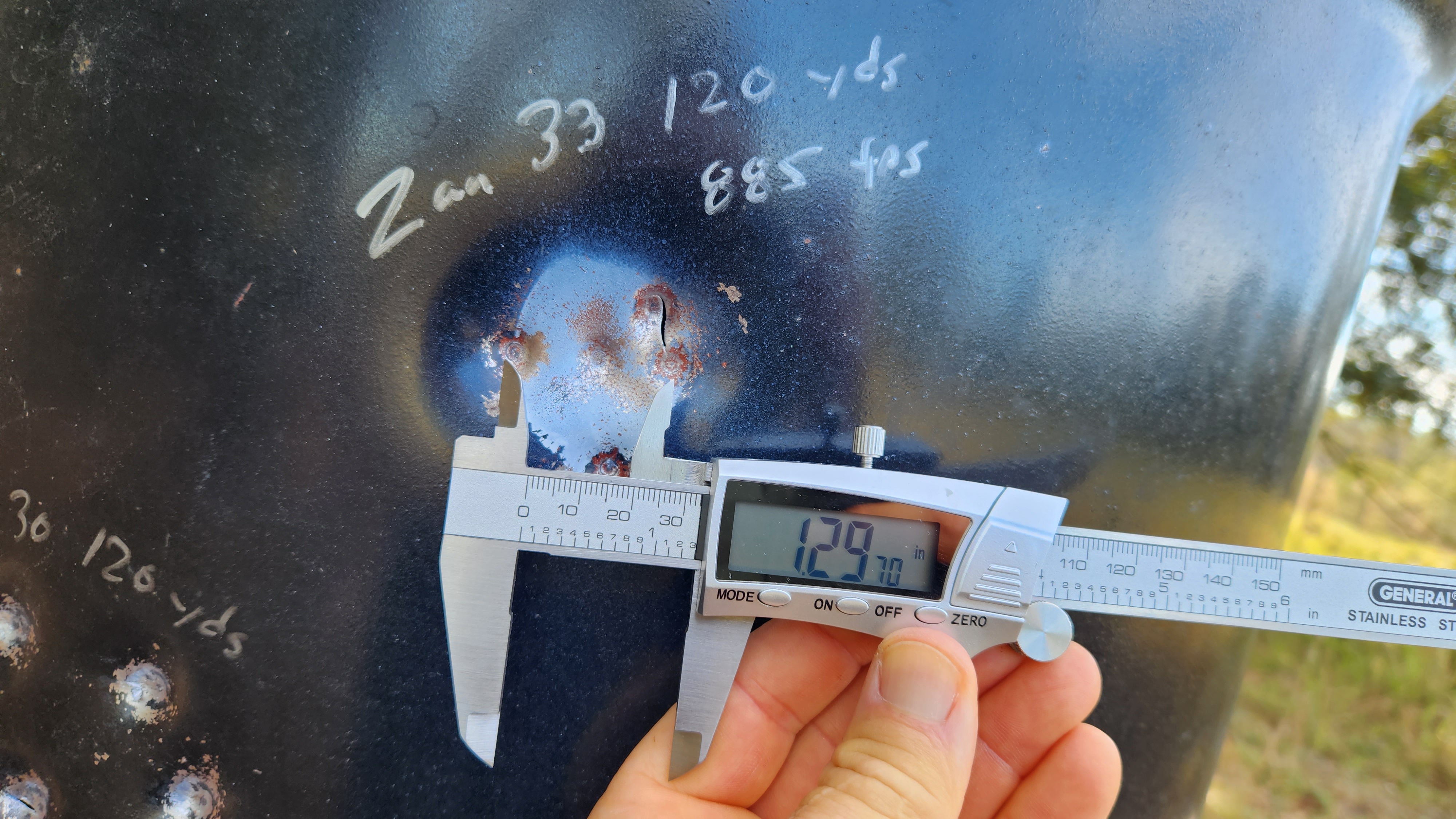

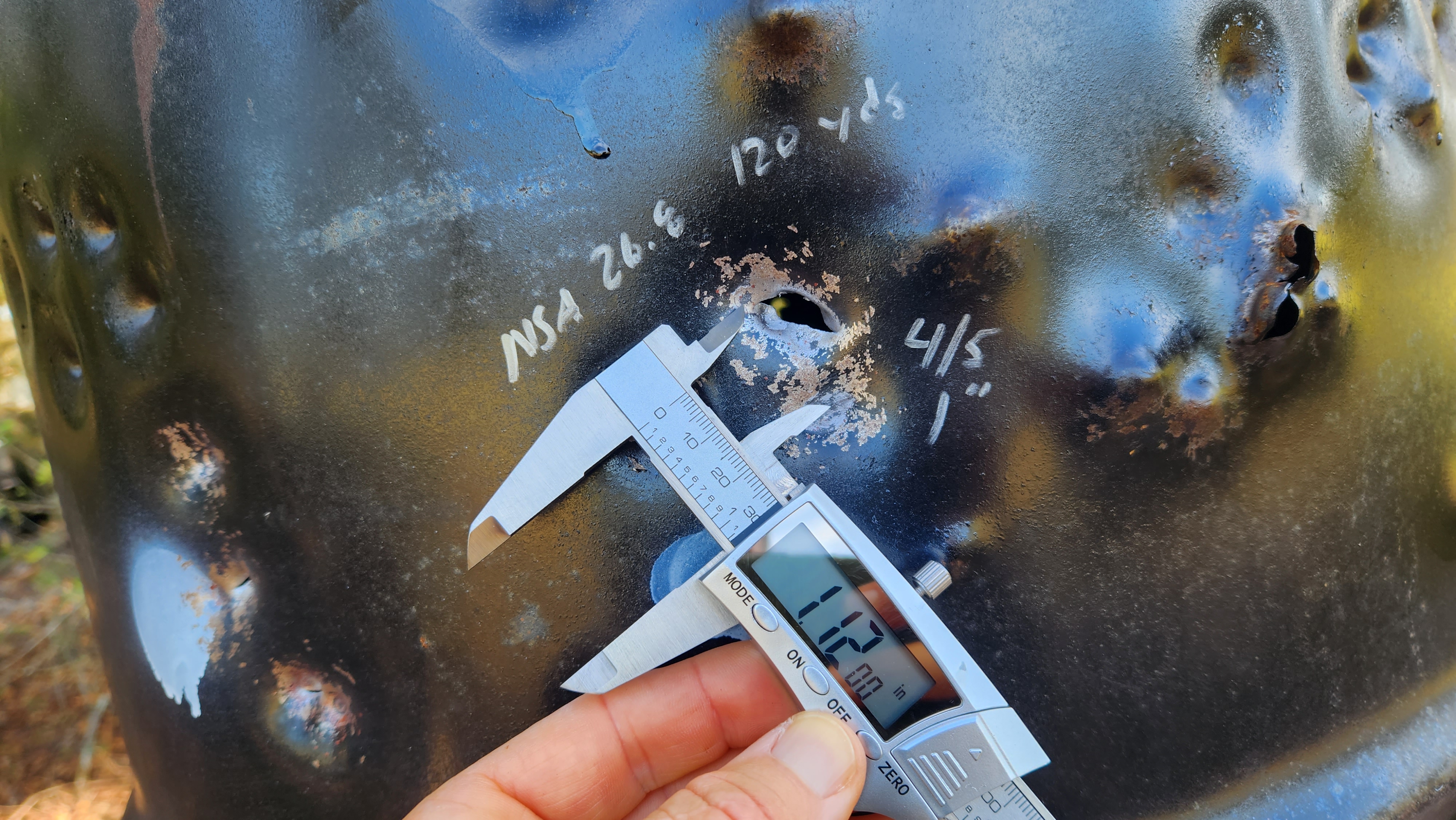

Still learning & filming and updating here as I go. Working on slugs now. Here's some 5 shot groups at 120 yards from today, and what worked with the barrel & max power tune.
Steve
