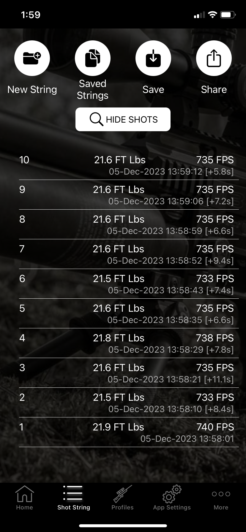

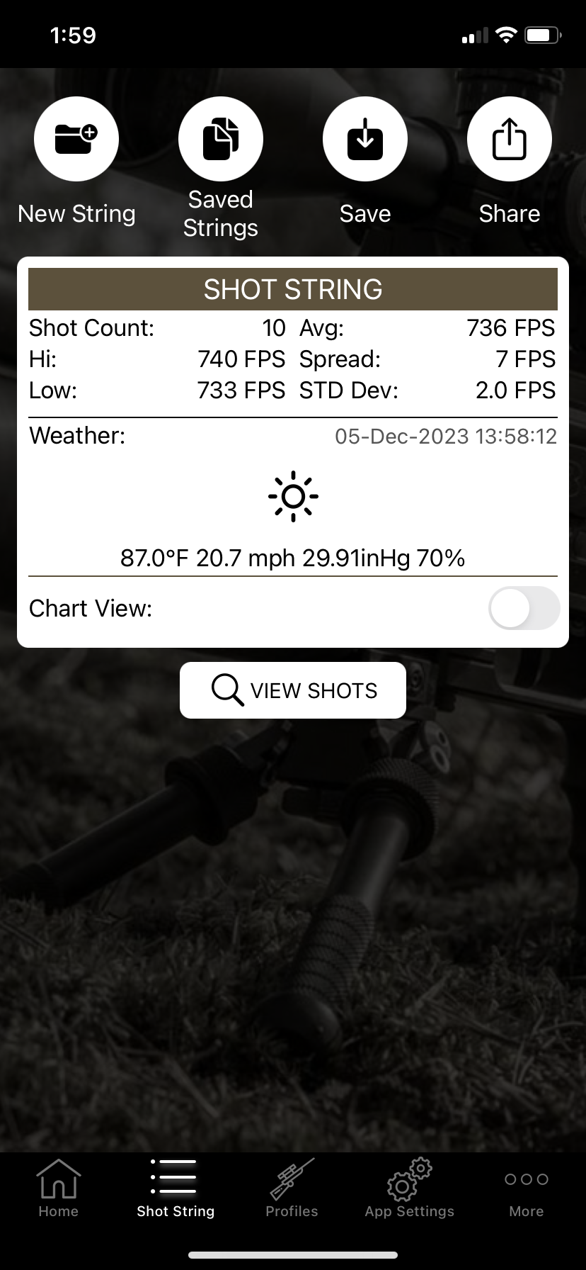

I performed this test already with my new Avenge-X .22 cal with the TP set to high tuned to shot the JSB 18 grains pellets between 870 and 880 fps (I don’t shot with slugs). Then with this same tune without touching anything else set his TP to low and shot a string of 10 rounds with the lighter crosman premier 14 grains pellets and this were the results. If you’re curious about the weather still been in the mid 80 degrees at this time of the year, I live in the Caribbean PR not in the states.
Ray
so it actually shot a bit slower with the low setting and the lighter pellets?? if that's the case and you don't shoot slugs it might probably be a closer tune if you did the jsb redesigned heavy on high and the lighter crossman on low power..

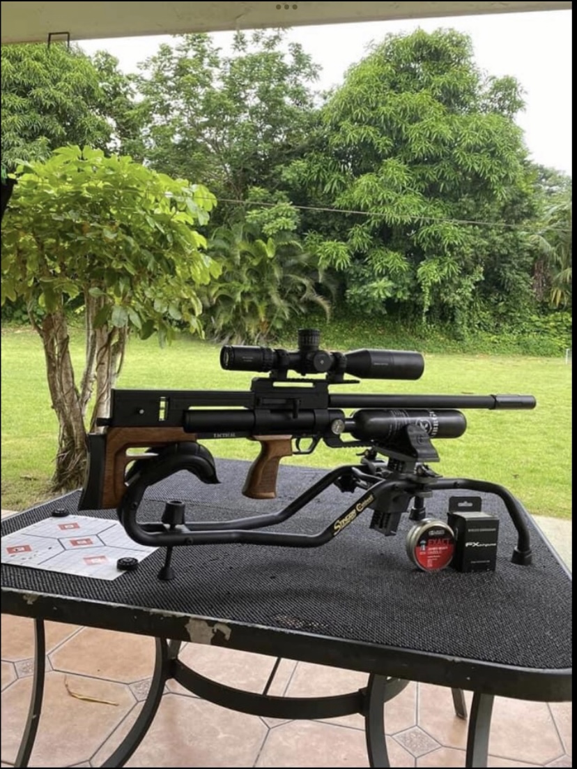

So I took the Avenge-X out back and sighted it in at 50y.
I tested 3 different brands of 18g pellets, and apparently this barrel like the H&N 18’s best.

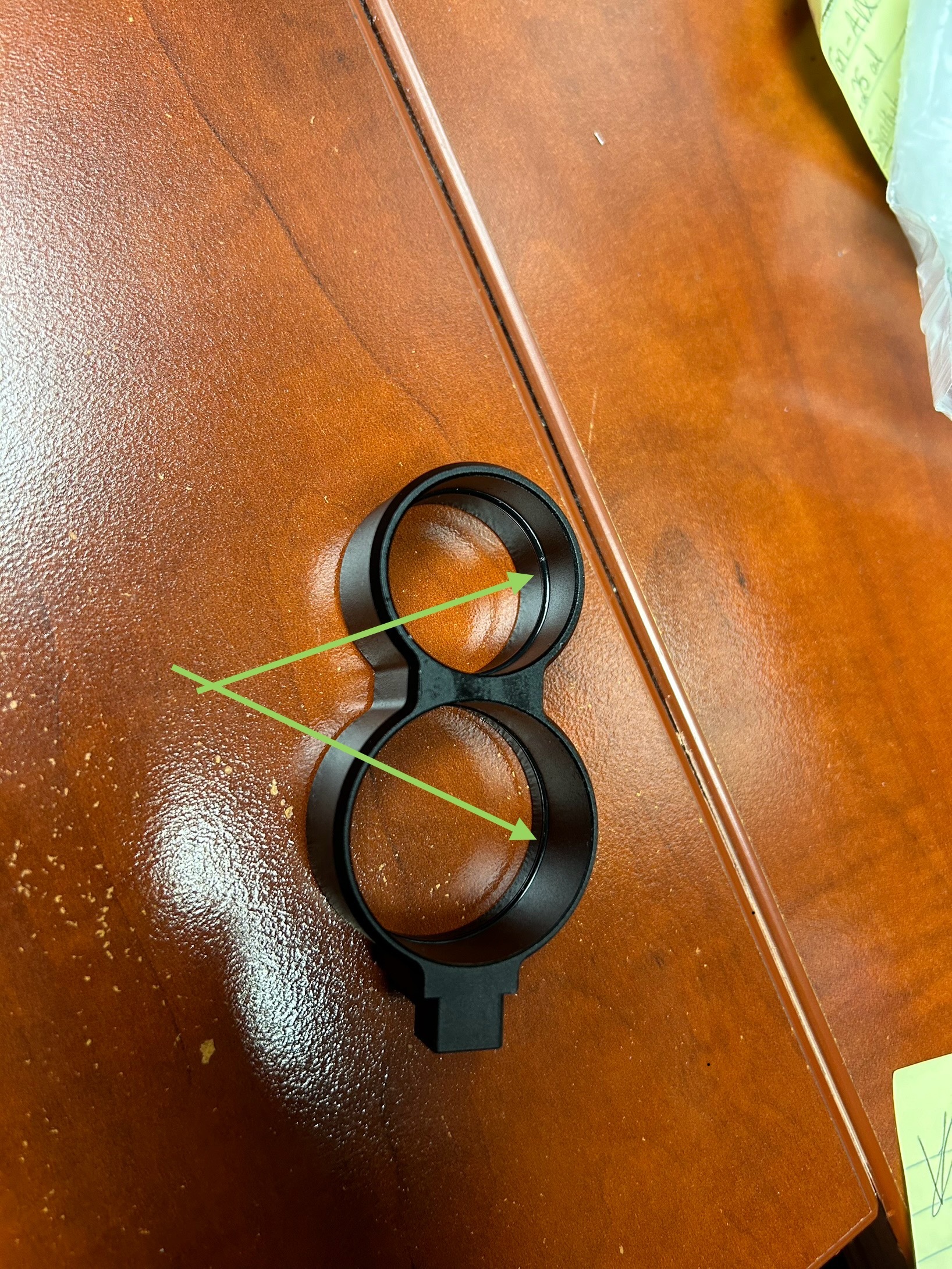

I have a wood stock average also and I was able to fix the problem because the avenger has 2 action screws. I bought a black arts barrel band and a donnyfl adapter and sanded the inside of the stock so the barrel and tube are floated. The average x wood stock only has one action screw. Will see maybe I can add and action screw if there is room around the trigger. Still thinking this out. any feedback of others having poi shift and thoughts would be helpful
I have a wood stock tube version. 25 cal and I am getting a constant poi shift left to right I will shoot a few groups no shift, go to shoot an hour later get a poi shift again and again. 25 grain fx pellets 905 feet per sec 2200 on the reg anyone else getting poi shifts. 50 yrd zero
Have you tried free floating the barrel shroud or the air cylinder or both? This can be done by removing the O-rings inside of the barrel band.
I have not tried floating the barrel by removing the oring I don't think you can float them both because there would be only one screw holding the stock on . I did get ahold of a bullpup barrel band and put that on forward helped a little
Assuming we are talking about an Avenge-X and not an Avenger, free floating is easy and has nothing to do with the stock screws.
The two o-rings in question can be removed (or just the top one if you prefer) very easily to float the cylinder and barrel assembly. Worth a try.
