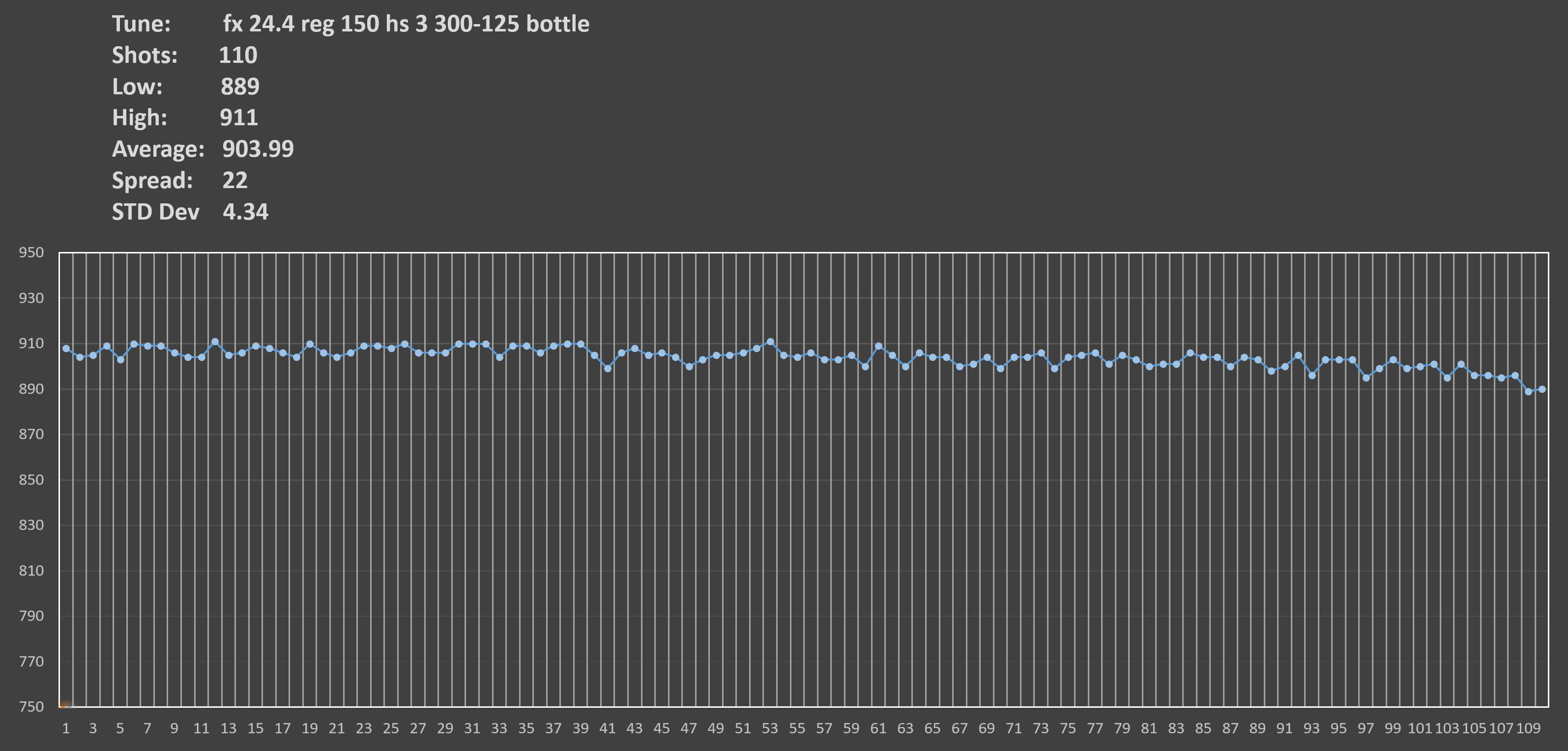

For now, I'm just not going to worry much about it until I check out the accuracy of my tune. So far I've just been checking fsp spread and std. My regulator input pressure is dropping from 150 down to 130 bar over 100 shots but does not seem to impact the fsp all that much until the bottle supply pressure gets below the regulator set point. It's too cold in Virginia right now to get out of my garage!
