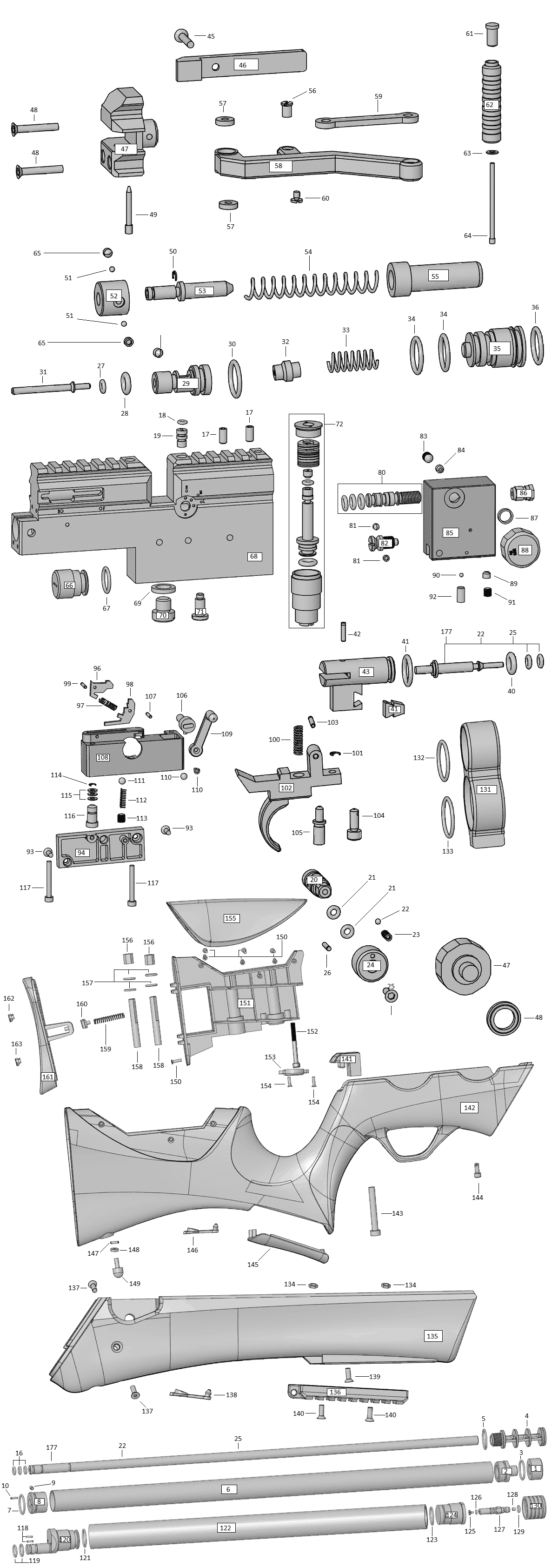

Air Venturi Avenge-X regulator o-ring size

Can you just measure the old one of the one you have ?

I don't want to replace the old one because the regulator has leaked since I received the gun so I don't know if the old one was correct.
Is it similar to the Avenger.
Different reg from the Avenger, otherwise I would just take one out of my Avenger and measure it.

It looks like 3x2mm was the winner. However, after replacing, it still leaks like crazy from the top of the front block (AS/AT/AW Connecting seat). I saw another post about the axle o-rings and, sure enough, they are toast. So I replaced them and it's still leaking. Looks like I won't be using this gun for my match Sunday, and probably not for my match next Saturday. Apparently the rebuild kits will be back in stock in a month. I'll just keep admiring my useless paper weight in it's new Saber Tactical chassis.
The small o-ring on the exposed end of the regulator is a real challenge to put back on -it did stop the leak around the regulator threads but I had to make a little tool to slide the o-ring onto the end of the regulator. The o-ring was in the kit that came with the gun.
My gun started leaking worse and worse after about 1000 rounds and I am going through it but not having much success - many of the o-rings in the gun are dried out, nearly square and break into pieces when you try to remove them.
Its leaking into the barrel at this point and I think that's the last leak - probably the poppet valve - should have just changed it when it was apart but it looked ok. Lots of the screws look like they were damaged with too small screwdrivers - I'm wondering if Theis we even a new gun at this point.
I also had it blow a burst disk at about 3800 PSI - waiting for replacements -
