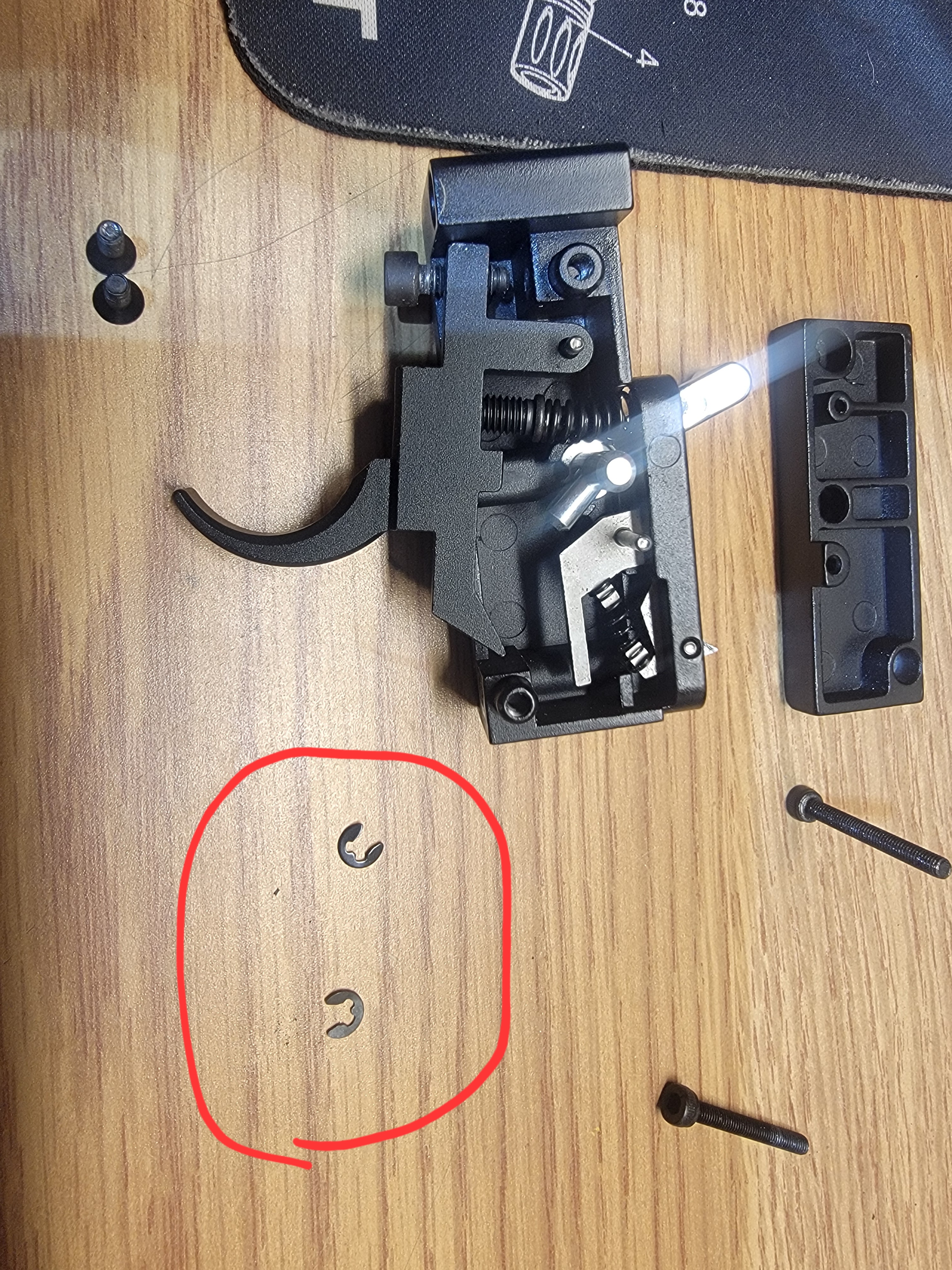

I removed my trigger on avenge x tactical. One, because of curiosity. Two, to change out the screws so I can lighten the trigger pull.
These two clips fell out from somewhere and I don't know where...
Can anyone help?
In looking thru this I do not see them addressed here though. I thought one of the trigger screws had those on it and had to be removed to swap out the screw.
Could just be retainers for the screws in there.

Those have to be the two clips that were on the the stage and sear adjustment screws. Putting longer screws in those positions; moving to a lighter trigger spring; and some judicious polishing will get you a pretty nice, near single stage trigger. Mine is something below 8 ounces and is drop/slam/slap safe. Makes a big difference in the accuracy department.

Spot on...
I backed those screws out before getting curious about opening the trigger housing. Then when I opened trigger housing, they were laying in there loose and fell out.
I watched a video on youtube about swapping grub screws. It said M4X12 screw... Not true. avenge x is defiantly different from avenger.
Do you happen to know what screw it is for the avenge X?
What exactly do I polish to lighten up trigger?
When you say polish, do you mean File??? :oops: I went a little over kill on my 1938 red ryder bb gun. I didn't shoot my eye out but I did shoot the refrigerator. It now has about a 1/4 gram trigger.

I can’t remember off hand just what they were. I know that for the sear engagement screw you can use a socket head cap screw. The sear engagement had to be a set screw. At least in the Saber tactical chassis the sear screw had to be headless. I think if you get to the avenge X schematic on the PA site, they call out those screws. I believe I got 15mm long screws.
No filing! I use a Dremel and a felt wheel with a couple of different abrasives. I use rouge for the final polish. Easy to get a mirror finish. My first pass was to change the trigger spring and just polish whatever I could get to with out completely tearing the trigger down. That got me a 12 ounce pull weight. I then decided to man up and just take the whole thing apart. Actually very easy to do and allows you to get at every contact surface on the trigger. Getting a mirror finish on everything has me under 8 ounces. My Wheeler spring gauge doesn’t register lower than 8 ounces and as soon as I pull on the gauge - bang! Off she goes and the gauge hasn’t moved off of the 8 ounce line. Also no real creep to speak of. I have a custom 22 rimfire bench gun with a B&A trigger set at 0.75 ounces so I’m really spoiled on triggers. Although not as spoiled as you with your 1/4 gram trigger. Man, a hard wind would set that baby off. But after this work the AX trigger is very good!
I also tried messing with the reset spring but that was a bust. I’m sure you could shave a little more off of the pull weight but the line between happy and sad is razor thin and is not worth the effort IMHO. I got the trigger spring out of a spring assortment package that I bought at Lowe’s a number of years back. You’ll find it in the hardware section. A whole bunch of all types and sizes of small springs In a little plastic bin.

Sorry. On the Saber Tactical chassis the stage adjustment screw can be a socket cap head screw and the sear adjust has to be a set screw.
