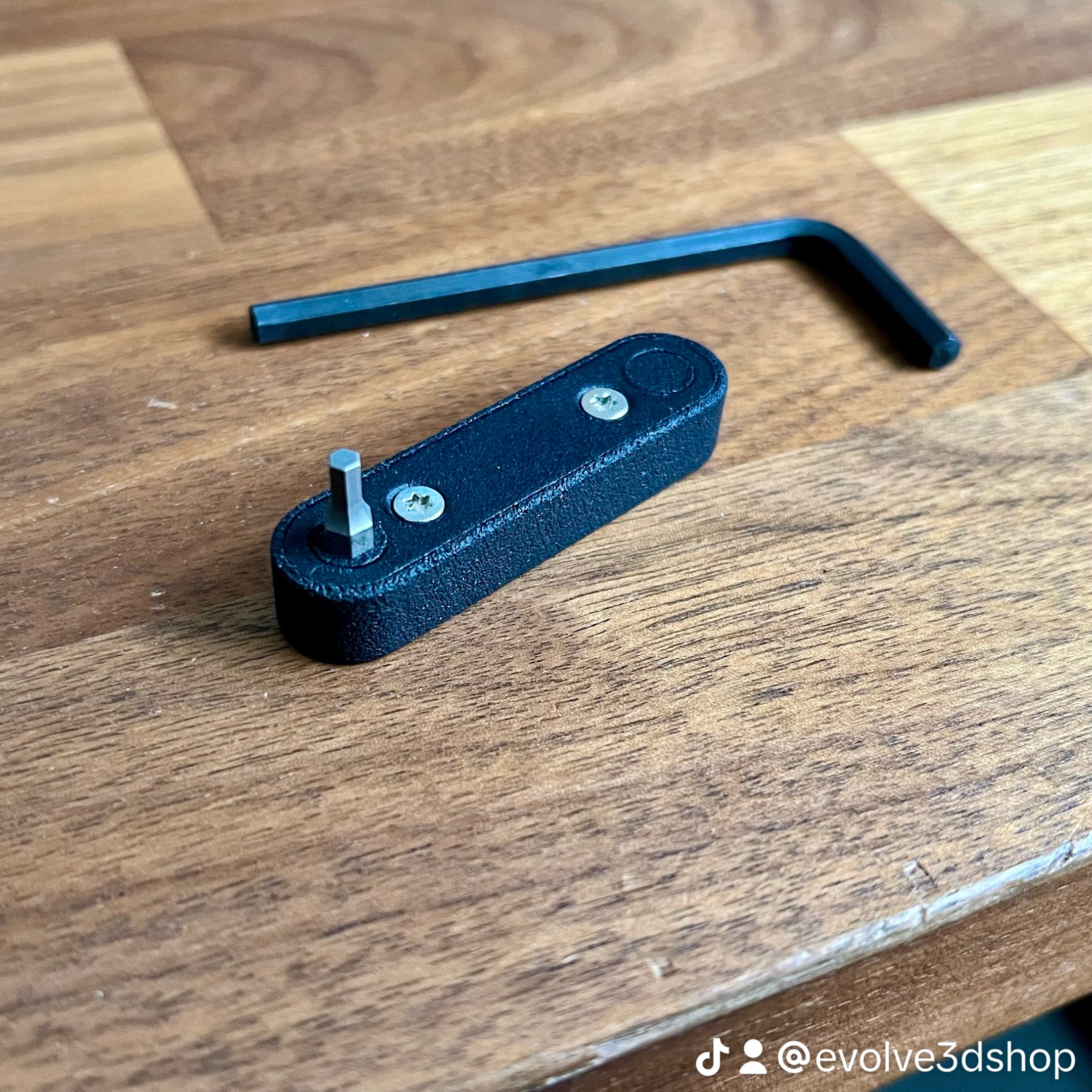

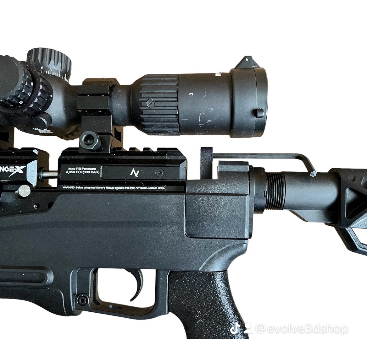

We sell adjustment tools that don’t require any stock disassembly if you are using the OEM hammer spring. It’s an offset belt driven hex tool that fits down into the rifle and allows for adjustment without removing any parts. I just got more inventory in today for them and will be listing more tomorrow.
Thanks for the reply! I have seen the tool and it looks pretty good. A straight handled hex wrench would make it easier yet. I could see an L shaped wrench hitting a scope - maybe. I‘ve pretty well convinced myself that just getting the entire buttstock off via the removal of the buffer tube would get me access to the adjustment. From what I’ve seen so far, it appears that the tuning of the hammer spring can require just minor tweaks in or out for the best results. Going in thru the hole left by the buffer tube removal would give a really clean access to the adjustment. The gun would then be just rested to get the chrony numbers and when the right place was found, button it back up and test for accuracy. Of course, no plan meets the enemy and holds together so to speak, so my plan here may not be optimal for testing. In which case, you’ll probably see an order for your tool!

Yes, the L shaped tool only allows for about a 1/4 turn at a time. It can be done like that with the right size Allen key but it is a little tedious. You can also use the approach you mention with tuning and leaving it partially disassembled during. I love the rifle, but the hammer spring access and the vertical height of the chassis are a little off putting. The saber tactical chassis addresses the bulky chassis and makes it look much nicer IMO. I’m working on a new chassis that incorporates an arca rail instead of the pic rail and also slims it down quite a bit.

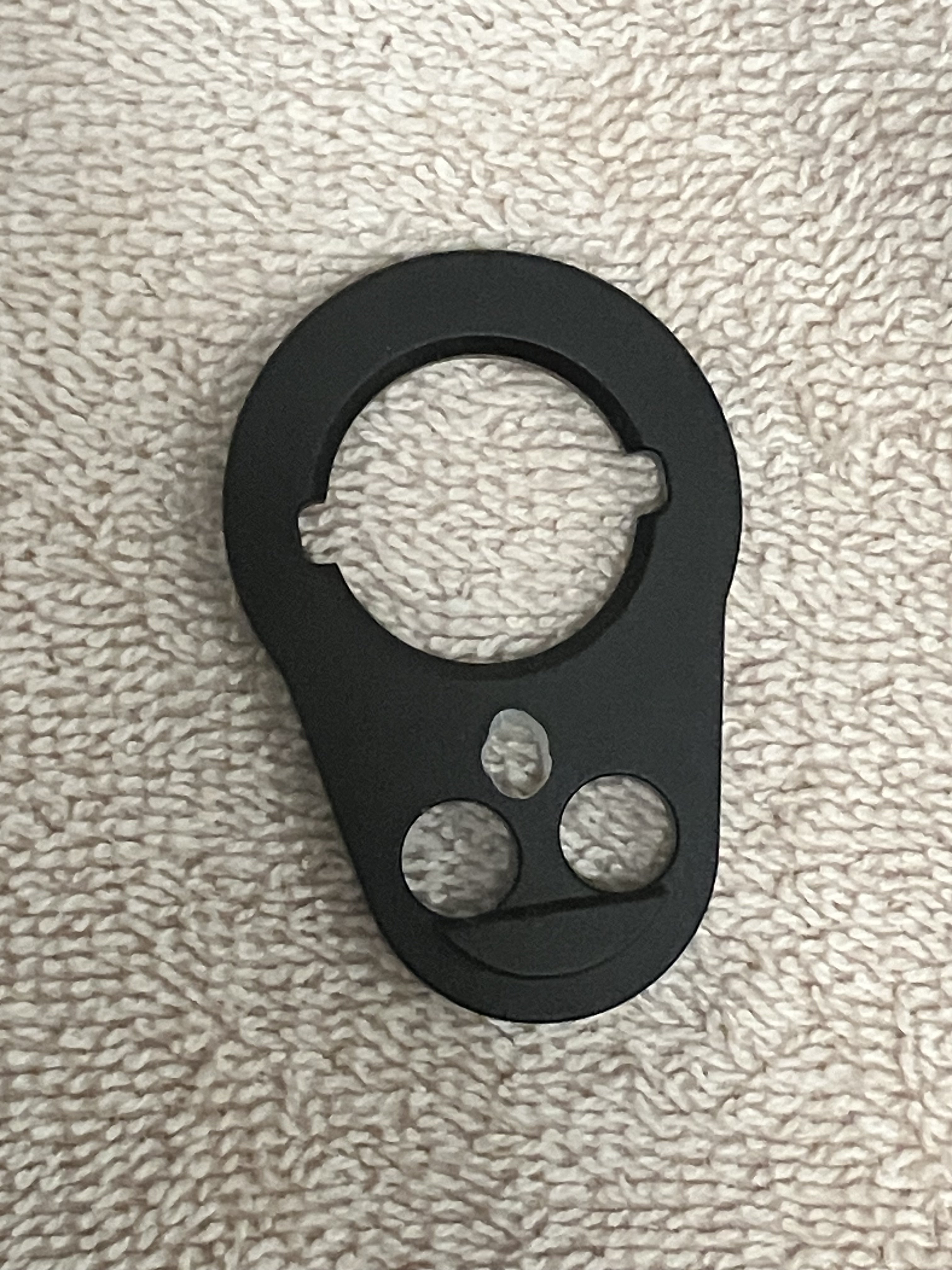

I did get the Avenge X and the Saber Tactical chassis. I use a straight tube stock. I was kind of surprised that the Saber chassis was not wide open at the stock attachment point. A quick hole thru the area allows me to get the hex key in there. I have to pull the Saber piece that files in the gap at the end of the receiver but the result is the same as yours. Run the gun without the stock and make the adjustments.

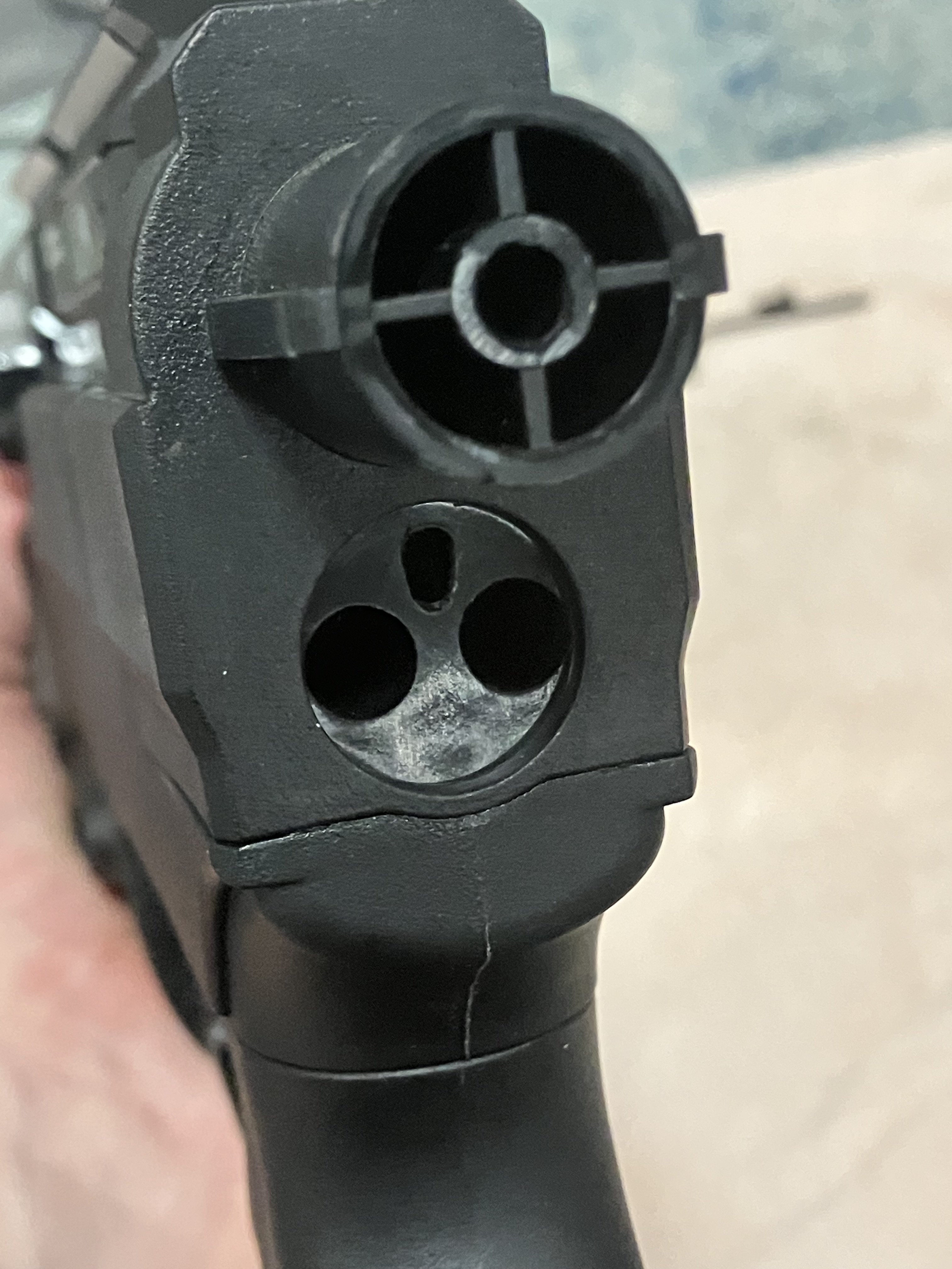

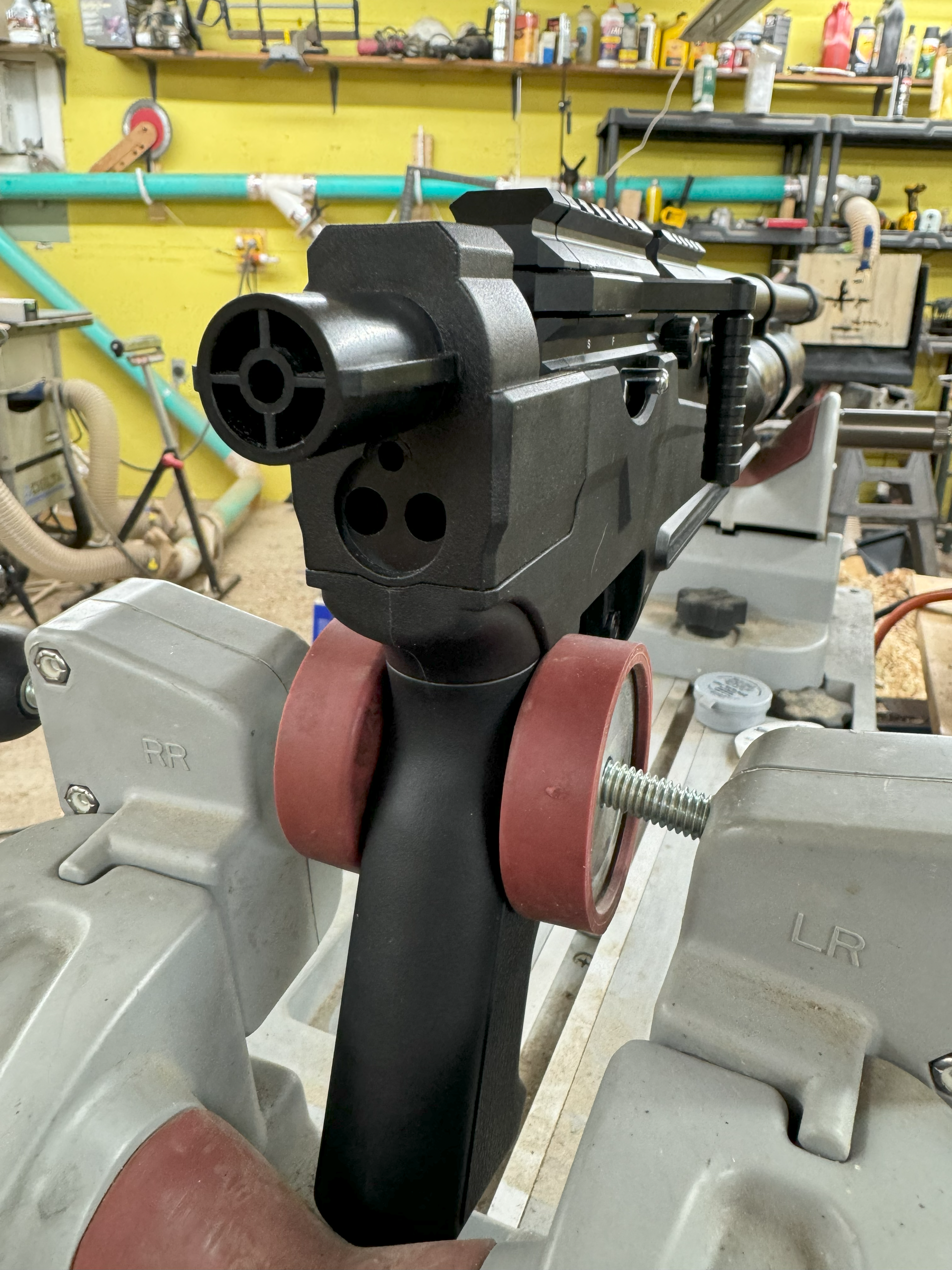

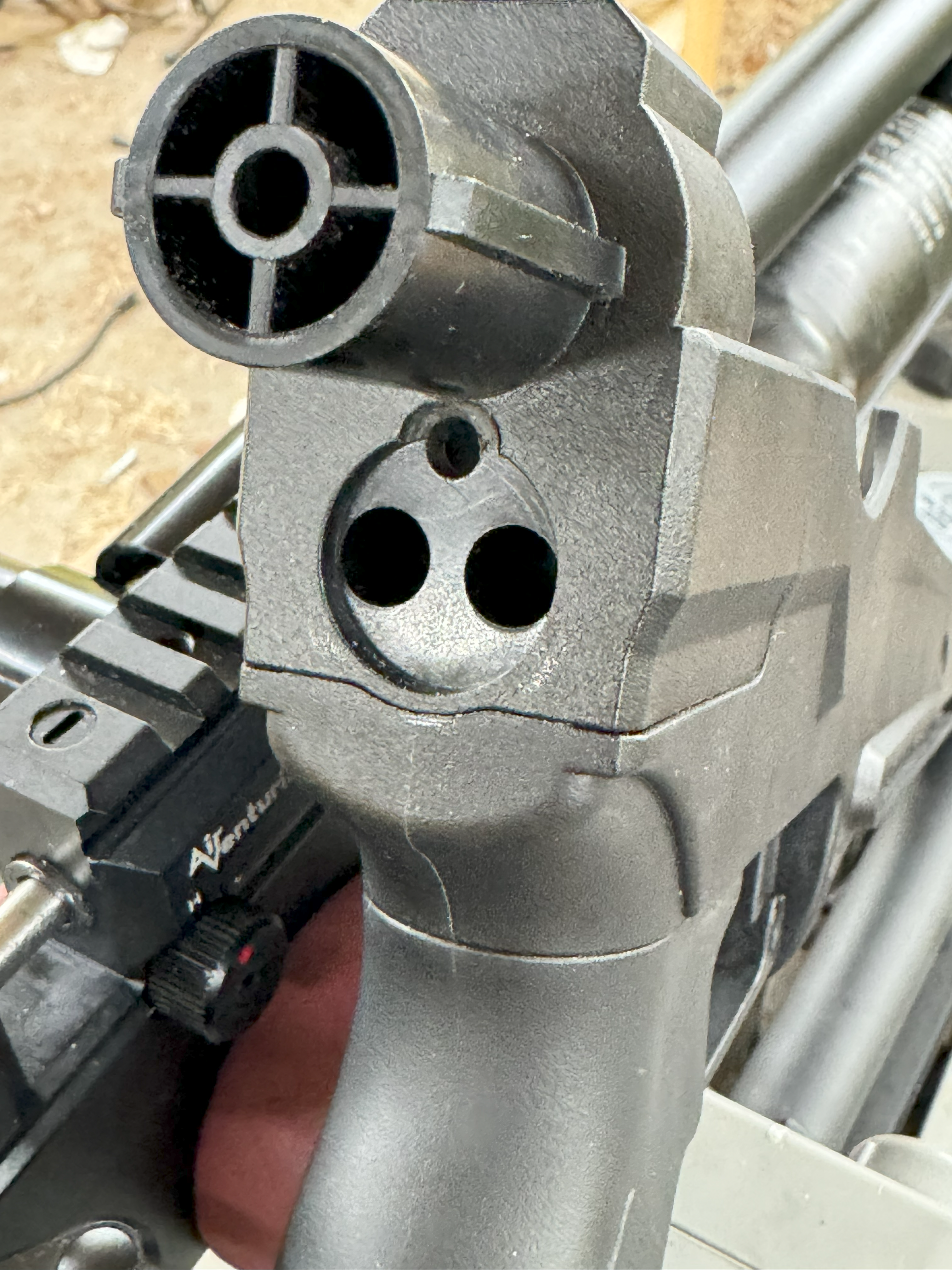

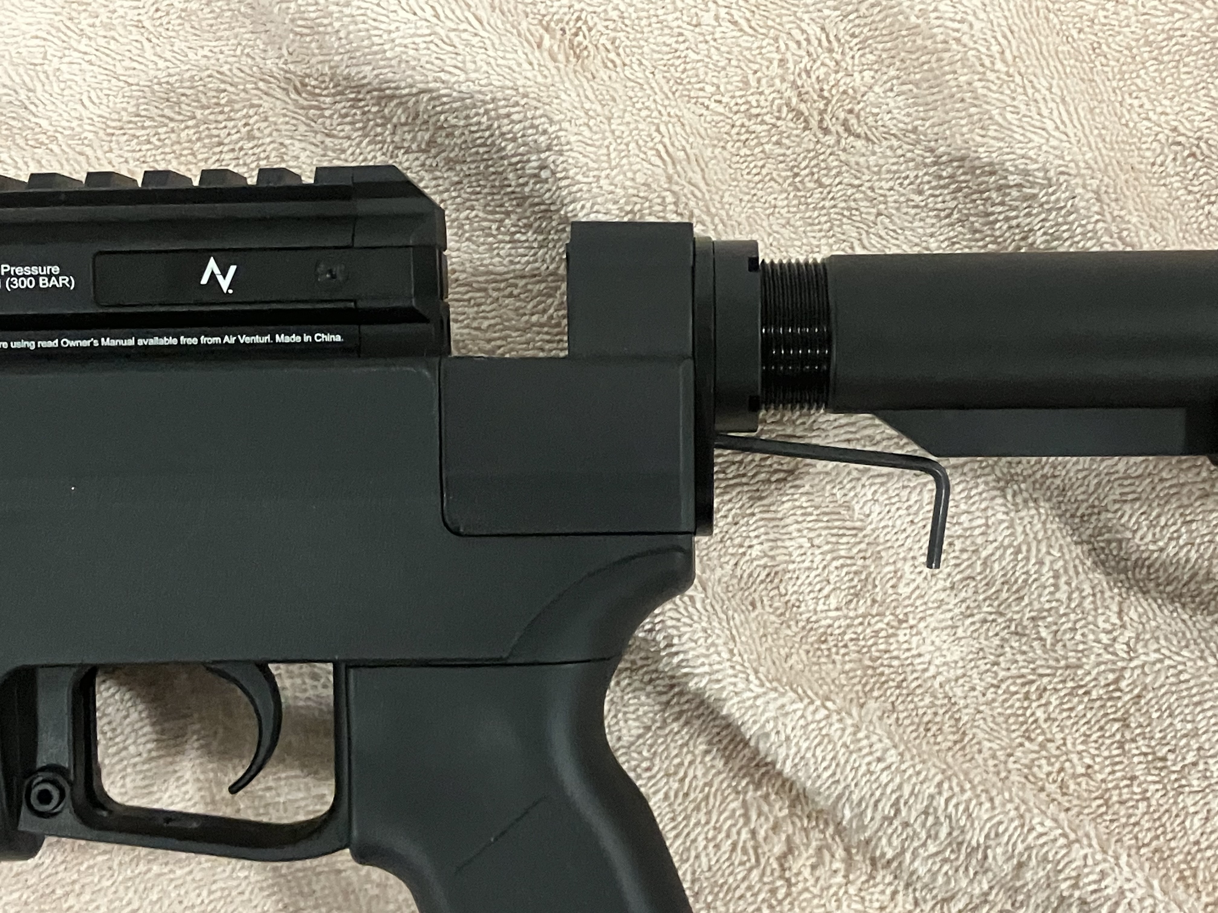

Inspired by @superduty250 post above, I took it one step further.
I drilled two slotted holes in parts #150 and #153. After drilling pilot holes, I used a 1/8” drill bit and gradually made the slot longer until I could get a ball-end Allen key to engage the screw from underneath the connecting ring.
With a standard length L shape ball-end Allen key, I can rotate the screw in 1/2 turn increments without removing the stock. With a longer one with a screwdriver handle, it could probably do full turns. Comparatively, you can only turn it in 1/6 turn increments with a stubby Allen from above

Yeah, we had issues where some of the hammer springs were too stiff and the tool was slipping. I redesigned it to be gear driven but the nylon printed gears were also cracking in some cases. I would rather discontinue the tool than potentially sell something that doesn’t work consistently. I apologize for the issues. I tried to get something to work but without being able to make a chain driven or metal gear design, I don’t think I can reliably get the torque to adjust the hammer springs on everyone’s rifles. Some of them would break away and rotate pretty easily (including mine), but I was also getting feedback saying it would start slipping.
