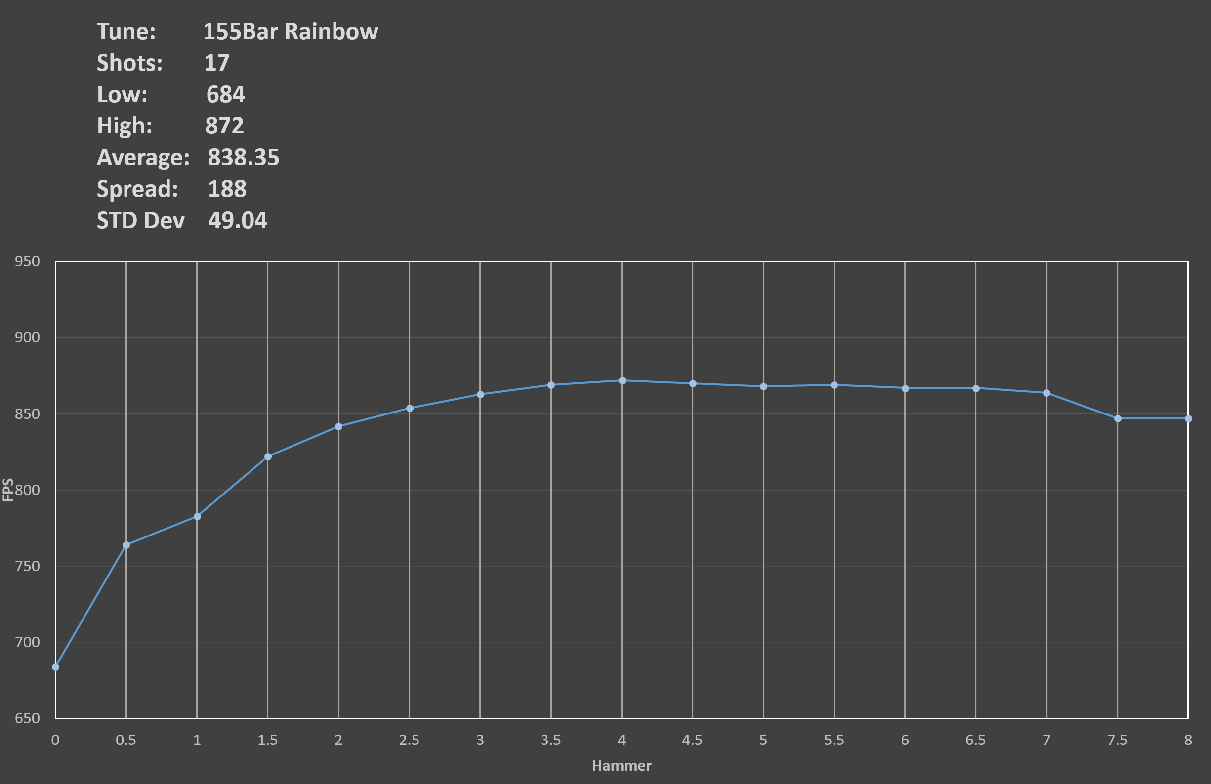

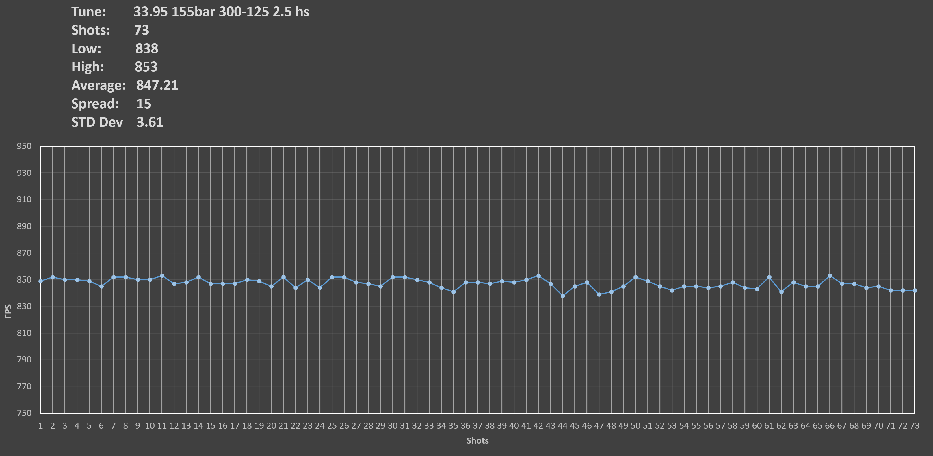

I recently purchase the Tactical .25 caliber Avenge-X Bottle version and have run through about 2000 JSB 33.96 MK2 pellets while playing around with tuning. I have been using Steve AEAC's method and have gotten some excellent results. It seems that with his process, you end up with the optimum hammer setting somewhere close to where the "plateau" begins on the rainbow. Yesterday, I saw another method that says basically to find a regulator setting that gives a plateau fps 3 to 5% above your target speed. Then back off the hammer to get your target fps. This give a hammer setting just a little more to the left of the plateau of the rainbow. I did this yesterday and it seems to be a little more efficient shots per fill but not quite the tight es/sd that I got using Steve's method. With Steve's method, I got between 50 and 60 shots before the fps started dropping off. With the 97% method I got about 75 shots before the drop off. By the way, I have an external plenum and a little heavier hammer spring.
Anyone have any advice or comments about what method works for you?
I am attaching the graph of the rainbow test and the full shot string.

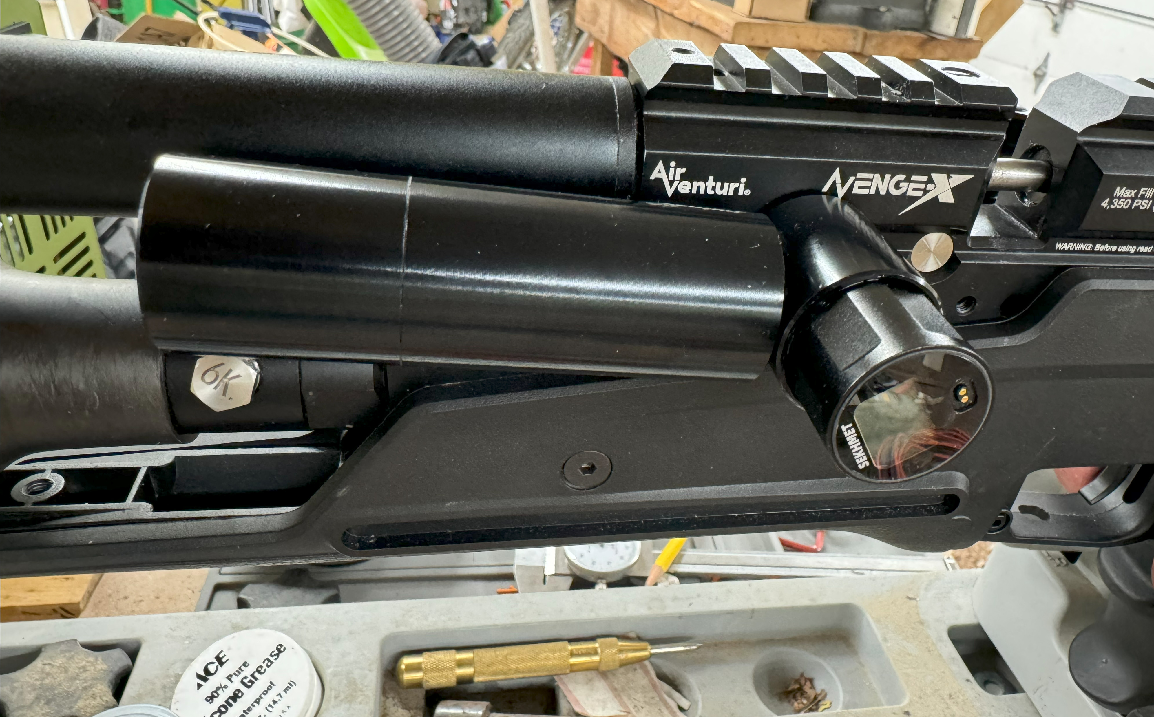

c88machining on ebay has the plenum that I purchased. I'm thinking about the .22 barrel myself but then I was watching AEAC Steve's video. He said the .25 was easier and more accurate so I have not done it yet. What tank are you using for the tethering? This is the plenum available on ebay. The gauge is placed a little differently than the one reviewed in the youtube video. I think that one is from South Africa?
