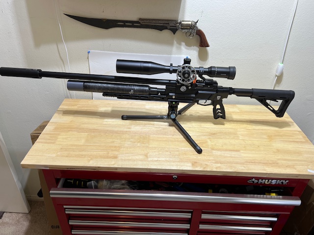

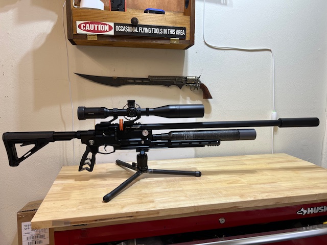

Mine has gone throughj a few changes since i bought it,
Started out as a tube version .177 tactical
Went to a .25 and it shot fantastic, So naturally I changed it to a .22 and that is the most accurate for what I do..
Once I got that all out of the way I went with the Saber Tactical Chassis, I can Not tell you how Nice it is, Worth EVERY penny.
I also swapped out the grip to a Tyrant Designs
Changed out the buttstock to an adjustable Magpul
I also swapped out the tube for the bottle, removed the barrel band and added the magnetic end cap setup
That’s an awesome looking setup!
