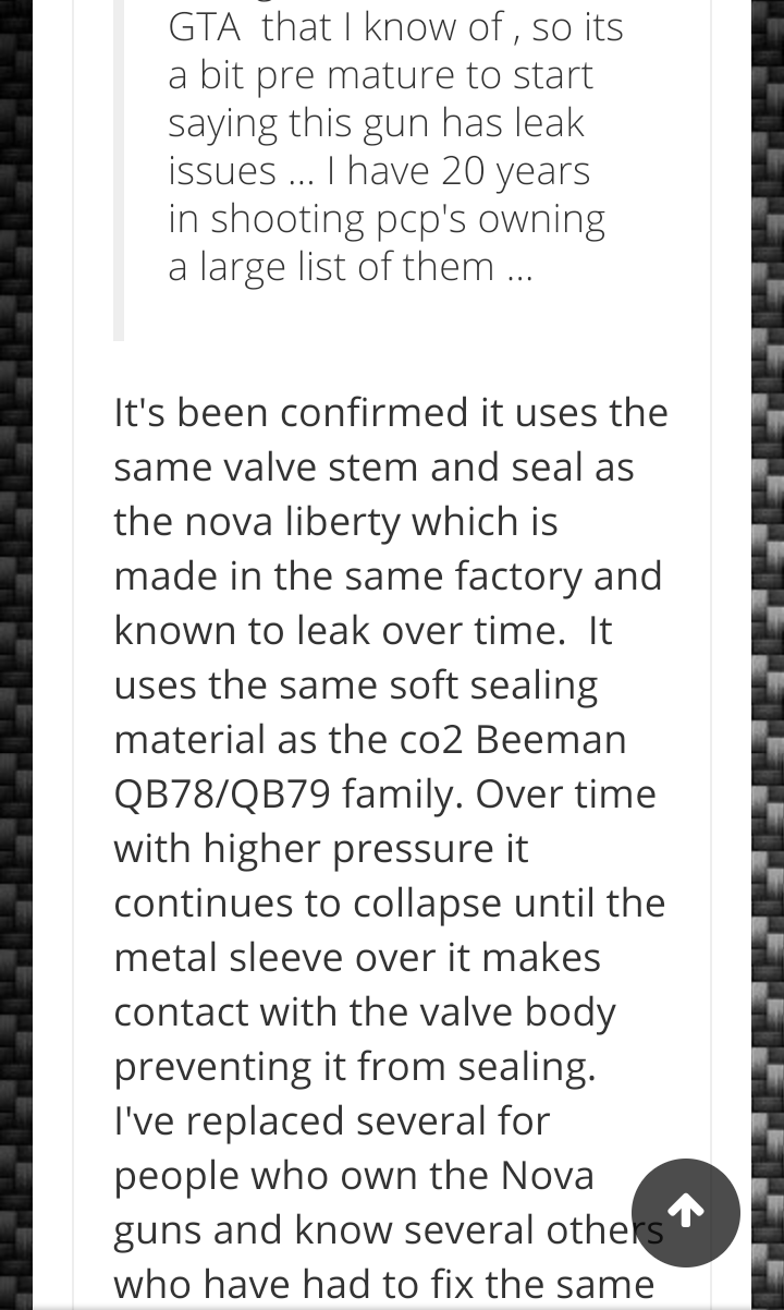

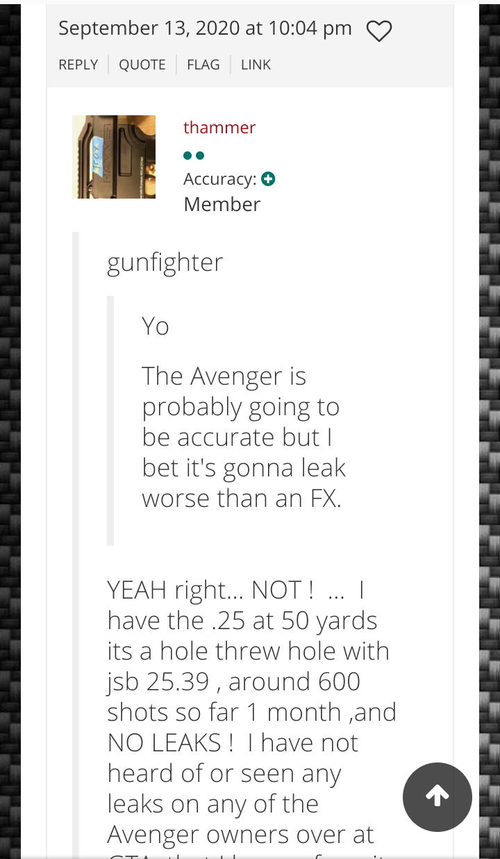

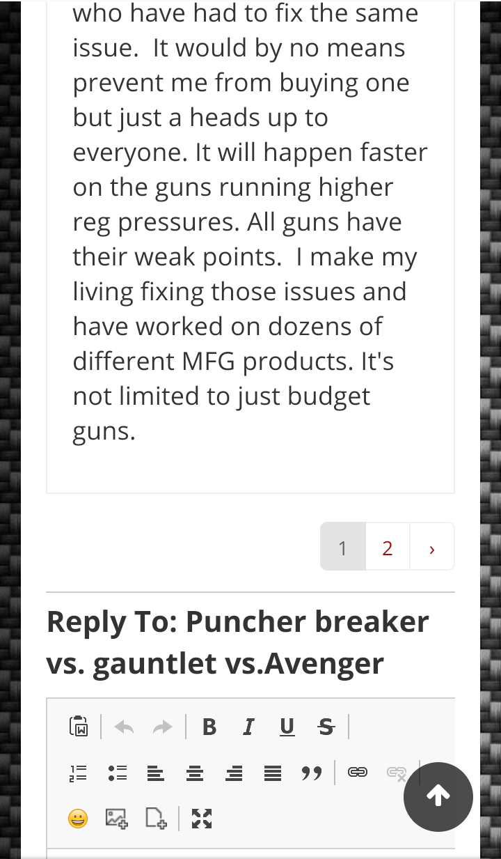

Scroll down to read what a well respected and trusted PCP tuner repair guy has to say by the name of thammer.
https://www.airgunnation.com/topic/puncher-breaker-vs-gauntlet-vs-avenger/

Don't be bummed because I am far worse off than you because I own 4 Nova Liberties and 4 Nova Freedoms (including a broken one that wasn't a $100 as-is warranty traded in broken gun sold from that ATI company) and one Seneca Aspen with the same valve seal as the Avenger Gen1.
I will absolutely not bump the power up and just shoot them as slowest speeds as accurately possible to prolong all of their valve seal life and probably lower the regs to their minimum because I don't like having to deal with broken and leaking guns and 1 out of 9 already down so far after a little over a year's use just out of warranty lucky I bought several spare duplicates of them. You see...That's life!
This is why I await a Gen2 and improved parts to upgrade all of mine because I don't like having a FINITE life expectancy nor owning any disposable airguns nor having to purposely crank their power down in order to achieve longer but still FINITE life.
