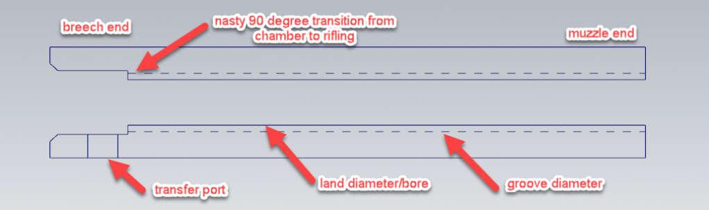

    As best I can tell, inspecting through the breech with an eye loupe, the cross section of the barrel would look like the image below.
    The ID of the barrel where the transfer port is (chamber?), is rough looking. The probe o-rings "seal" on this diameter. The transition from the chamber to the rifling is just as I have drawn it in the image, a 90 degree shoulder. It is also tight going through that shoulder.

The sharp transition in the leade can be fixed with hand tools rather easily. For the beginner, the technique I recommend is a dowel with wet/dry sandpaper, same as you mentioned, except sweeping it in and out rather than with a spinning action. Doing it by hand, you can gauge your progress as you go based on how it feels. I go into more detail in my little barrel accurizing guide if you're interested.

Looking at the parts schematic, the pellet probe o-rings should be 5.5mm OD in a free state. I don't know what the OD of the pellet probe o-ring groove is (yet). But I suspect the area I keep referring to as the chamber is not as oversized as I think it looks. I need to take it apart again, and get an accurate measurement before I can make a decision on how to proceed with the leade.
