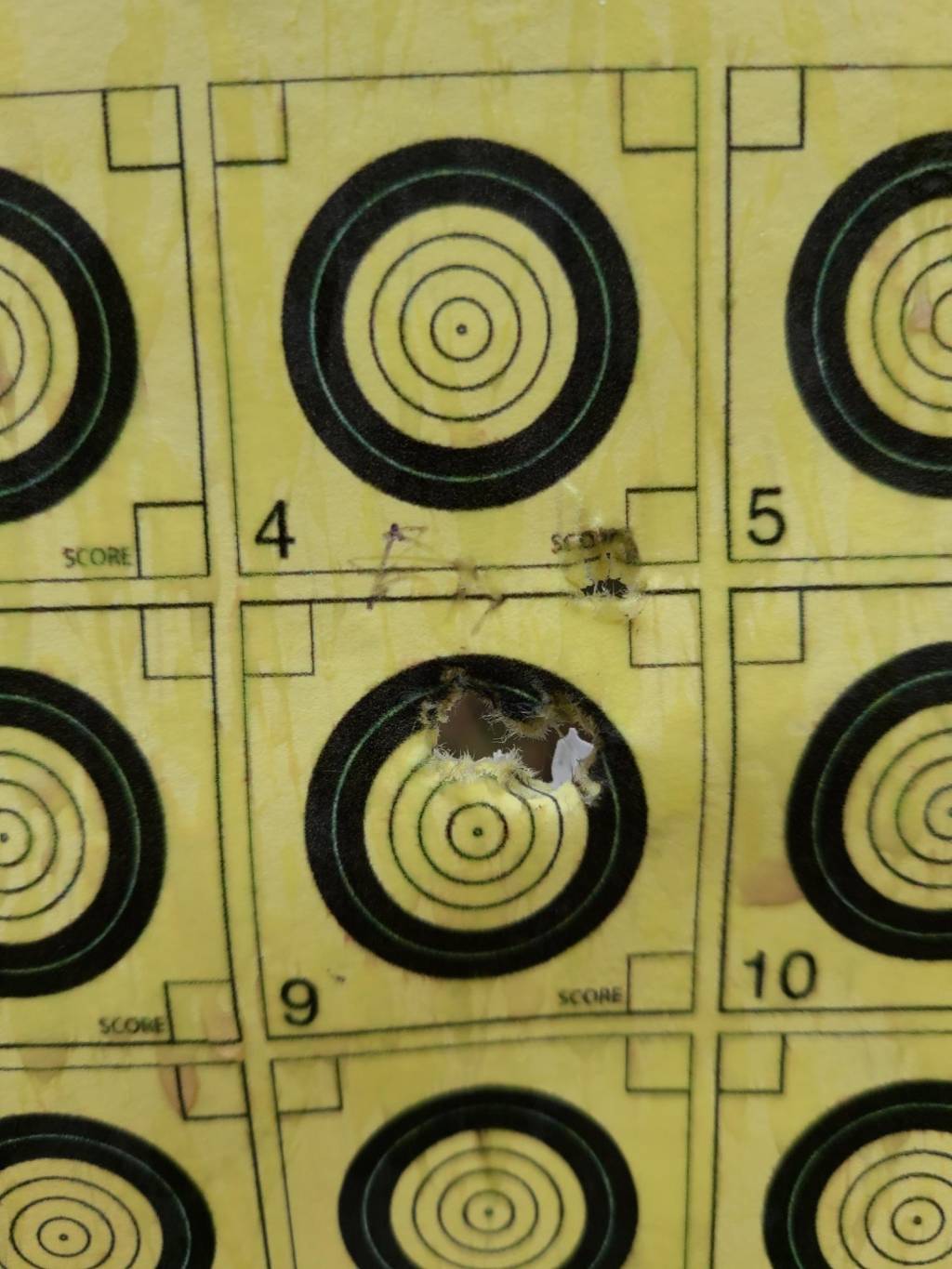

Then I shot about 5 shots to zero the Air Arms Fields and shot a group. About .35", one ragged hole. This is more like it.

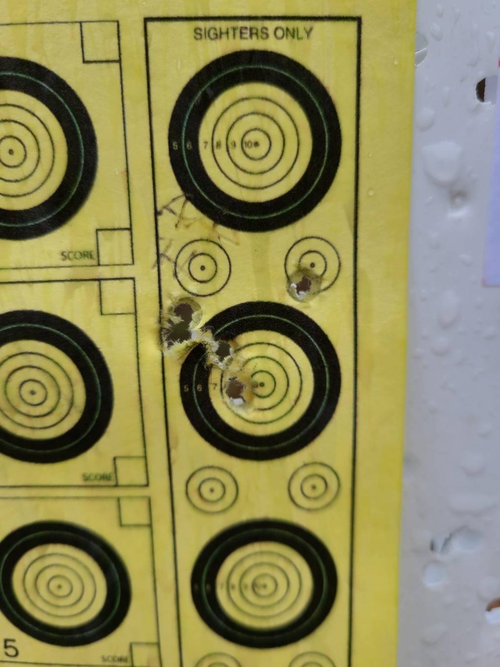

More pumping (yay), zeroed the Air Arms Heavies and shot a 5 shot group. About .49" with a flyer, fairly strung out but everything was touching.

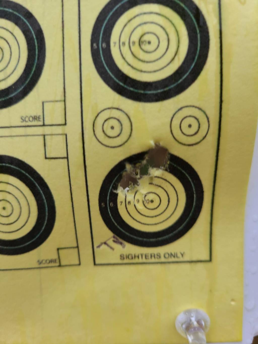

Then shot another 5 shot group with the FTTs. A very tight one hole .25" group with a flyer.

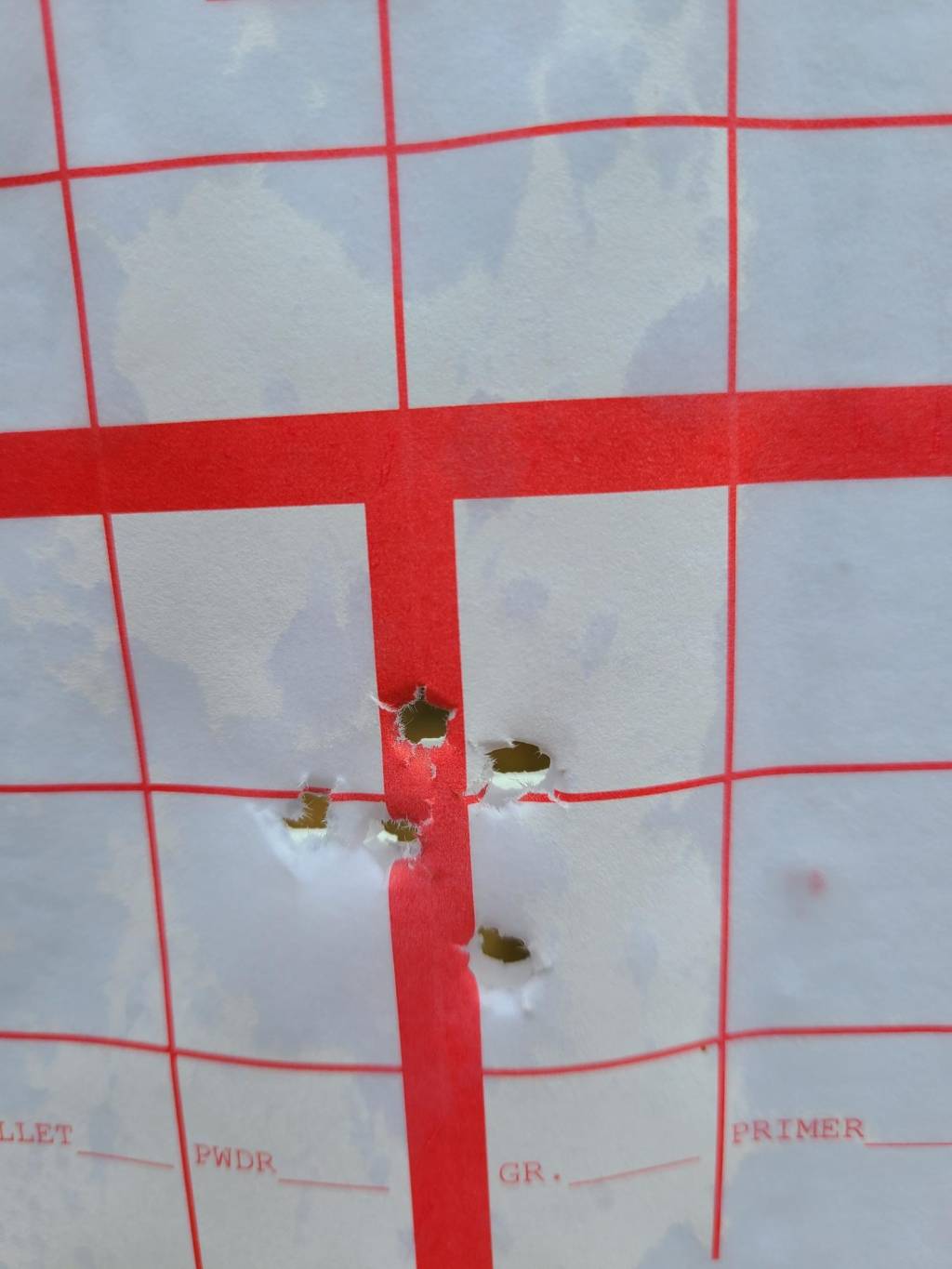

I think there's enough air in the gun for 5 more shots, so I went to the 50 yard range. Shot the 16 gr Air Arms and shot a very tidy 3 shot group at .40", and then 2 more shots (on the right side) that I could tell were off the reg. Decided to take my frozen fingers and wet feet home.

Air Arms Field 16 gr 25yd
H&N FTT 14.6 gr (flyer top right) 25yd
Air Arms Heavy 18 gr (Strung out, flyer top right) 25yd
Air Arms 16gr at 50 yds (two shots on the right were off the regulator)
